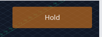

  1. What happens when you manually hold in the console (! in console to hold, ~ to unhold)?

  1. What happens when you type “!” in the console? Does the firmware properly enter a hold state? Ultimately this is what the pause button does.

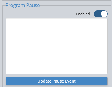

  1. Do you have a pause event enabled? You can look in Preferences → Program Events and see if the Pause block has code in it. If there is, disable it and try to see if your behaviour is different.

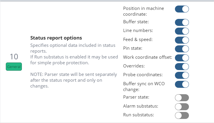

  2. What is the value of your $10 eeprom? You can type $10 in the console to have it report it back or share a screenshot of your firmware tool with the currently set toggles of $10.

Typing “i” gives me a hold after a short delay. I retested the pause function and it works after 8 seconds which I can live with though not sure why it takes so much longer than old board and grbl.

My Eprom 10 is setup exactly as you show.

So you do have a pause event enabled? You need to disable it (not remove the code itself, use the toggle) if you want the program to stop immediately. I’ve explained why in another post but the short is with a pause event, we stop sending gcode but don’t hold until the event runs because otherwise there would be no way to send the pause event itself.
This is probably more noticeable on SLB due to the increased buffer size and is likely a feature we’ll have to revisit to see if it’s worth keeping.
Thanks Kevin what you say makes sense, I will disable and see what happens
Kevin, disabled pause event and pressing the pause button now results in immediate stop of program. Thanks for your help.
