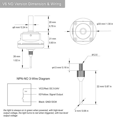

Anybody with an Altmill tried this probe yet?
PGFun probe
It comes with a USB cable …. does that plug into the SLB’s probe port or do I need to make up some special cable? If I have to I can run the probing by hand if none of the Altmill probing routines work.
Never mind the bit about the USB c cable - turns out the probe has a USB-C port so there are only bare wires to connect this thing up.
This was/is new to me but I was looking at that probe just a month or so ago when there was another thread about probes. There are NPN-NC and NPN-NO versions. I’m pretty sure you linked the correct one.
I found an interesting thread on Inventables where @NeilFerreri explains how NPN circuits work and how to wire them. He’d be the guy to ask about this IMHO. If I remember correctly he mentioned that he teaches this stuff.
Take this with a grain of salt but I think the probing routines would work because the board is just looking for High vs Low voltage. I don’t think it matters what is triggering the change.
EDIT:
Now I remember it was the bit at the bottom about when the light is green and red and the voltage for that seemed backwards to me. That’s because I didn’t/don’t understand how the circuit works. I have the regular square block and it’s obvious that the circuit is closed when contact is made. My thinking was that the voltage must be low and then turns high when the circuit is closed. That assumption is false if I understand anything from the thread I linked. Pretty sure Neil said the pins voltage is held High by a pull up resistor and goes low when closed, not that I understand how a pull up resistor works. Then it makes sense that the light is green when High and red when Low.

i have that probe too, i fried a board with it, basically the probe switched between ground and signal. if not sure just use a relay in between
also, the probe pin is 2mm, but you have to set it to 1,9mm , reason is the it moves when it switches
hope it makes sense

Minor hickup …the PGFun probe has three wires (power, ground, signal). I was hoping that I could just use signal and ground if there are mechanical contacts in the probe but that doesn’t work. I was hoping power was only needed for the probe lights. Well, it would seem that the magic in the probe is transistor based and needs power.
Question to Altmill owners - where do you grab power from the Altmill controller? Suggestion to Sienci - make the probe connector a three terminal connector or provide a power output connection for those accessories requiring power.

I also found out that the ‘TLS’ connector is paralleled with the probe connector but adds a 5V pin so that is what I will use for my probe. I just got to find me a connector. Yes, Digikey has them but shipping costs for a tiny connector are a bit steep. I am currently trying alternate sources.

As far as the probe is concerned, it appears to be excellent quality but there are a couple of negative points. The shaft on the probe is 6 mm but the collet I am using is 6.35 mm. Now one would think that this is well within the clamping range and it might be (it does clamp) but there was some eccentricity evident when I was turning the probe. The probe is apparently adjustable to remove any eccentricity in it’s build (I have not tried that yet) but at this point I do not know if the issue is the probe or the collet. Adjusting the probe will not help if the fault is in the collet. It might be advisable to get a (high quality) 6 mm collet. The eccentricity is very small but I have not yet measured it. It’s not significant for what I am currently doing with the probe.
The other thing is the fact that one needs to also purchase a connector - 3 pin, 3.81 mm pitch if one wants to connect this probe to an Altmill (don’t know about the other mills from Sience). I have currently cobbled up something that I dare not look at lest I upchuck at the sight of it but I am not buying 20 connectors from Amazon nor am I buying a $1.50 (or so) connector from Digikey and pay probably $15 (guess) freight to get it here. It’s put on the list for the day when I can place a large enough order and freight is free.
