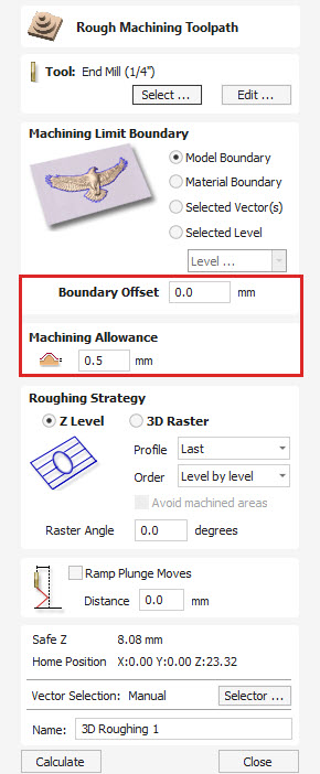

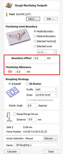

Hey @Donpagel,
There are a couple settings in Vcarve Pro that can change your roughing/finishing pass depths. This example is looking at a roughing pass…
A Boundary Offset is used in 3D toolpaths, such as the 3D Finish toolpath, to ensure a clean final cut by extending the tool’s cutting path beyond the boundary vector. This offset compensates for the tool’s radius, forcing it to travel slightly past the edge to remove any “flash” or residual material left by the bit’s center cutting on the boundary. The value for the boundary offset should be equal to the radius of your largest bit.
A Machining Allowance (or allowance offset) is a setting within toolpaths that leaves a virtual amount of material on the part for a finishing pass, ensuring a clean, final cut. It can be a positive value (leaving more material, creating a snugger fit) or a negative value (removing more material, resulting in a looser fit or a final cleanup pass). This feature is crucial for precise fits in joints, inlays, and prototypes, and for achieving a smoother finish on 3D models.
You may want to play with these values a bit to see if they help find that perfect fit/finish.
Cheers,
Stephen
