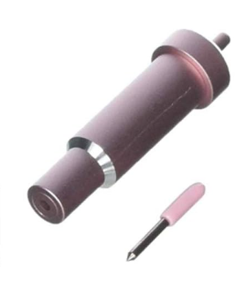

FWIW, once I get my Altmill, I will try to adapt a Cricut or Cricut-clone knife. The clones are relatively cheap and the Cricut brand is currently on sale (at Michaels). The blades are tiny and rotate in the housing so they don’t need to be attached to the spindle collet.

There is also a drag-knife similar to the Cricut sold by Carbide 3D but it’s way more expensive if you factor in shipping to Canada.

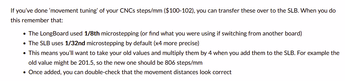

On precision on the altmill, there might or might not be a direct spec, but I found a hint in the upgradfing to SLB section that might give you an idea on how precise an altmill - At least - can be, when it’s perfectly calibrated.
I know, there’s no such thing as no slop in our kind of machines, but even my clunkmill - Not calibrated and I don’t care much for a wee deflection - will stay below your lowest estimate.
I think you will end withing 0,05mm from where you start in your circle with a well calibrated and oiled up altmill.

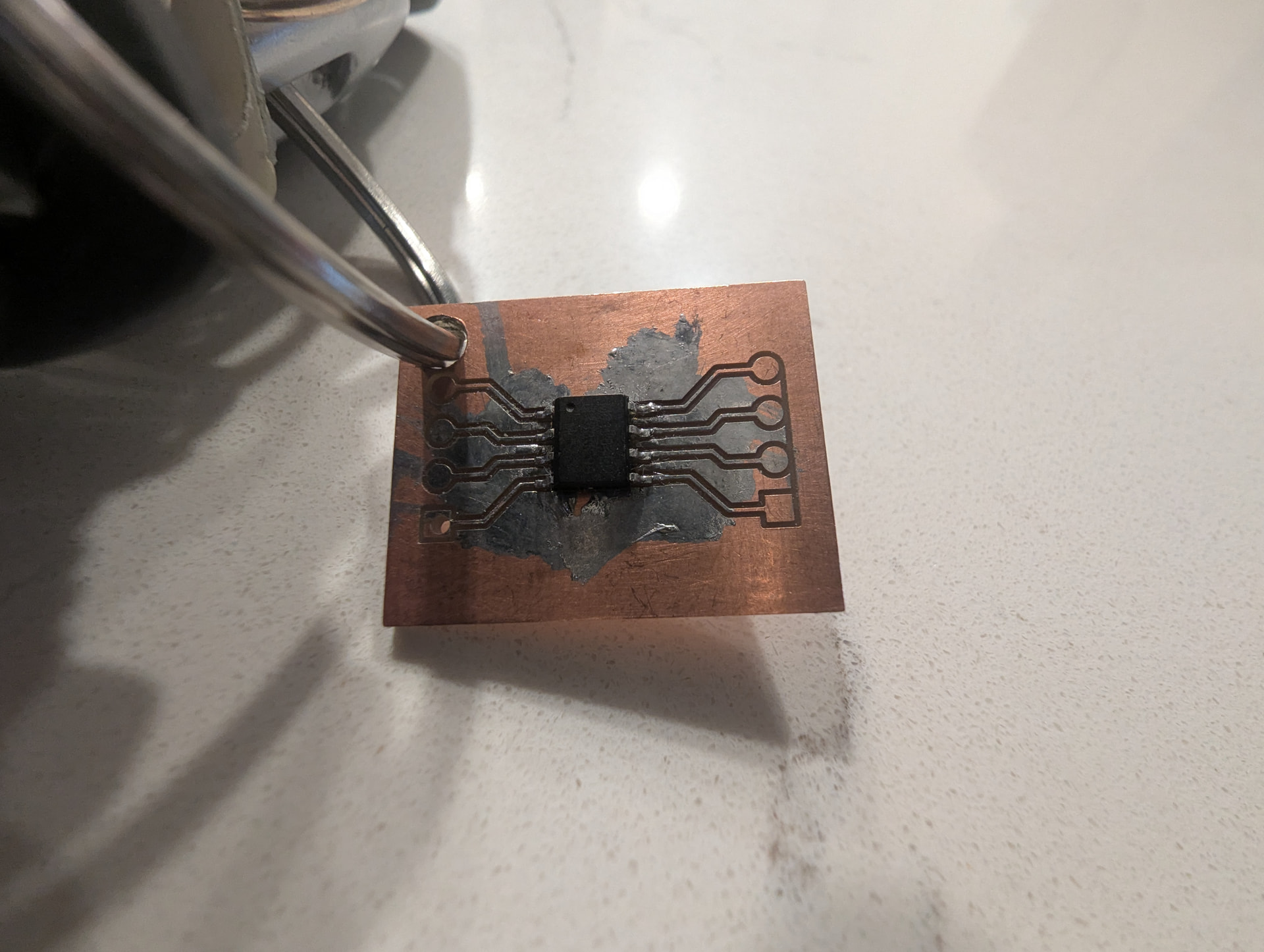

Thanks for checking this out. I recently purchased an MR-1 probe to do some touch leveling for PCB milling. The results are really encouraging. I don’t have an accurate enough dial indicator to check my machine at that level.
Sounds like our machines are going to be quite good at PCB milling. My initial results were good but I think I need the surface leveling for better results.
