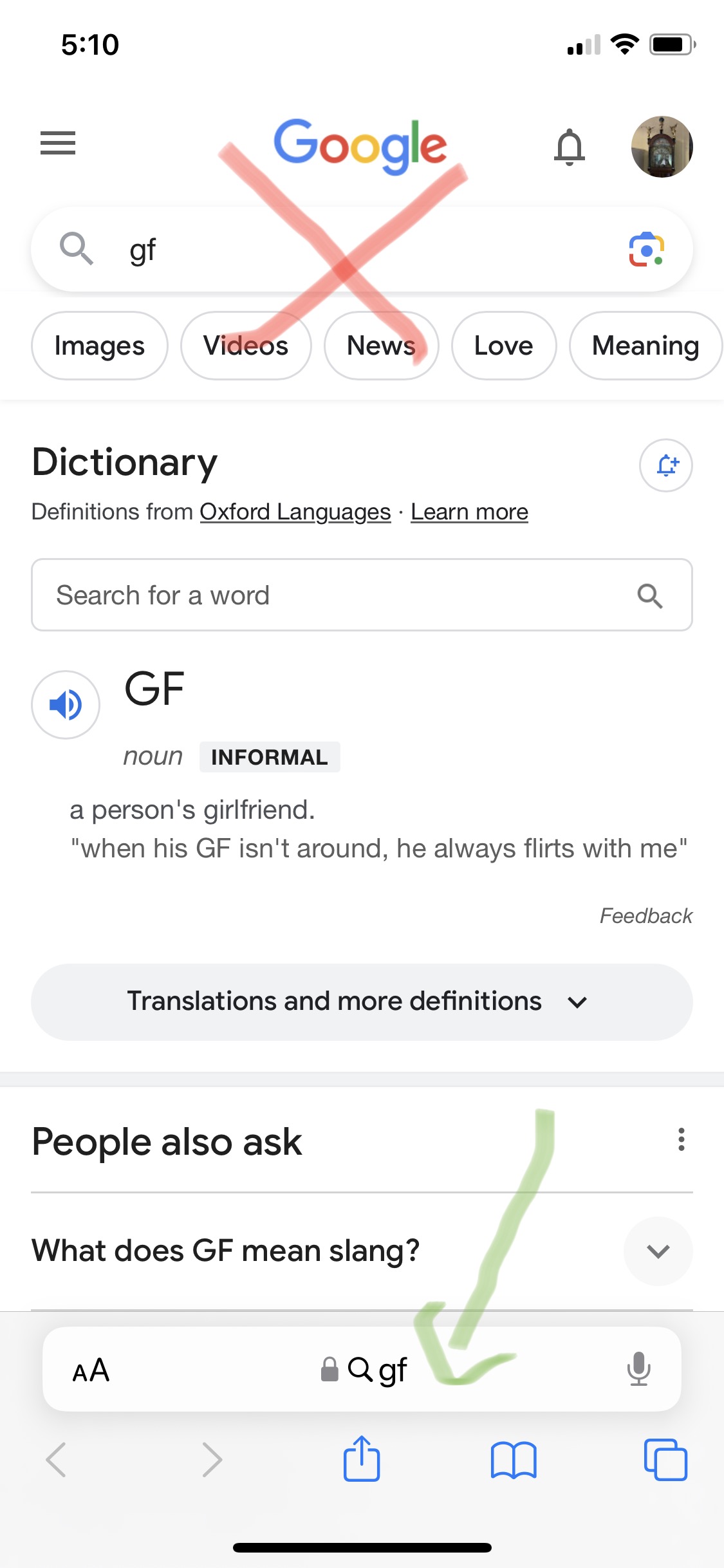

Make sure you are entering the address in the correct place. On the iPhone, use the bottom entry point for tying in, not the top.
Thanks for the feedback. I have finally solved the problem. My old iPhone7 can now control the gSender on my CNC computer remotely, and its GREAT!! For anyone else who may be having troubles connecting, the remote works even if you are running a VPN and also totalAV antivirus software. My problem turned out to be a WiFi setting, I had to set my connection to local private wifi and not public. I should have thought of this sooner but at least i got there in the end.
