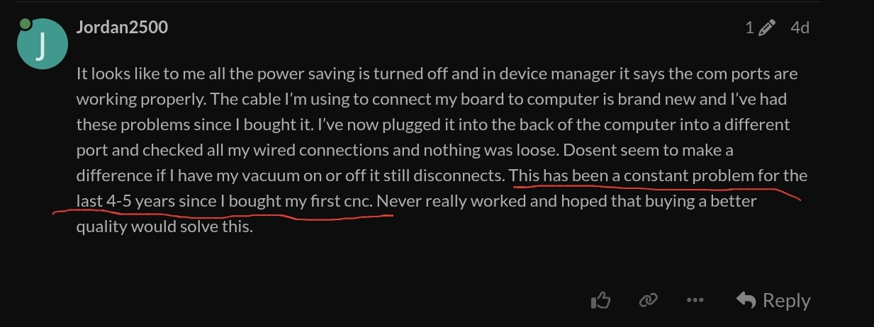

I having this same problem I have changed the cable and computer, and software but still having the problem get half way though a job and it disconnects. really need a fix

I really havent done anything different. I just finished running 15 conversion boards with no problems. They wouldnt long runs, just 5 different runs. Maybe thats it, I have in the passed ran longer jobs with no problems. Just wondering if the controller is going bad?

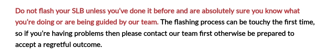

Has anybody had any luck flashing their board , I’m hesitant to do it. One new problem that has occurred is that I when I do my probe connectivity test it does
not connect. When I open up gsender it automatically connects to com 5 instead of com3 like in the past before the new slb. And the workspace is zoomed way out

You have two slb, they both don’t work. You say you have had these problems for at least 4 to 5 years.
The first slb is how old now? 2 years?
It sounds like your problem is not the controllers. Why try something sienci warns not to do without at least some knowledge on what you are doing or to do it under sienci supervision.
Are you willen to accept a regretful outcome. Do you realise what that means?
It might be wise to not risk voiding warranty on something that is unlikely to be the problem.
If the problem you have is a constant over different cnc machines and different controlers the question to ask is, what is the factor that does not change?
I do not know the answer to that question, but I don’t think it’s the latest controler.
I had a openbuilds lead 1010 that I purchased used from someone and it never really worked properly, disconnect all the time or didn’t cut the project close at all. Then I bought the beginners package longmill and have used now 2 slb and still have the connectivity issues. I’m not gonna flash it I’ll just wait to hear back from customer support. Did anyone have a chance to look through the file I uploaded ? Like I said I’ve used 3 different computers and haven’t had any luck
