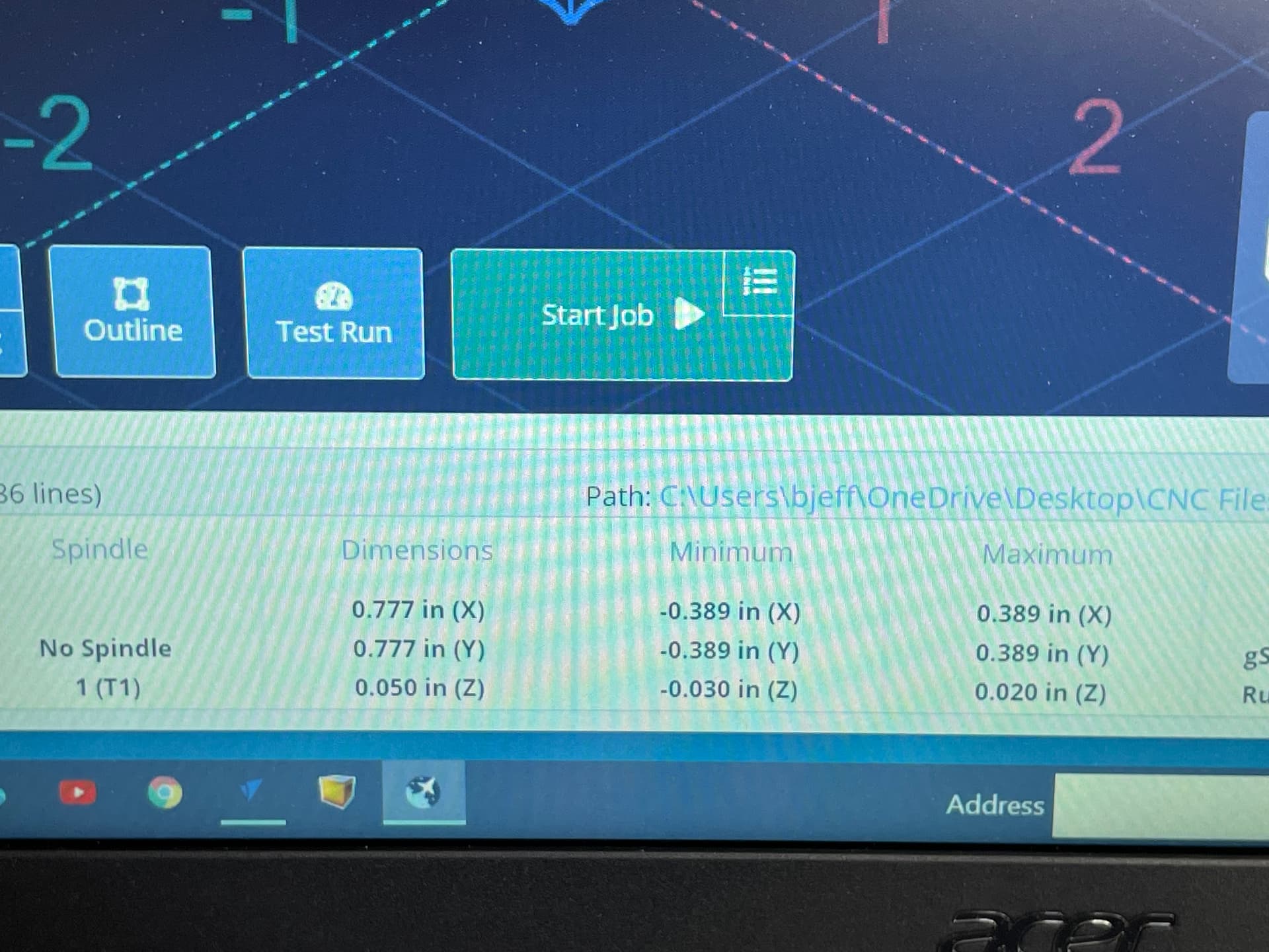

1 week into using my long Mill 30 30. Created a file in v carve in inches, post processor in inches send it to g sender and it show in visualizer as postage size. Have settings in g sender in inches. Not sure if there is another setting I should be looking at, at but it runs fine on ugs but really would like to use g sender as I like it better. Sorry if this has been answered before but my search showed nothing. Thanks love the mill ,the company and hopefully g sender soon. :grinning:

@Bjeff Barry: What are you using as your post processor in VCarve? I looked at your .tap/gcode file and the starting comment line is new to me. (No big deal there.) You should be using grbl in since you created your file in inches. The output gcode file will be a .gcode file, not a .tap file.
hi have attached some picture of the post processor and pictures of the files I’m using. hope this helps solve my problem thanks again barry
ok, so your using the wrong post processor.

change to the GRBL post processor and try it.

Thank you soooo much it’s working now with the right processor. It’s so great to have this resource available to us newbies :grin:
