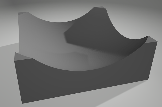

I haven’t tried to mill this, but a little work on paper leads me to believe that this could be done as a v-carve inlay in Vectric as long as the lettering doesn’t go too far down the sides. The lower the angle on the V-bit, the farther you should be able to go down the sides.
The setup would be the same as a normal v-carve inlay just projected onto the surface of the dome. I would like to test this actually, to see if my paper drawing holds up, just need to find some thicker stock to try it with.

I started with these two models that I made in OpenSCAD.
And then I used Vectric Desktop to do a regular v-carve inlay only projected onto the models.
For v-carve inlays I follow this guide.

Michael, I started laying this out but I’m not sure how to lay out text on a concave surface. I looked for some youtube vids but didn’t really find anything. Can you point me in the right direction. I see you used SCAD program, not sure what that is, would it be required to do it or can it be all done in vcarve?
The dome could be made in any program that can make it. The project onto 3d model is located at the bottom of the toolpaths tab.
You can see the 3D model in the 2D view just place the text where it should be and that checkbox will do the magic.
I did project it on the dome with no problem but I’m not understanding projecting it on a concave surface. I am able to v carve them into the concave but not get them to stand proud. I would need to make them proud of the hollow. I would have the bigger carved area then I would need a pass to cut out the letters Using the same bit as the pocket. That’s where I am struggling.
You need to flip the text left to right so that it is backwards and to have a shape around the letters. With the shape around the letters it will v-carve between the letters and the outside vector. I used the modeling tool ‘Create vector boundary’ on the 3D model to get the outside vector.
Do I also invert the dome? so it is all a mirror image?
If you already have the dome as concave you should be all set.
Maybe it depends on if the dome is symmetrical. If it not symmetrical then you may need to flip it. Like if it was an egg with the pointier end on the right for convex then the pointier end would need to be on the left for the concave so when you turn it over it all lines up.
