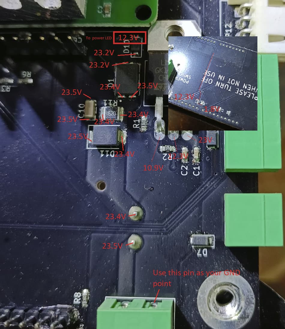

I have an LB and always have been looking for an excu.. moment to open it.. clean it out. You have provided me with that and so I thank you. Since I have it open I might as well take the time to provide you with some KGB data and measurements.
I too can’t figure out how to find the LB schematics in a usefull way and if some siencitist reads this, can you please provide some hints into howto obtain them. The zipfile provided doesn’t seem to contain them or it’s beyond me to find them, Pleas assist- nudge, kick me in the right direction.
However, we don’t need schematics when we have a KGB at our disposal. Now that I have mine free of its cage.. we do. -yayyy-
The next picture I put up is including DC voltage measurements between the GND input and the components between +24V input ending at the power led (insert). You say no powerled, so the problem might be found between 24V input and powerled, so I concentrated on that section specificly. I included the measurements for the LM317T just for lols and to have them, because why not.
I have disconnected everything from the board except power supply (obviously), e-stop button.
I have removed the arduino and I suggest you do the same. The GND to measure comes directly from the power connector. Though most PCBs have their assembly-points included in the GND circuit, the Longboard does not. (At least, not the input GND.)

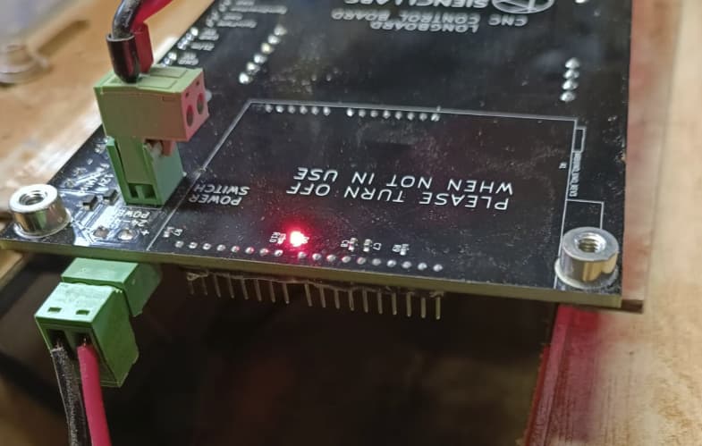

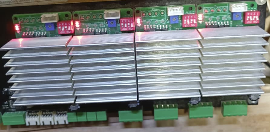

This is how a stripped down longboard looks like powered up:
