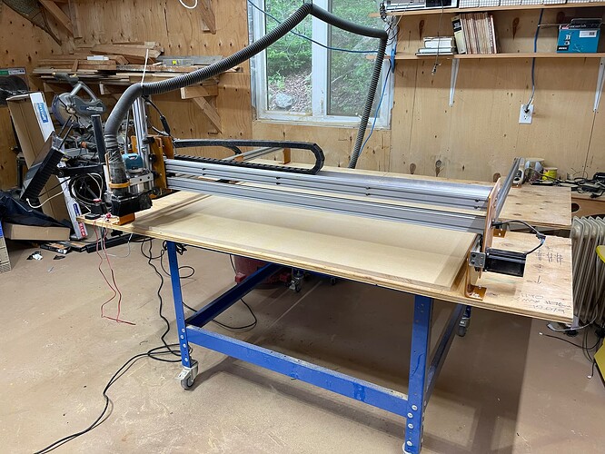

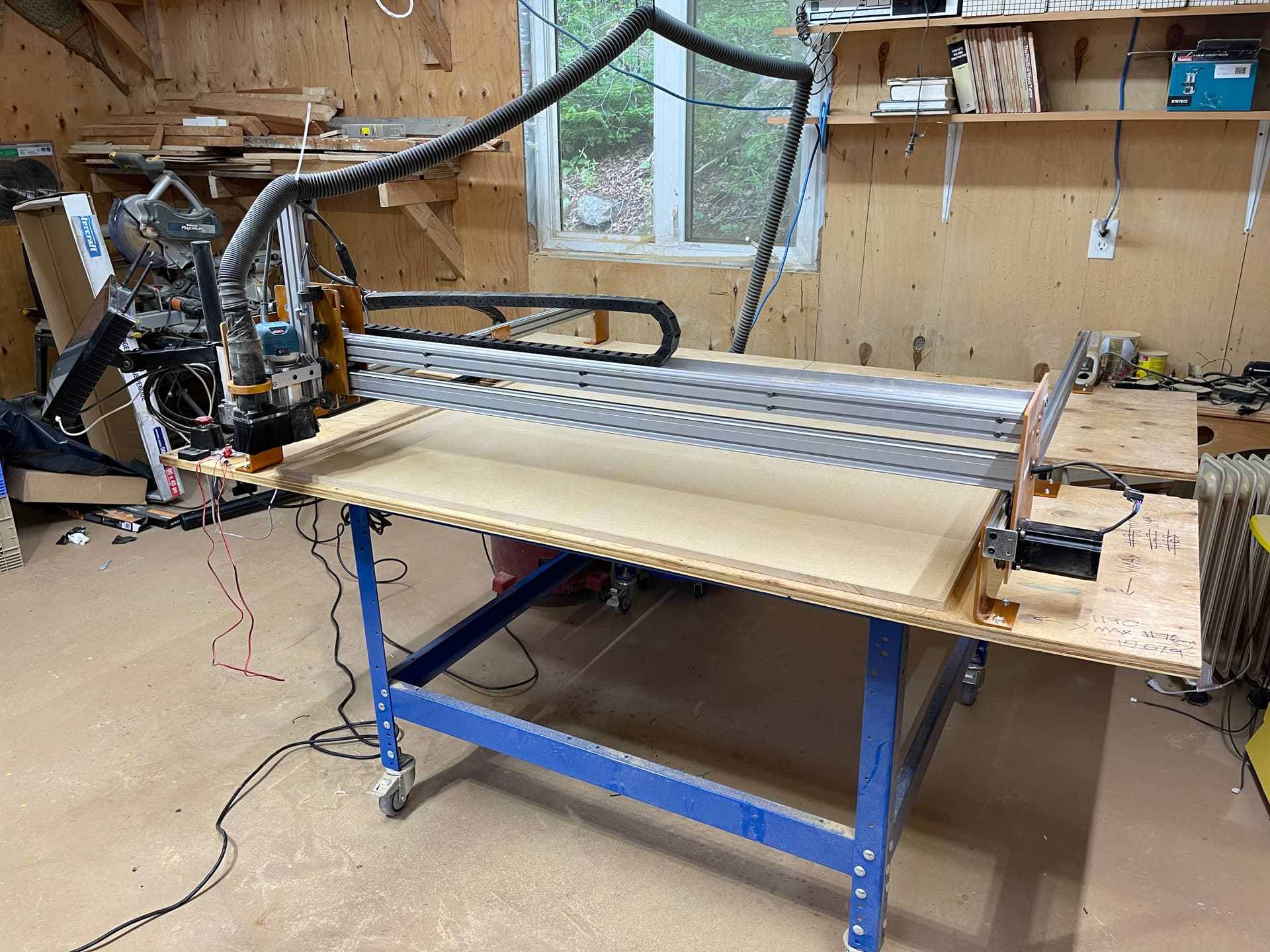

This will be the last post for the resurrection of the CNC Mogul. It lives!!!
After 3 attempts and 7 hours of cutting (kept picking the wrong spot to zero the bit) the spoil board has been surfaced.
So the machine mechanically is far from perfect. If anyone has experience with v-wheels and makerslide feel free to share. Let’s just say not all the wheels turn, all the time. They are tightened as per the assembly instructions and they do spin with my fingers but on each y gantry there is a least one that just slides along. I have fresh wheels and bearings to build up and swap out.
The other odd thing about the design is there isn’t a means of tensioning the wheels against the rail. Ala the usually employed eccentric spacer/nut. So I’m considering doing a little modification to include them. The internet rabbit hole on that topic is all over the spectrum on whether it is a good idea to use them for a rack and pinion drive. Most companies seem to be using a spring loaded tensioner for the motor and pinion.
Only one way to find out. And if it fails I suppose I’ll have to start saving for the Altmill.
On to making chips!!

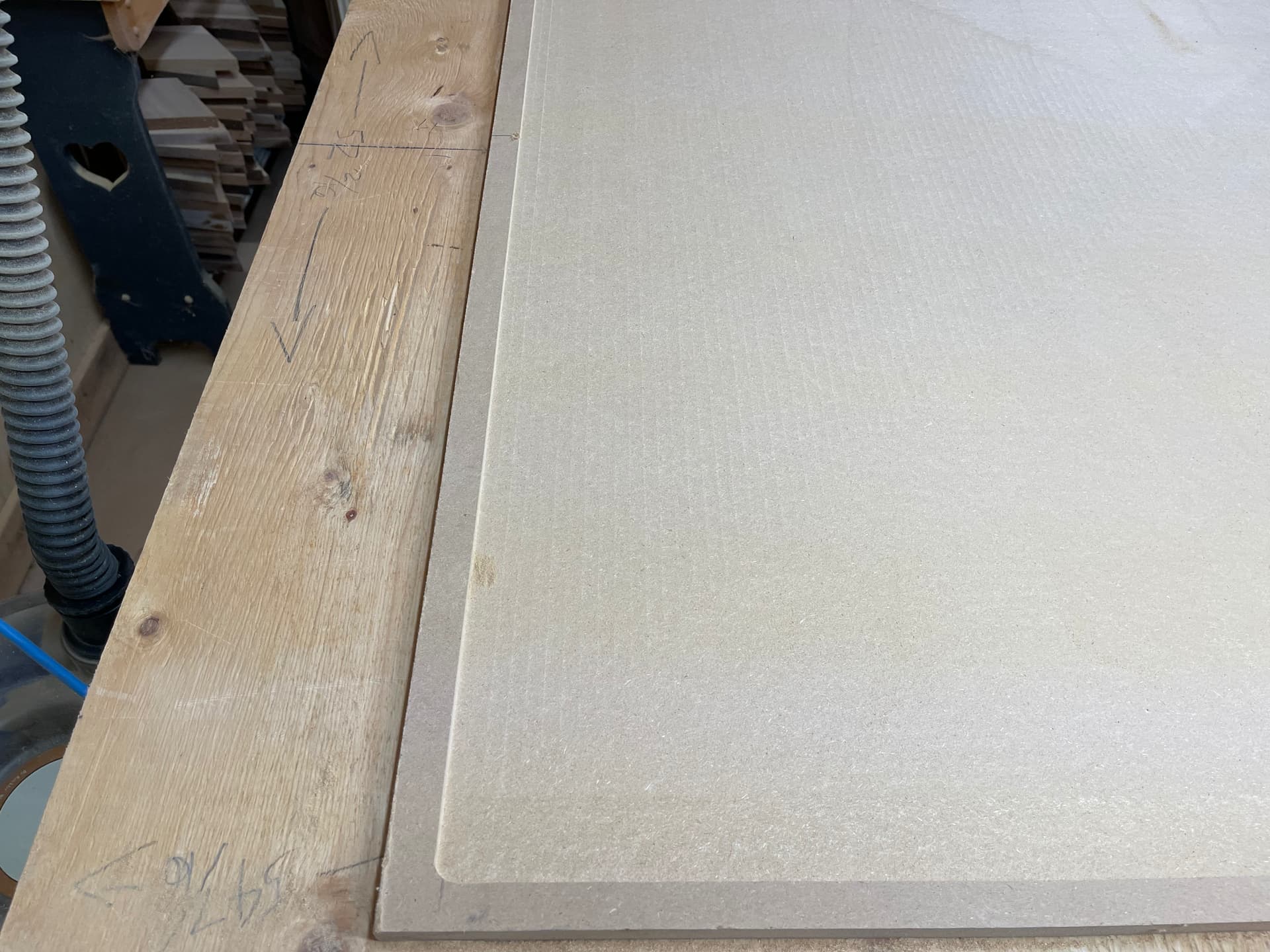

No no, it won’t be my last post ever. Just for this thread. Further posts will be in the showoff or other categories. First project is a torsion box based table to be the base for the machine. The surfacing has shown me how incredibly uneven the temporary plywood’s mdf combo is.
And yes I have dug quite the canyon. Man am I stoked all the screws I used got missed!!!

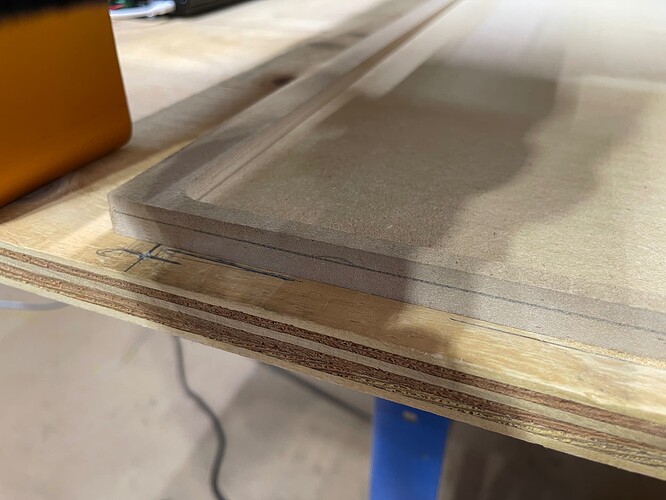

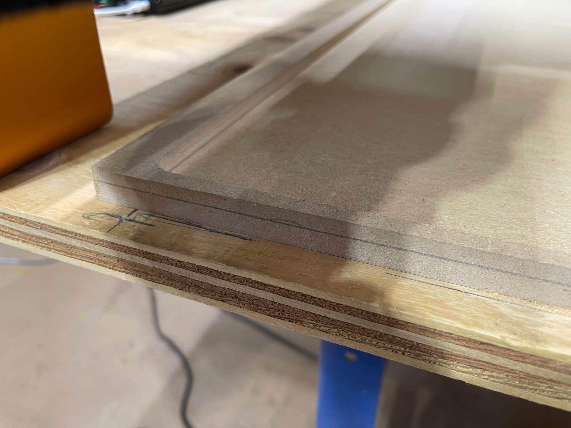

First, I have now learned the hard way the true extents of the work envelope, thank the maker for the included emergency stop button with the SLB! And I have gained a lot of experience using the motion tuning tool and x/y squaring tool!!

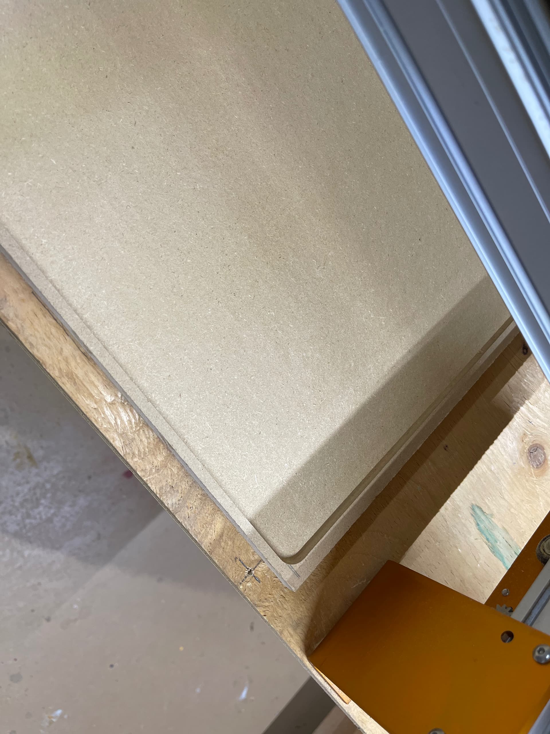

Second, I have learned that when attempting to level a surface choose the lowest elevation as datum. My first attempt I used the home position which magically was the highest. I should have stopped the program but after watching it run for 5 hours it had left almost 3/4 of the surface untouched. Then I “smartened” up and chose to zero the bit in the middle and when I saw it still wasn’t coming close to the back half of the surface I stopped the program and re-established zero there.
The odd thing on this attempt was that even though when I ran “outline” it looked good, when running the job the “X” dimension was offset by about 15mm. So I let this job run to completion which created the canyon you see. Then I created another “mini” surfacing job using the “ledge” of the canyon as datum and cleaned up the rest.
For the time being I will use the canyon as my trued surface until the torsion box is cut and built. As a bonus the edges of the canyon act as a fence so I can layout material square to the machine.
