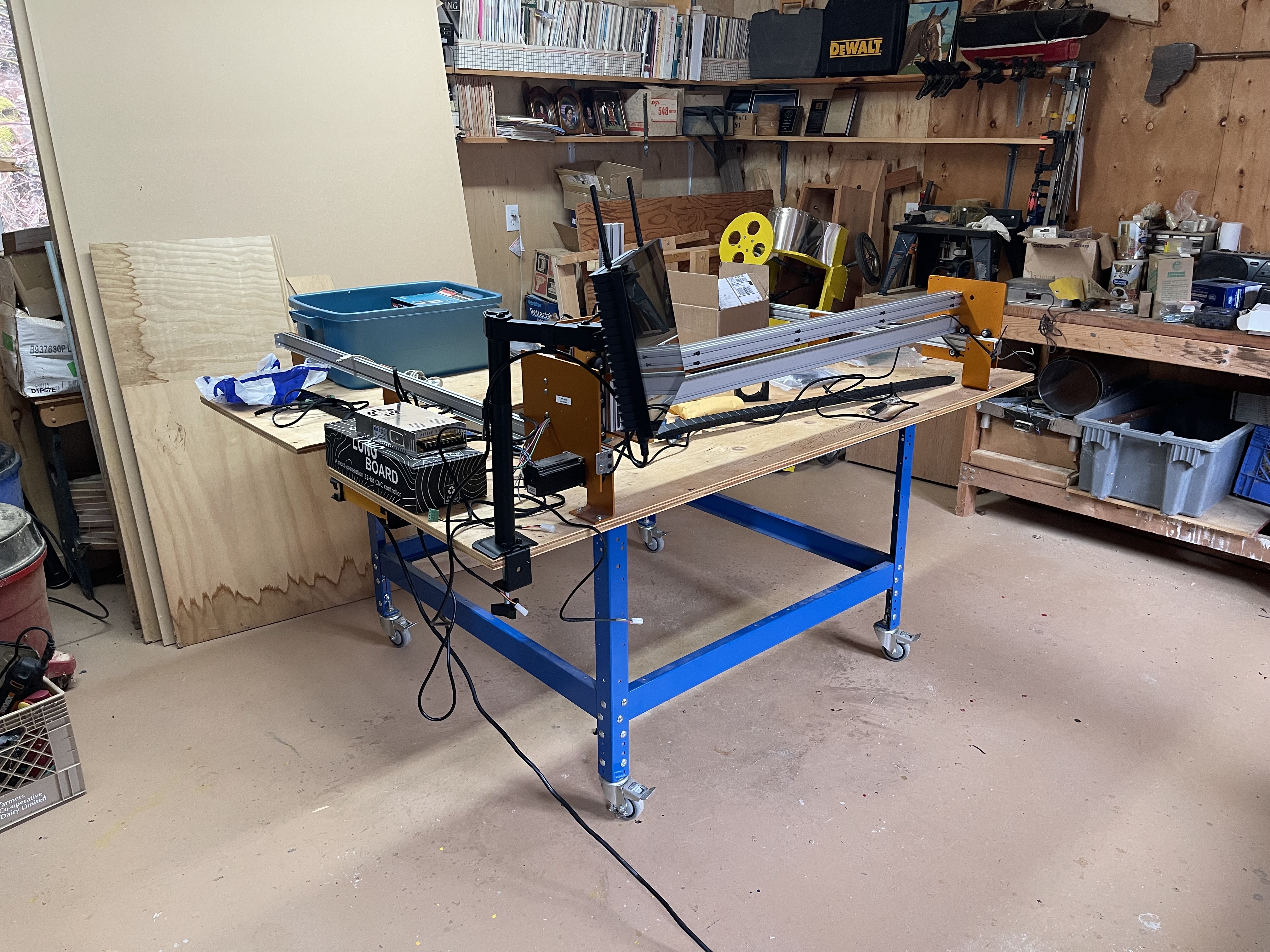

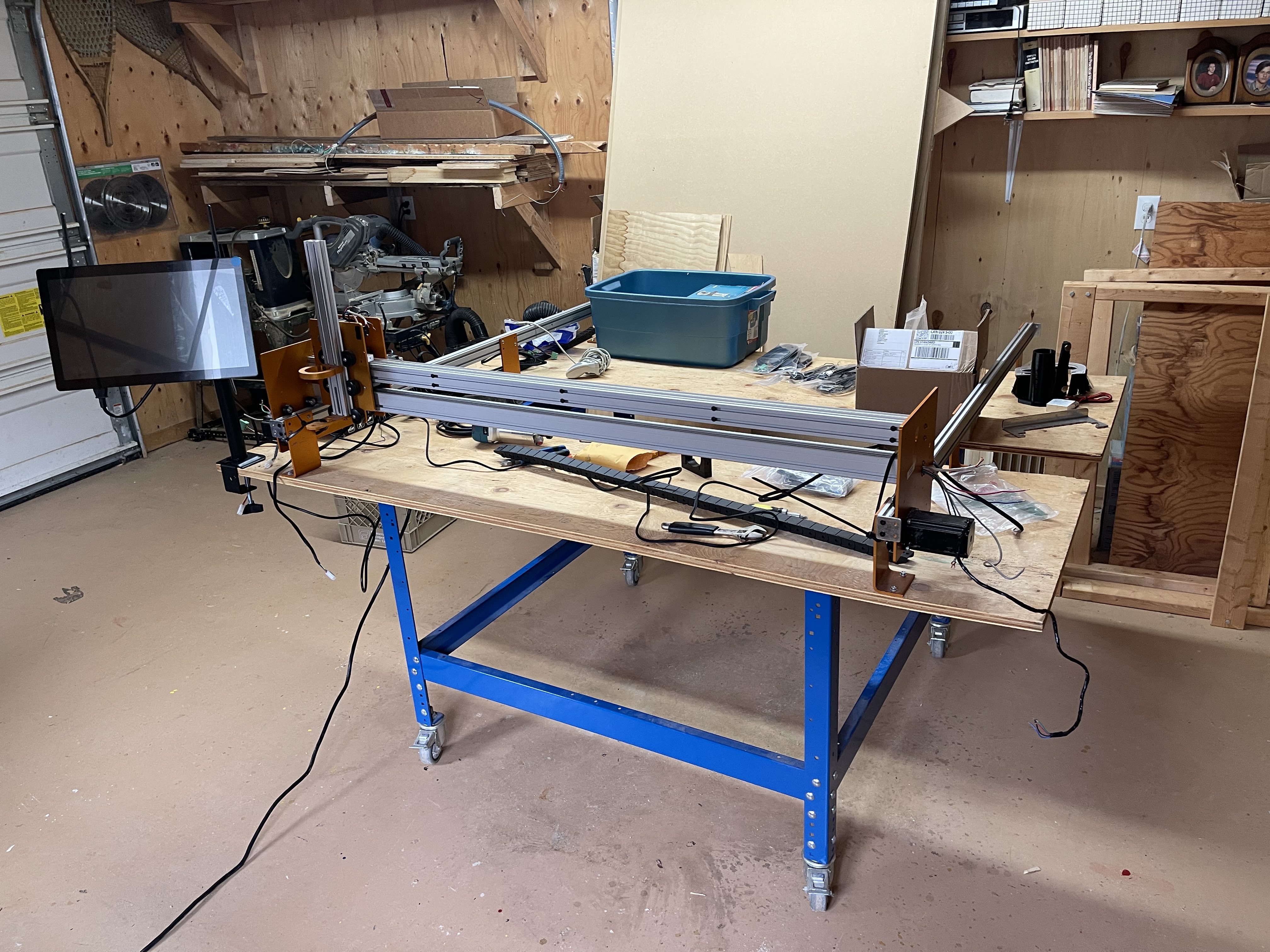

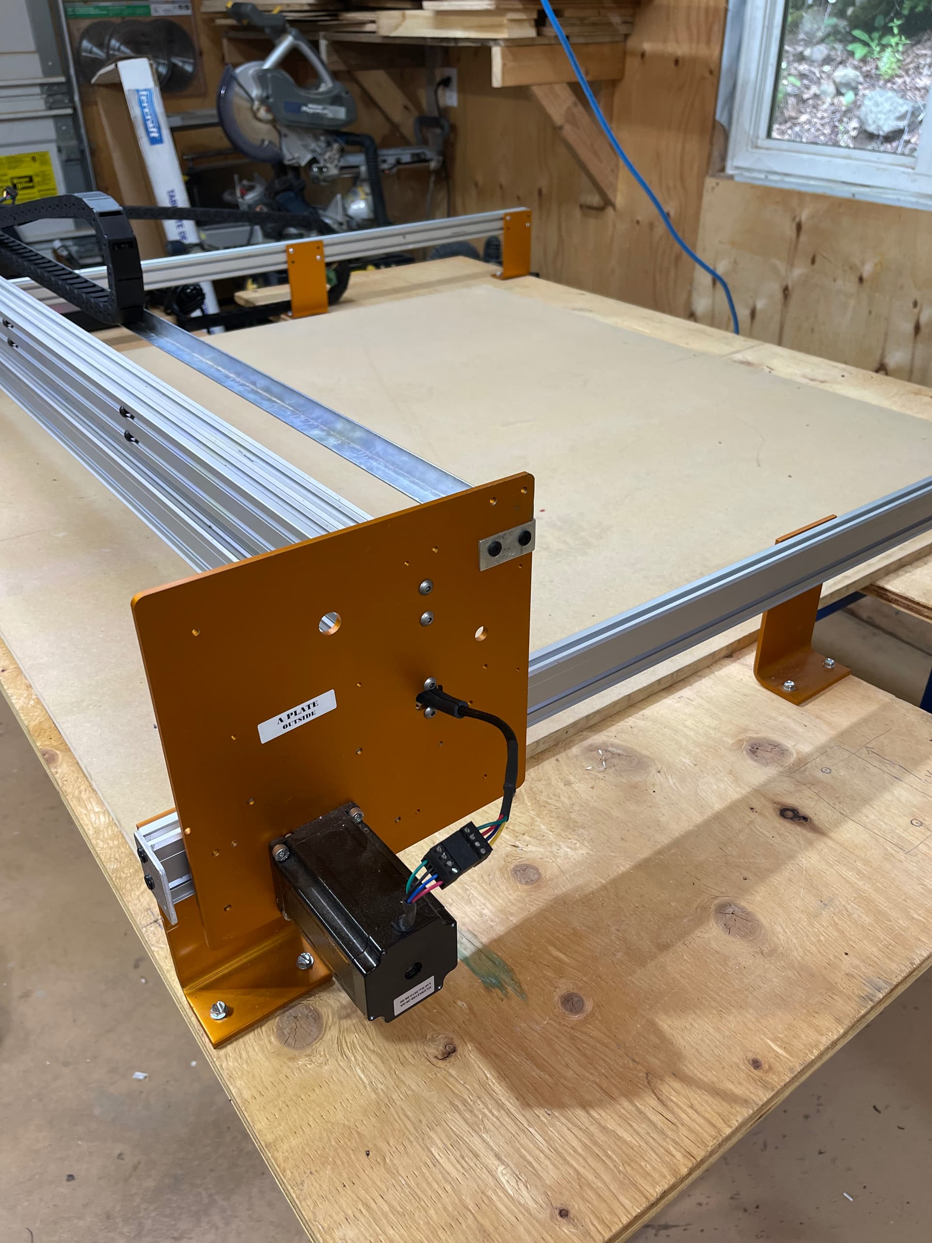

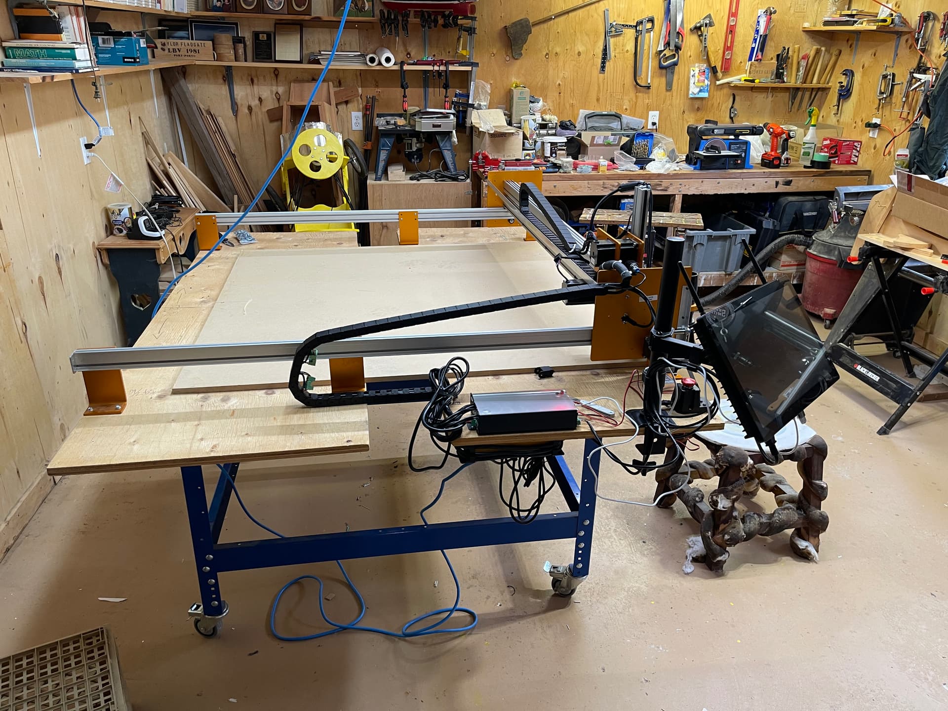

Some progress has been made. The old man’s work shop has been tidied, the CNC Mogul on a temporary table has been moved to its new home, and the old power supply and control board have been removed. The gControl panel arm has been mounted and the computer is connected to the local wifi and is up and running.
Here are a few pics:

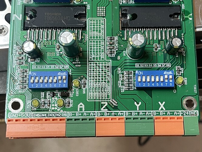

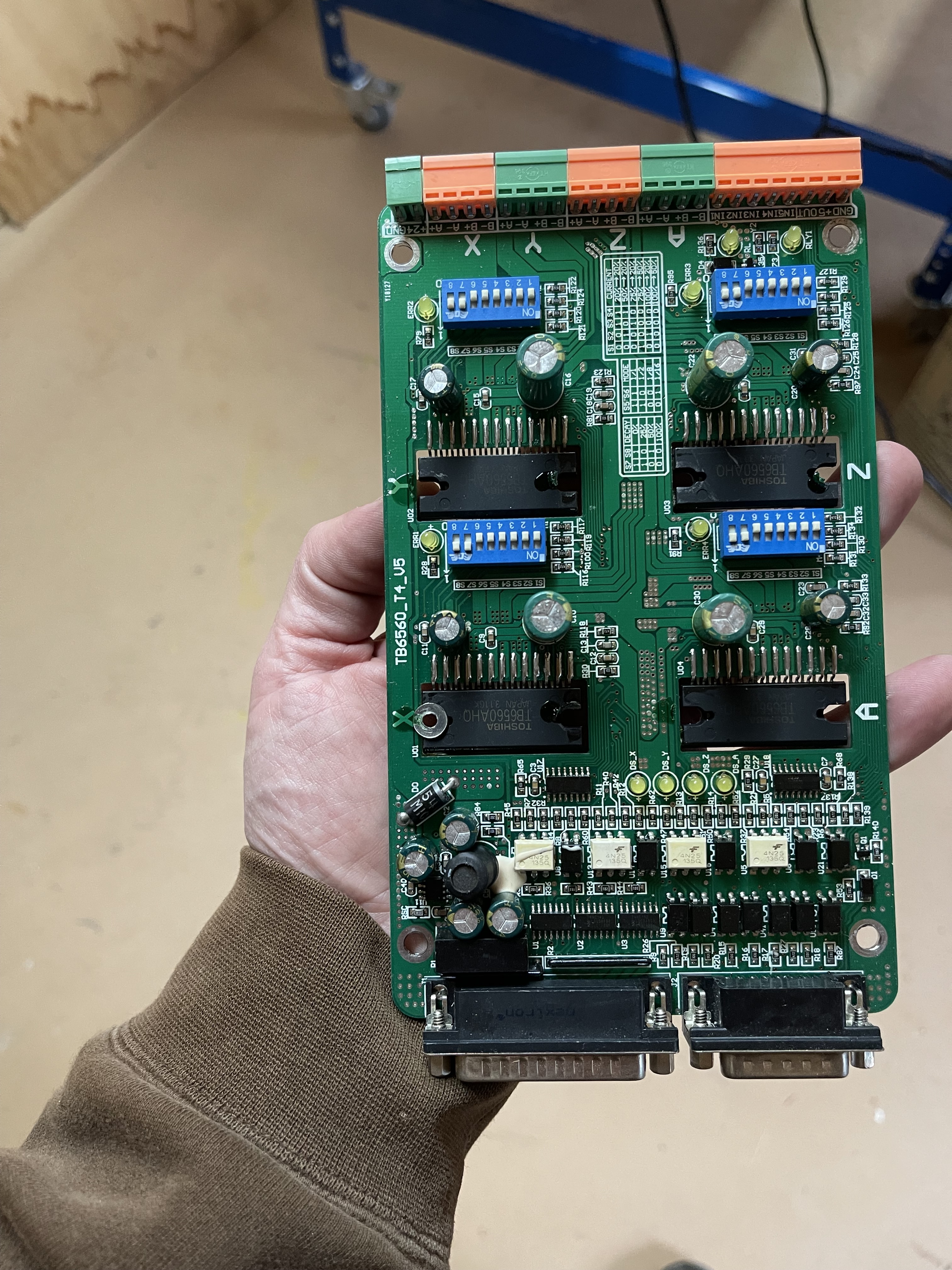

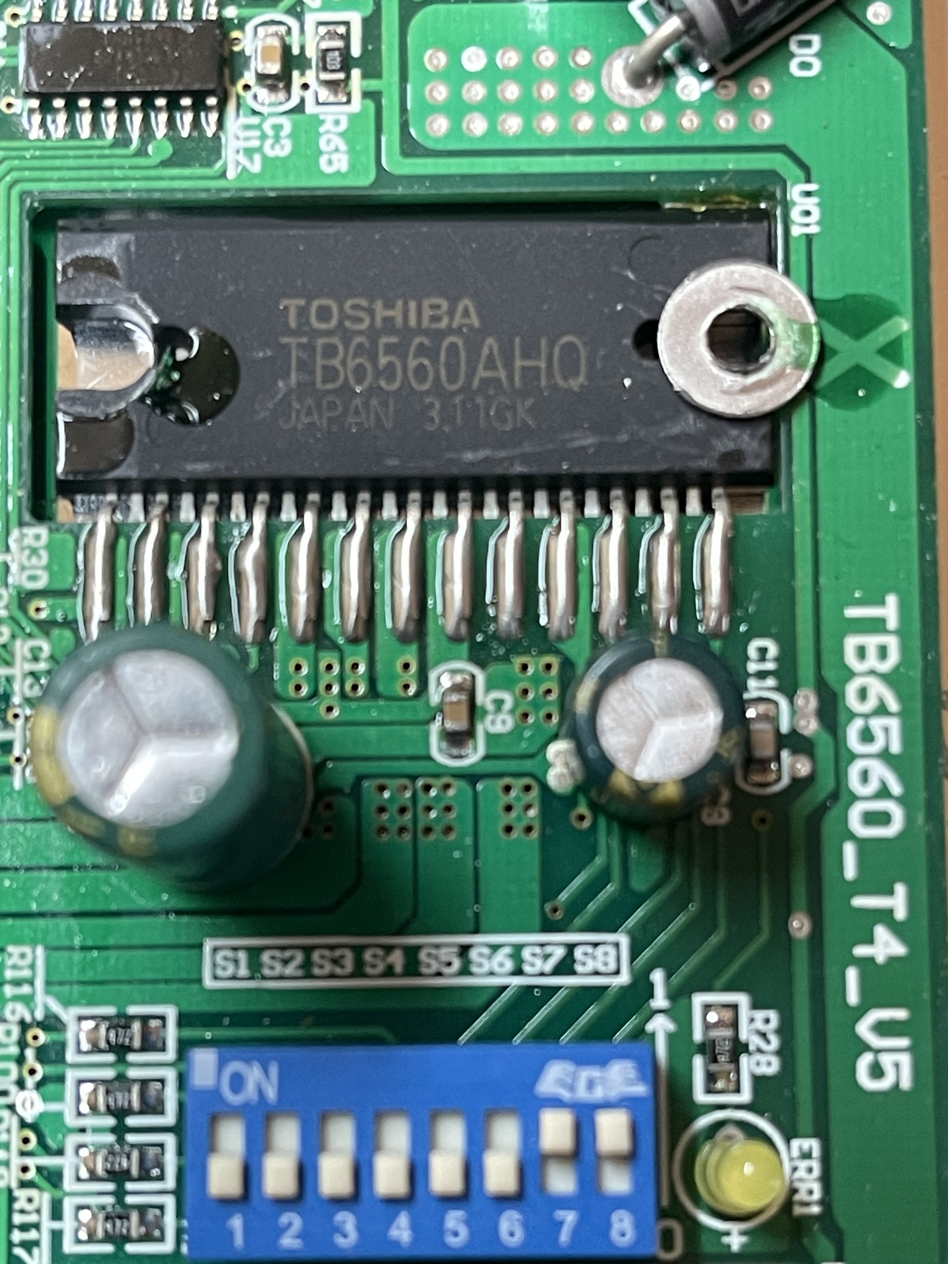

And for those who geek out on the old tech here are some of the og serial control board;

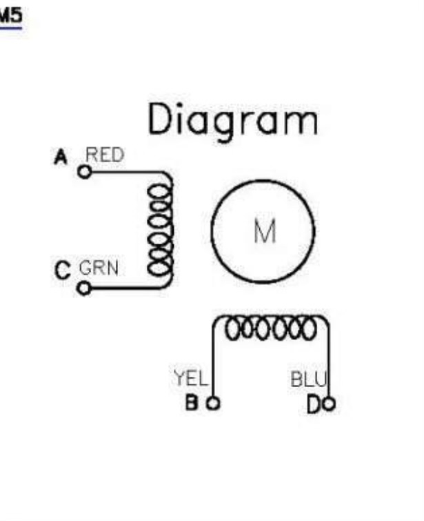

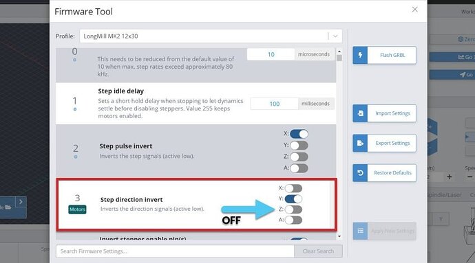

Mogul stepper wiring: The KL23H2100-35-4A stepper motor is a 4-wire bipolar motor. The standard wiring for this motor is: A+ (Black), A- (Green), B+ (Red), B- (Blue).
Sienci Lab motor wiring
Red/Green is one coil
Blue/Yellow is the other coil.
Just to clarify a few things; first, in normal stepper nomenclature, for long mill mk2 wiring the red wire is A+, the green wire is A- (labeled C on the diagram) and the yellow wire is B+, the blue wire is B- (labeled D on the diagram).

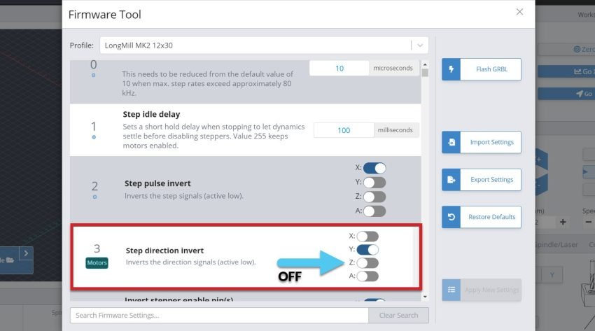

Second as the ol’ Mogul is rack and pinion driven, the ganged Y axis steppers are opposed. One needs to turn CW while the other needs to turn CCW in order to move the gantry in the same direction. If I’ve understood the SLB tech manual correctly the required reversal can be achieved in the firmware by setting:
  • $3=6 (X: OFF, Y: ON, Z: ON ,A: OFF) Inverts the direction signals (active low).
  • $8=1 Inverts the direction signals for the second motor used for ganged axes. NOTE: This inversion will be applied in addition to the inversion from setting $3.
Do I have that correct?

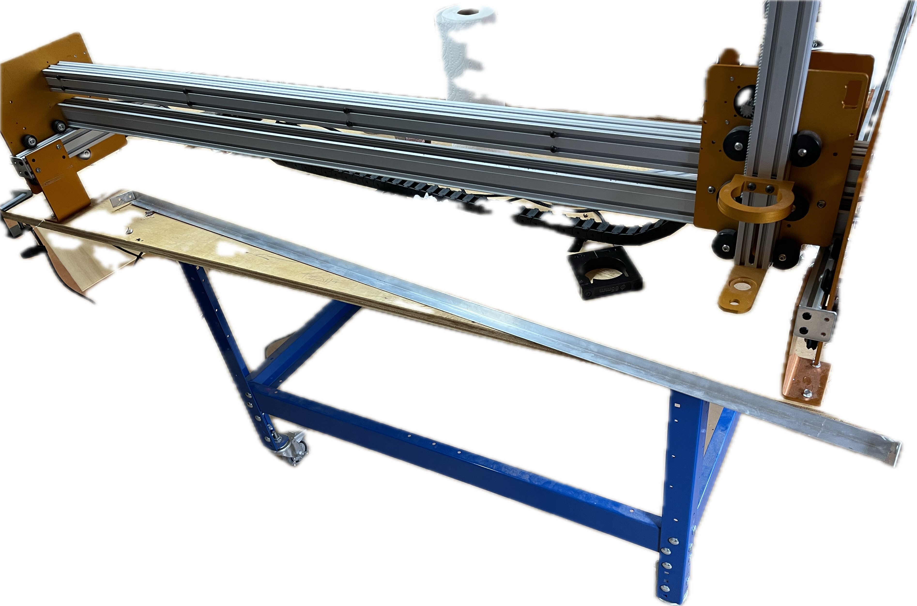

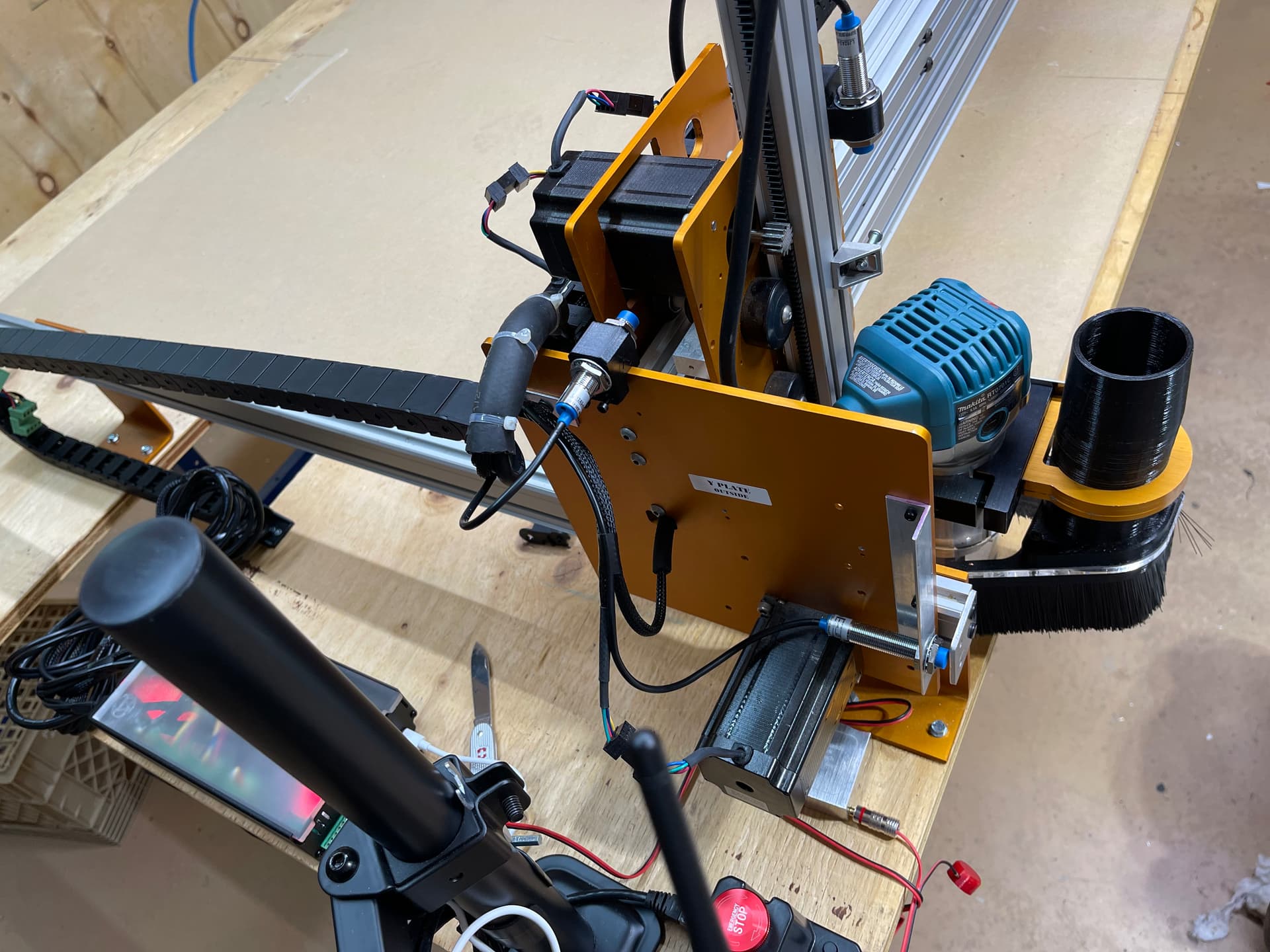

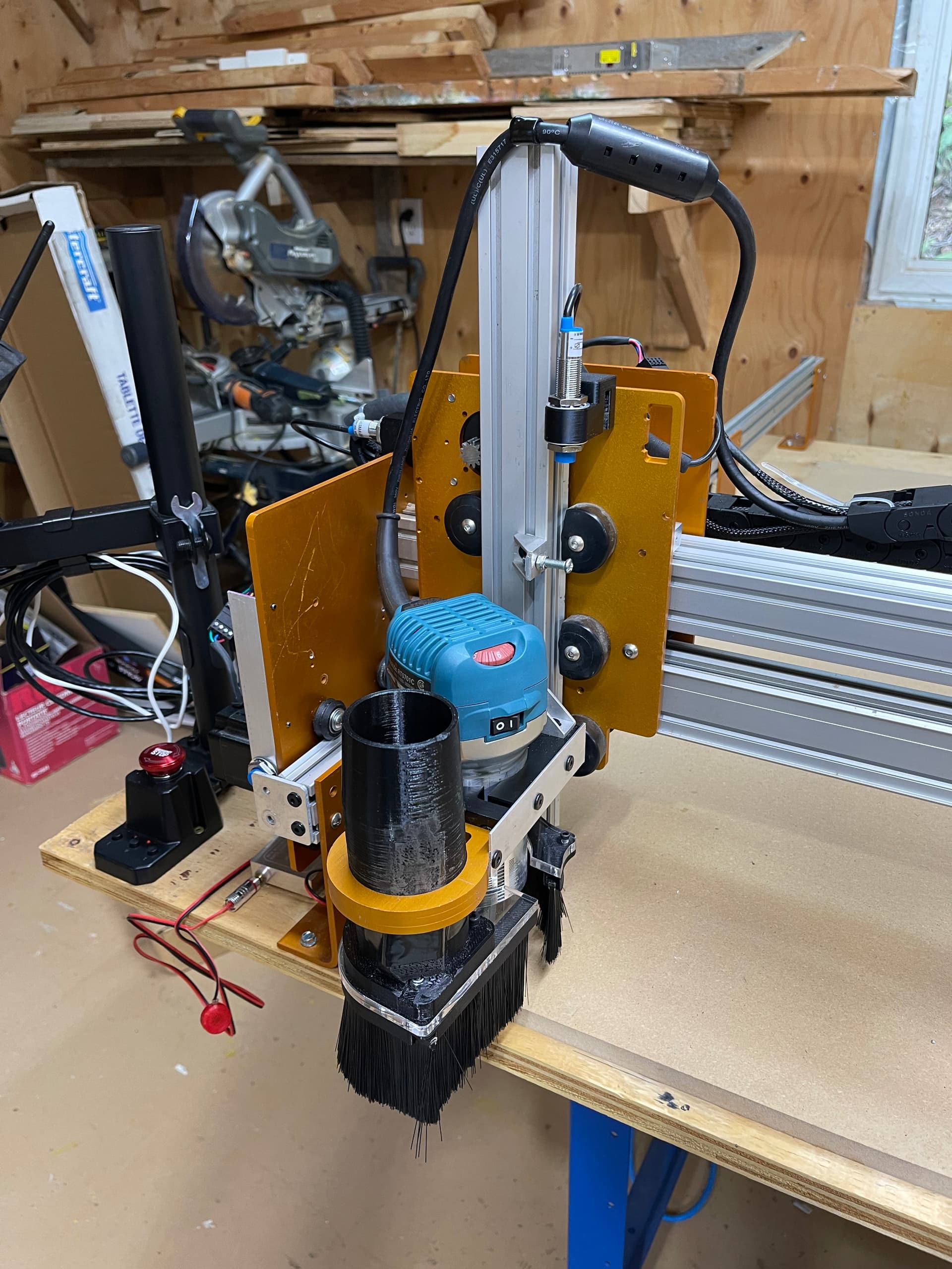

Small amount of progress to report. First modification to the Mogul is complete. I got rid of the conduit wire management. I made a “carrier” for the X drag chain from some C. Tire aluminum angle and drilled and tapped some holes in the Y carriage plates to mount it.

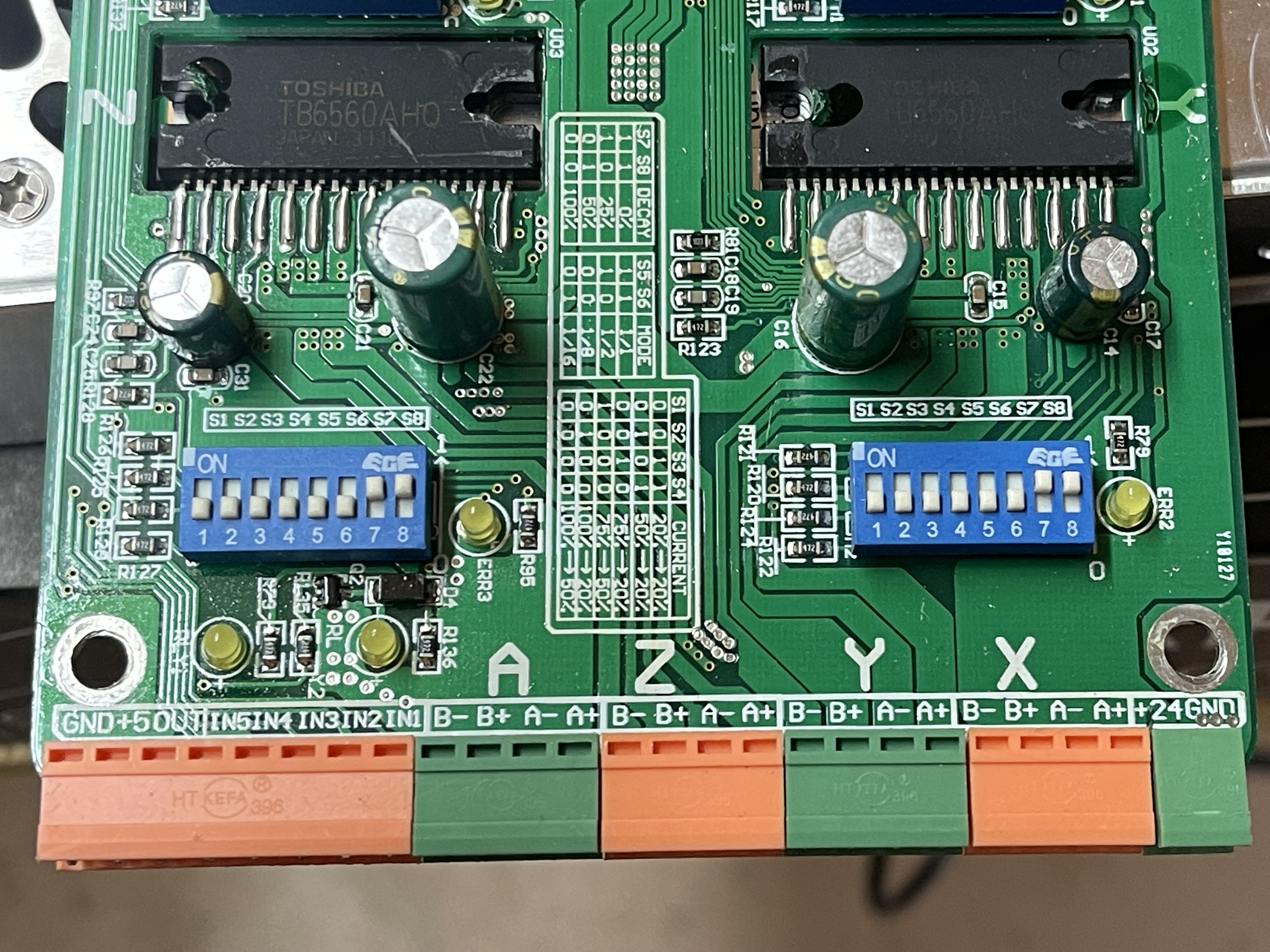

I have been lurking your topic and I must say, have been looking at that controler for way more time than I normaly give these kind of boards. I was triggered to do so by those weird mounted components. I have worked in electronics for a long time and never encountered components mounted inside a pcb like that.
Given, the boards produced at my old workplace were military, medical and communication stuff, so it might be a common practise in mechatronic devices. To me it was a first and had me flipping the photos you posted for hours.
Question. I seem to spot secundairy circuit board(s) behind the U1-4?
Whatever the case there, what I can see of this board, there’s a lot of work going into it. Thát is not and has never been an easy or cheap board to produce in high volumes. You might wanna hold onto it.

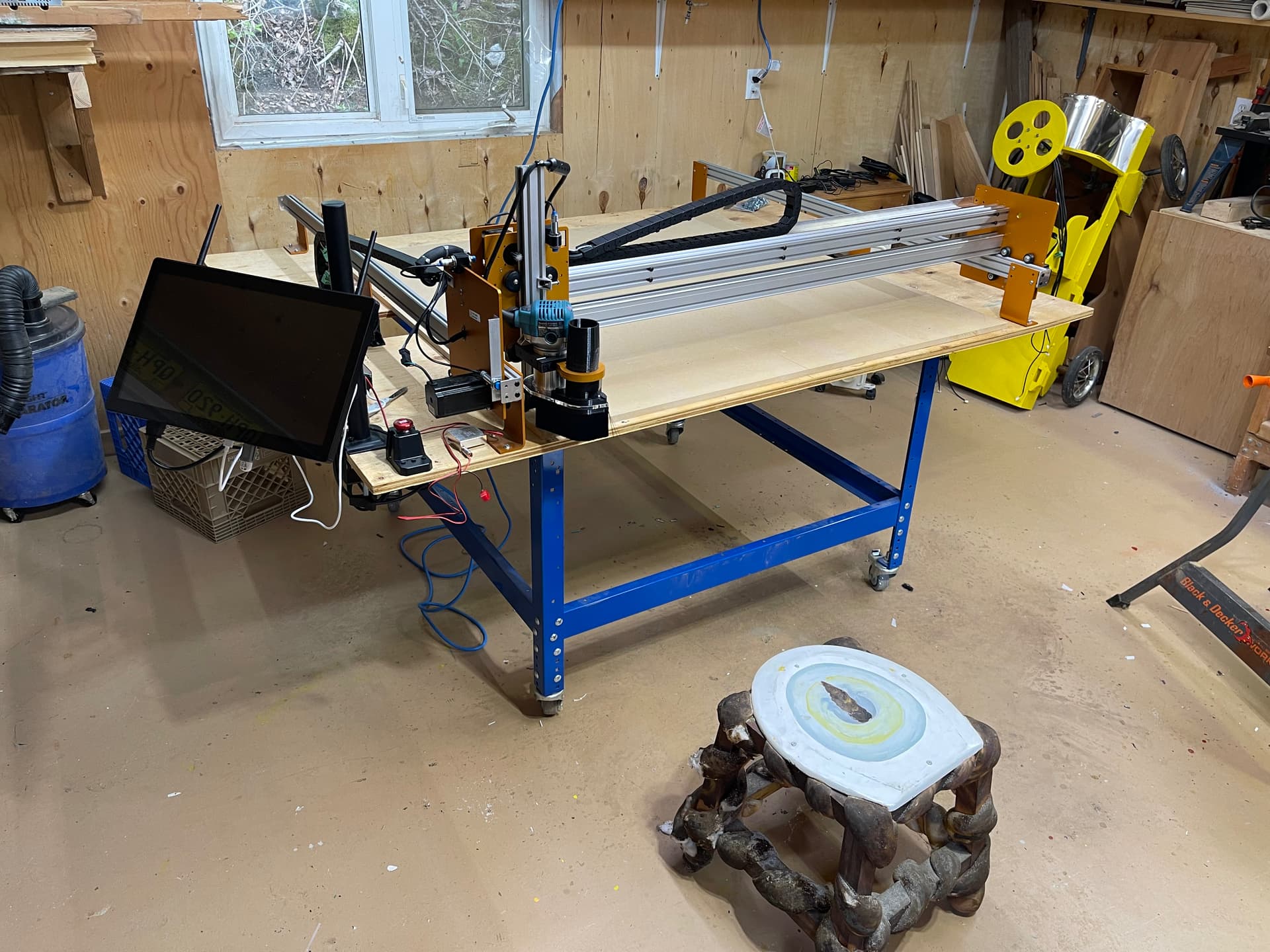

Updates have been few and far between but progress has been steady. Mainly choosing how to route the wiring, drag chain, SLB, E-stop, and power supply.
But big news! Today is the day! Every thing has been hooked up and I am about to start calibrating the machine. As the CNC Mogul is not on the list and the manufacturer is defunct. I’ll be taking my time to make sure I get it right.
One last ask of a repeated question. Which settings are required to ensure my dual drive y axis steppers run opposed to each other; ie: one CW and the other CCW?
My biggest fear is getting this wrong and destroying the rack…….thank goodness for the E-stop.

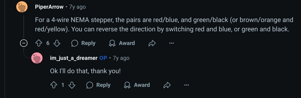

As far as I know both y1 and y2 are -still- coupled in the software side of the slb. You can reverse the Y output but that will reverse both outputs.

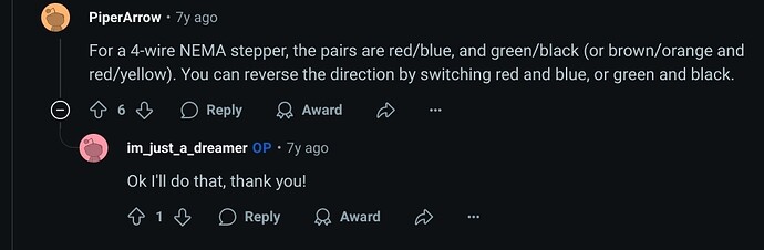

It looks like you have 4 wire nema steppers. According to some post in redit and youtube, it is simply a matter of switching a few wires around to inver the direction the motor will step.
Since the motor wires are easiest to loosen at the SLB, I would switch the wires at the SLB. I would however test the Mogul as is, for I can imagine they would use a native inverted motor for the second y-axis or.. maybe even more logic, have the wiring inverted.
If I look at the picrure of the native controller you posted, it seems to feed the same signal to both y-axisesen. I bet they did a wire reverse.

@hSolo I’m curious. On my Mk1 Long Mill, the Y motors turn in the same direction. Do they need to turn opposite to each other in ball screw or rack and pinion machines?
@gwilki I don’t think it’s required for ball screws but it is for rack and pinion if you want both sides to be symmetric. If each side is a mirror image of the other then one turns CW and the other CCW.
Eddie,
I ended up going with the wiring option. Not only to reverse direction for my Y2 stepper but also my X. Didn’t seem to matter what settings I changed in the firmware (and perhaps I have the conventions backwards) but I wanted movement away from home, lower left corner, (0,0,0), to be positive.
Now my Z moves upward in the positive direction. Perhaps I should reverse that too?
Thanks a bunch for your help.
Nat
Wel, I don’t have an SLB, my machine is running smoothly (apart from a bad usb cable) when it came out of the box 2/3 years ago, so I’ve not played around with settings much. My helpfulness has reached it limits somewhat.
You might be able to try and invert the z axis in this setting.
But if rewireing is working.. meh if it works, it works.
Oh wait.. z moves up on plus, seems to be the right way to go. No change needed, me think. Oh and please take before pictures of how things were before you started switching. I always find those helpfull when things spiral out of control and I feel I need to restore my foolingsarounds.

So I did the regular old man cell phone thingamajig and went to make a video of my newly calibrated CNC machine proudly returning to the home position…..I swear I hit record after hitting the home button and then hit stop after it had arrived. Well I have a lovely video of the inside of my pocket on the walk home. Oh my. Try again tomorrow.
Managed to set up the limit switches and went through the calibration routine about 5 times. The first go around 100mm sent the machine 522mm….eeeep. Well now the repeatablity is spot on. So I’m pleased with that.
