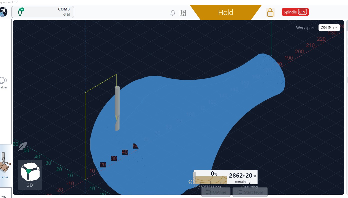

@chrismakesstuff OK, I’ll start with the good news. Edge does load much faster than gSender.
Now for the test. I loaded a known good gcode file for a vase that I cut on the Vorted quite a while ago.
In gSender 1.5.7:
  1. The file took less than a minute to fully open and display the stats in the lower left corner. The visualizer was dark.
  2. A few seconds later, the visualizer showed the rotary image. The start button was active within another second or so.
  3. I clicked on start and within a few seconds, the job started to run.
  4. The time remaining showed 2862 days and 20 hours. I’m attaching a screencap.

@chrismakesstuff I installed Edge 5 on my test PC/Uno.
  1. Edge started very quickly. A big improvement over all previous versions of gSender.
  2. I loaded the same rotary file that I sent as the bug report. When I clicked on start, the screen went black, then a few seconds later, a pop up gave me the option to verify the file. I clicked cancel. Again the screen went black, then it put me back to the main screen. I clicked on start. Nothing happened for several seconds, then the job started. The time showed a respectable 2:30. I let it run to completion and it actually took 3:09. So, very close.
  3. When I tried to close the file, the screen again went black and I received a maintenance reminder. I chose to reset it. Nothing happened for several seconds, then a window popped up showing the run time of the last file was 4:06. Strange, as it had said 3:09 when it ended. I tried to close that window and after several seconds, the maintenance window popped up again. This time, I clicked on cancel. Again, I waited for several seconds and the file run time popped up again, and this time it read 4:11. Keep in mind that the file was not running. However, some timer was clearly running in the background.
  4. I started gS 1.5.7 on the same machine. As expected, it took several minutes to open so Edge 5 is a big improvement in that context.
  5. I opened the same file. It opened much quicker in 1.5.7 than in Edge 5.
  6. I started the file and it showed that it was going to take days to complete. So again, the win goes to Edge 5.
To sum up, Edge 5 opens in the time that a program should. It shows a much more accurate run time than gS. However, Edge seems to be using a lot more resources as every click response happens in slow motion. Plus, it keeps popping up the maintenance reminder even after I reset it. Finally, there is something wrong with the run time counter as it seems to keep running long after the job is finished.
