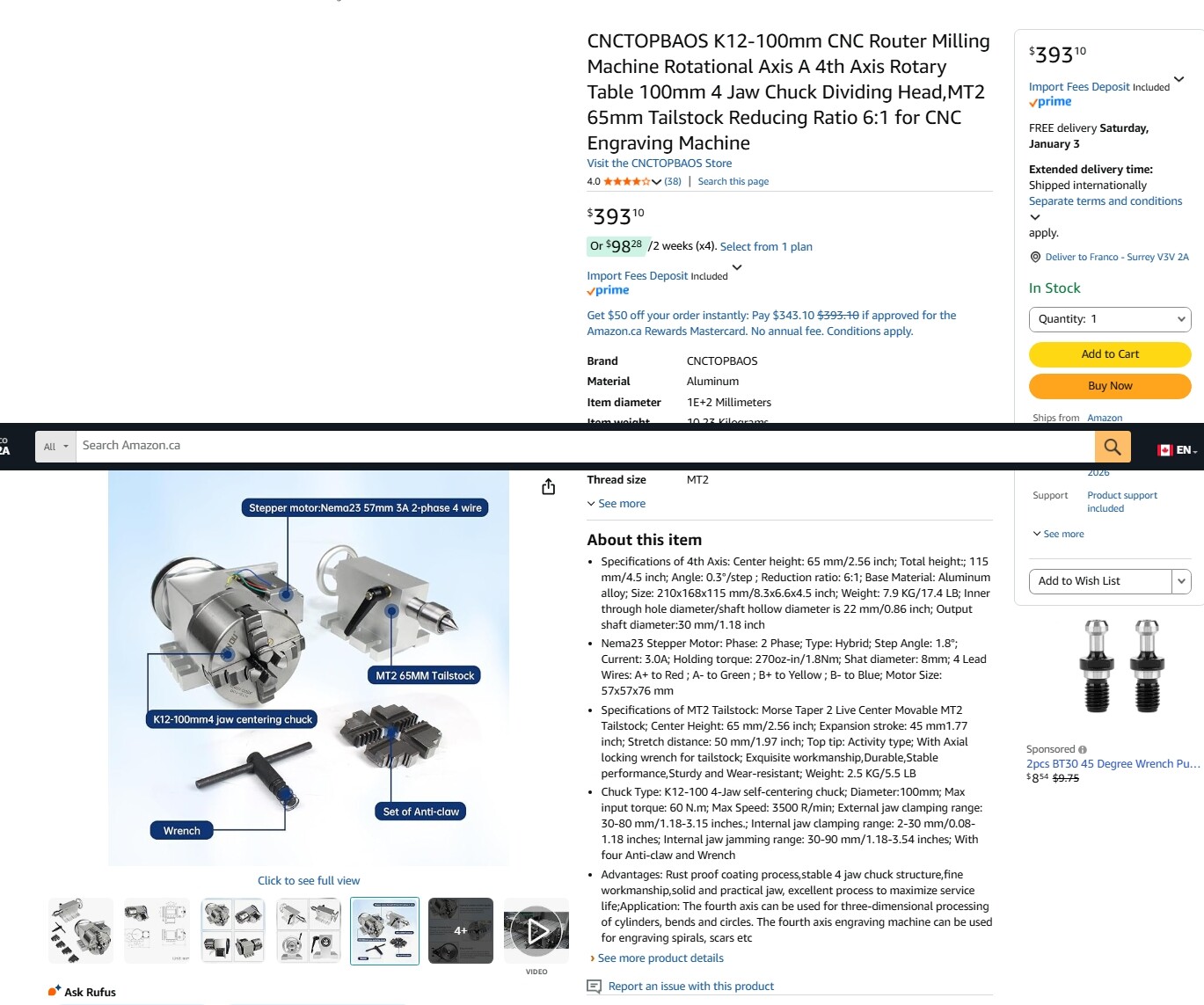

Hello and Happy New Year to all CNC’er! Can anyone guide me to a site that shows me how to set up the settings and wire hookup for a fourth axis on my Long Mill CNC? Ther is a lot of the Vortex Sienci Lab setup online, but nothing for an aftermarket (Amazon) rotary setup that I can find. I have the 30x30" Longmill, and I am working with Aspire and gSender. Any help would be appreciated.

  3. Can you post a link to the rotary that you bought?

  3. The link is from Amazon. Attachment

@franazzo Unless there is someone here who bought the same unit and figured out how to wire it and run it on the LM controller, I believe that you will need to contact the seller for help.
The LM controller has no accommodation for a 4th axis. That is, there is not a dedicated driver for a 4th axis. Sienci overcame this by offering a Y/A switch with the Vortex. Using it, the Y motor driver drives the A/rotary axis. Without that switch, you will need to uplug your Y motors and plug one of the cables into the rotary. Once you have done that, you should be able to use the Vortex firmware settings to run the rotary. You will likely need to experiment to find the correct resolution for the A axis, but that’s not difficult to do.
There is nothing the Amazon ad that says that the motor is closed-loop so it’s likely a safe assumption that it is open. Again, not real issue.
