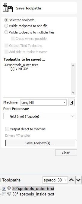

@MikeMiller In VCarve, after you create your toolpaths, you have to save them as gcode. That is the file that gSender reads. To create the gcode, you select a post processor. I’m attaching a screen cap of the window that you see to do that. You can see that, in this case, I am using grbl mm as my post processor. That is the post that I use for everything other than laser work or vortex work. What are you choosing?

Ah ok, I see now. I am using GRBL as well but on the rotary, I am using GRBL WrapY2A. I am on V12.506. I am using the inlay tool paths for the female and male parts. I just change the machine config to default Longmill for the male parts, cut out of flat stock. Then to the rotary config for the female cuts on the round stock. I just cant get good detail because the tool i am using is not in the data base
@MikeMiller Tks again. I don’t get that post as an option. I assume that’s because I have chosen the Long Mill machine configuration. I’ll add the rotary machine and see how that post differs from the one that Sienci provided.

Edit For giggles, I installed the Vectric Long Mill rotary machine on my test PC, and then I did have the option of the rotary post processor. I put it side by side with the one supplied by Sienci when they released the Vortex. With the exception that the Sienci post includes a line related to tool changing, where the Vectric one does not, they are identical. . I’m glad that you pointed this out to me, but since the posts are identical with that tool change exception, I may as well stay with the Sienci post.
