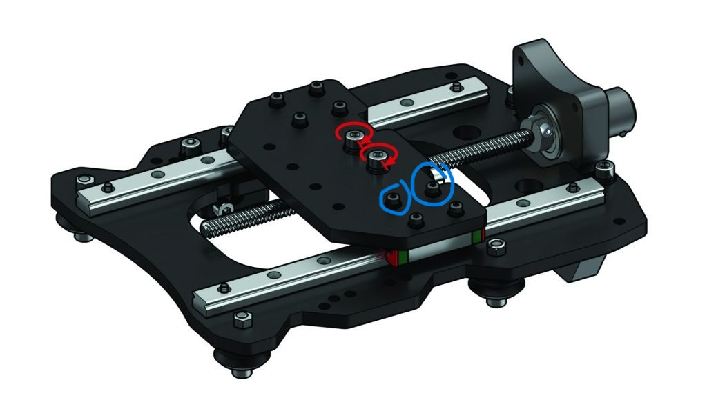

Can someone tell me the size of the cap head screw that connects the Z carriage to the linear bearings? I was working on tramming my LongMill MK2.5 and stripped the heads of two screws. I circled the ones I am referring to below. Thanks.

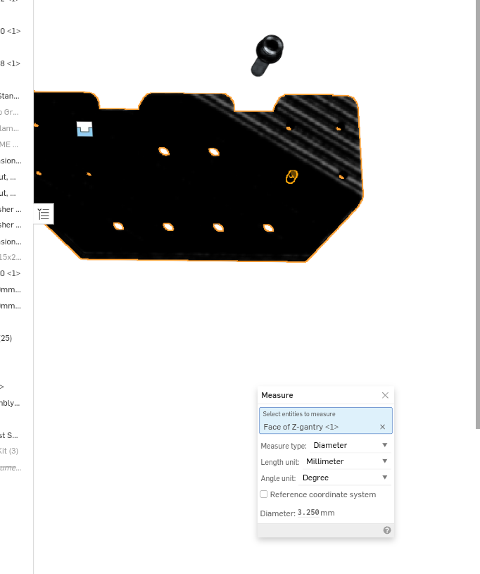

@dam4 The Onshape drawings are found here: Onshape
That hole is shown having a 3.25mm diameter. If it’s a threaded hole, it would be for an M4 screw. If it’s not threaded, likely for an M3 screw. I don’t know the length but you might be able to get it from the drawings. Kinda hard to do it from my phone.

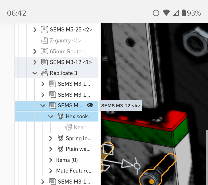

@dam4 looks like M3-12
