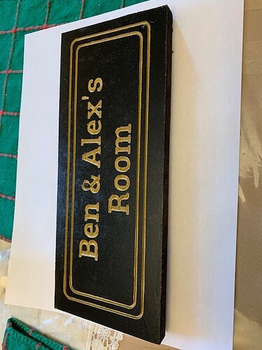

My first sign using a mask to separate painted areas:
(my grandsons are 2 years apart and share a room). This was done with Oramask 813.
@falviani Frank. I hope that you don’t mind me rotating it. It deserves to be seen in its best light.
benandalexroom
I made another one today but using contact paper in place of the Oramask as an experiment. I am not pleased with the results :frowning: While I thoroughly rolled it for maximum contact with the MDF, it still ‘frizzed’ in many places around the text. The sign will have to live with no paint in the cut outs. I definitely plan to stick with the Oramask for future signs.
