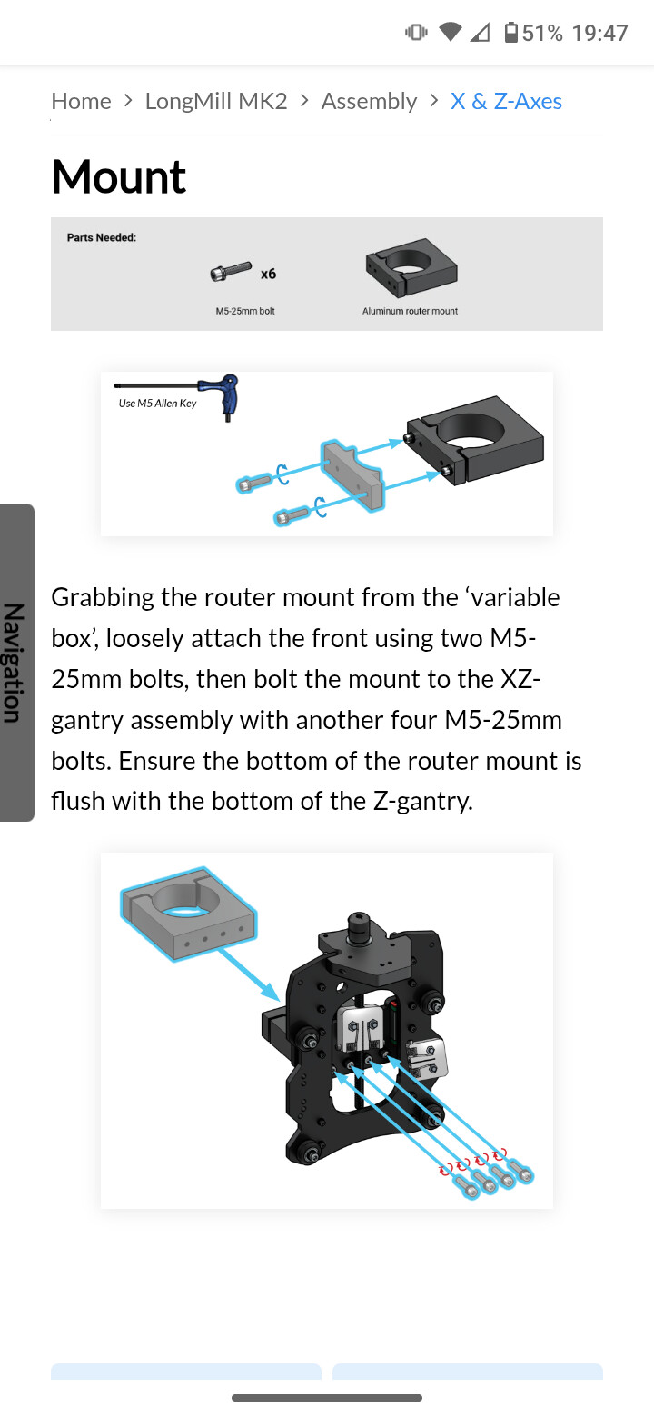

Just checked Grainer and it sure does look like the screw but now I need to make sure the length is 14mm.
Thank you for the suggestion!
The drawing on the link you provided show they are 25mm x M5 screws. Not sure if that’s what you have but you would measure cap screws from the tip to the bottom end of the cap. In other words, the 25mm length is for the shaft and does not include the cap.
Thank you. I think the best thing to do is remove one of them and then take it over to Grainger.
Thanks for pointing me in that direction. They’re not too far from me, I am pretty sure they’ll have it or I can look on Amazon. Just found some varying length ones on there.
And items on Grainger can vary a lot in price. But in Canada, I should be able to get a pack of 50 stainless steel M5 x25mm cap screws for about $5
USD $8.80 is the price on their site, here. This is OK, I will check this out. Just want to be double sure the design (length) hasnt changed since April 2021. I believe the link for the part is the newest version.
My local Grainger is an industrial supplier. Parts like fasteners usually come from their warehouse. So dropping by their store to order would likely mean coming back a second time to pickup.
OK, thanks for that tip!

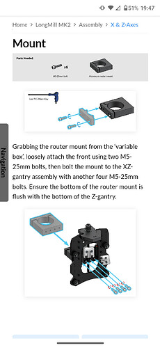

I’ll dig for the build documents and find the exact length. (just hit myself across the head for not thinking of that first!)
Update: Found the instructions and yep, its all there on page 77. Thank you for your help!
