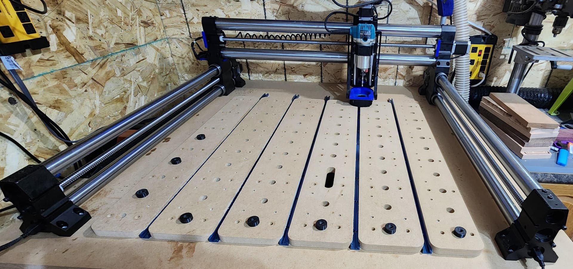

That’s fair, I can get behind that. It’s not exactly what you want, but here’s what I did which ended up with a somewhat similar setup:
I used MDF as my table top, milled a grid of holes in which I installed threaded inserts, and used those to bolt down my actual wasteboard slats. The slats are designed to be able to be machined on a 45 degree angle so I don’t have to make them manually. I cut thru holes in the slats so that I have access to additional threaded inserts in the table top. Throw some rabbets in the bottom of the slats to help the t-slot from pulling out. Pretty snazzy looking wasteboard if you ask me.
With all that being said, I have yet to use either the threaded inserts or the t-slot, so it was really just a huge waste of time. Looks cool though.
