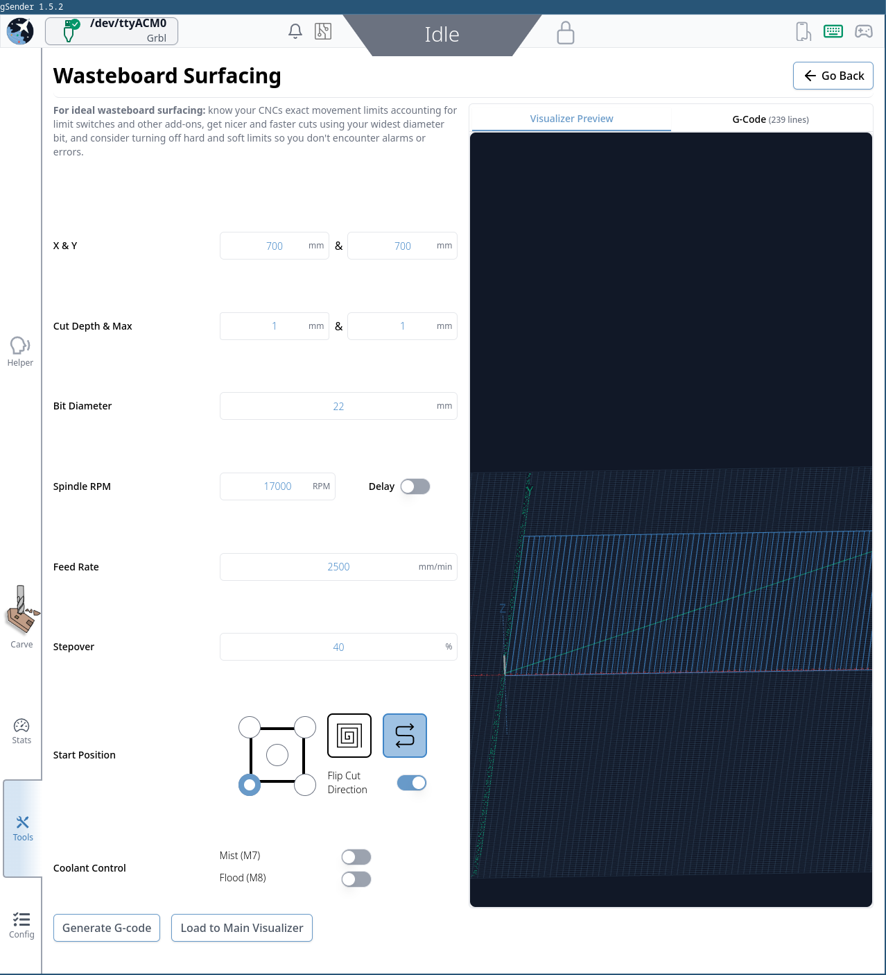

I then had a clever idea of using the same feature to add an alignment grid after surfacing, I specified that I was using a really large diameter bit (50mm), but used a vgroove bit in instead. Then by selecting the zig zag surfacing selection it nicely carved horizontal evenly spaced lines into my surface board. It was after that I discovered that there is no Vertical Zig Zag cut option :-(. Would be nice if they added a Vertical Zig Zag option and that would allow the creation of a vertical alignment grids, without having to create a whole new function just to do grids. (Or have a grid button, that would ask for spacing and depth and do both vertical and Horizontal) :slight_smile:

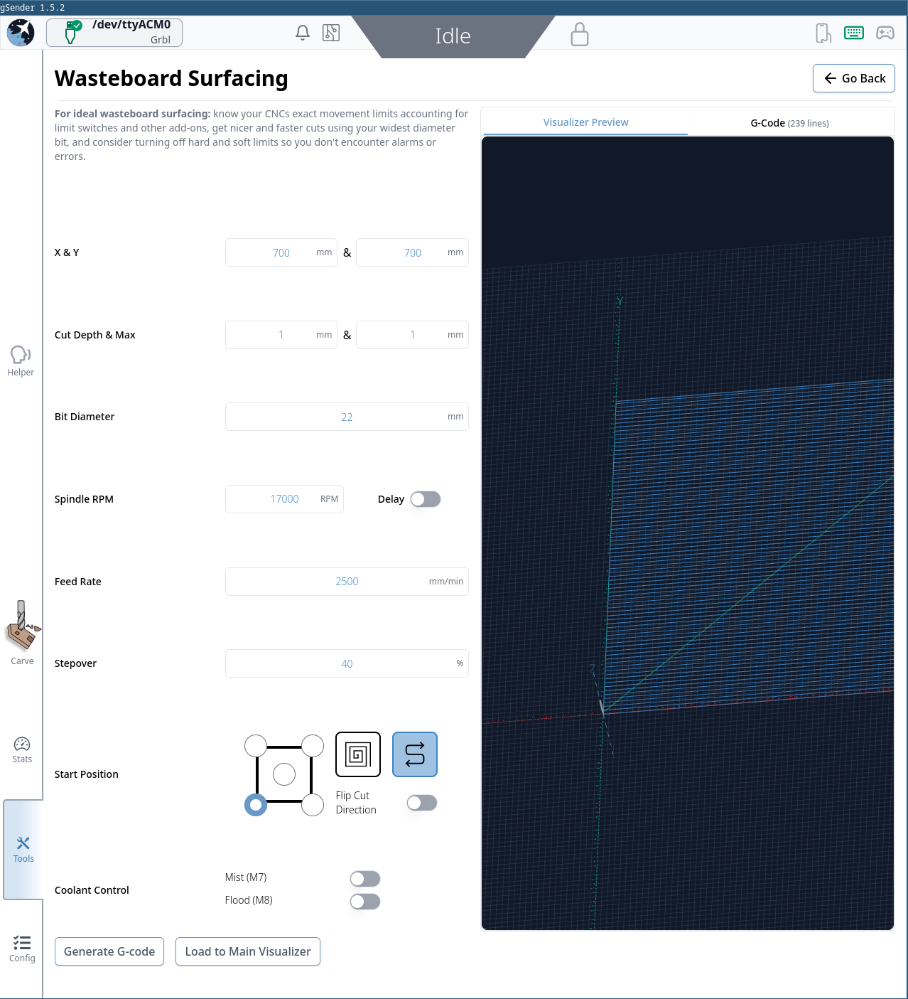

This can already be done. There is a ‘Flip Cut Direction’ toggle.
Oh Wow! Thanks for the info. I saw that and stupidly assumed it was reversing the direction rather than rotating it 90 degrees. I will definitely use this the next time I need to resurface, as its so easy. After the resurface I just change the Bit size and regen the gcode for horizontal lines and repeat for verticals.
