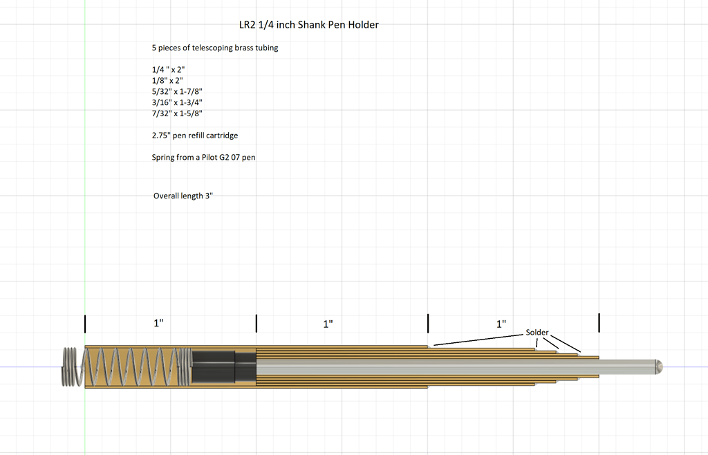

I made one out of telescoping brass tubes. It is 1/4” diameter and holds a pen refill. Makes it more like a plotter with the thin line.
I’ll post pics and instructions here later this eve.

Telescoping brass tubes you say? My brother used to be a professional model maker and he gave me a bin full of brass and plastic tubes. You have no idea how many times I used them to makes or fix stuff. A pen refill is a good idea and I’ll see if I have a tube that will fit :slight_smile:
