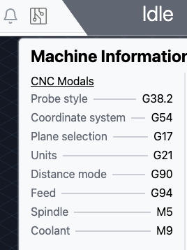

Grbl/HAL modals are specific g-codes that persist on the firmware side unless explicitly changed or the board is hard/soft reset.
In the UI, they correspond to the “CNC Modals” section of the machine information flyout, or the $G output.
They are generally things you want to set once and have persist so it should be intuitive - thinks like spindle direction can be sent once and not need to be resent with every line, or movement type as examples.
The reason for storing and then restoring modals in the macro is to avoid situations where you’ve change something that will impact your tool path (like changing the units from metric to imperial).
It’s technically redundant but generally a good idea to do for any custom g-code/macros because it can lead to issues that are hard to diagnose.
