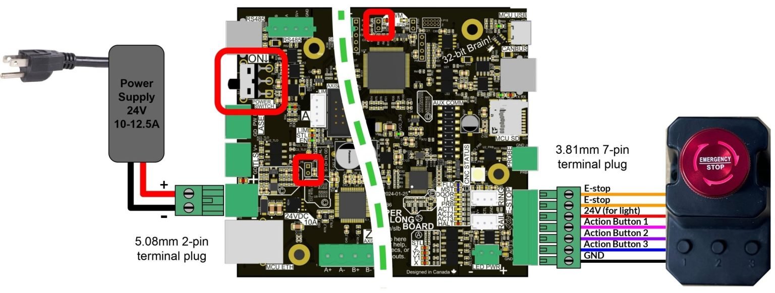

Does anyone have a detailed and annotated SLB-EXT connector documentation image like example, but for all the connectors on the board?
If not, @gwilki et al, are the Altium SLB-EXT files available, or a PDF of the relevant schematic pages for the board+connectors? I’d be happy to create a pinout document, given more detail than the fuzzy silkscreen :slight_smile:

I’m not sure if the schematics I linked there will help or not. They are for the SLB not SLB-EXT. I think the two boards have much in common. It seems to me that the SLB-EXT docs focus on the differences and rely on the SBL docs for the things in common.
The board layout and connectors are slightly different, thus my request. Here’s what I’m working on, with unknowns called out…

Updated board layout, with RCATC and AutoDustBoot wiring (still work in progress, feedback welcome!)
SLB-EXT-Pinout-DRAFT3.pdf (2.4 MB)
(updated with Draft 3 Sept 6, 2025)
Draft 3 includes data from the slb-ext schematics kindly provided by Jason at Sienci Labs, as well as wiring for RCATC plus AutoDustBoot add-ons. As usual, feedback and errata appreciated!
