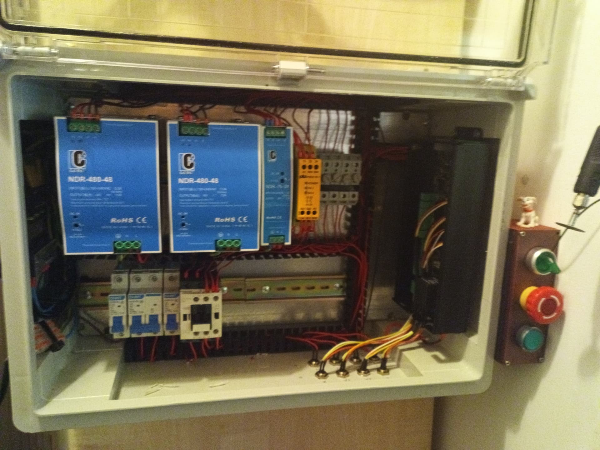

I will also need to wire in my Estop circuit into the SLB Estop to make it common. Not looked at it yet but shouldn’t be too hard.

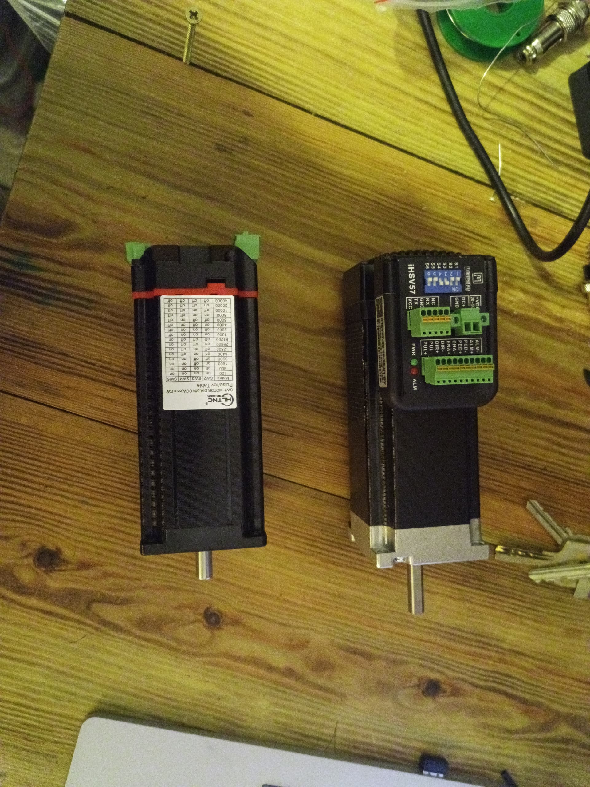

I have HLTNC nema23, 3Nm, hybrid stepper motors with built in closed loop servo drivers. Going to run them at 40v.
I also have some nice IHSV57 180w, closed loop servomotors with built in drivers which I will try to install and set up after I’ve had a play with the HLTNC stepper motors.

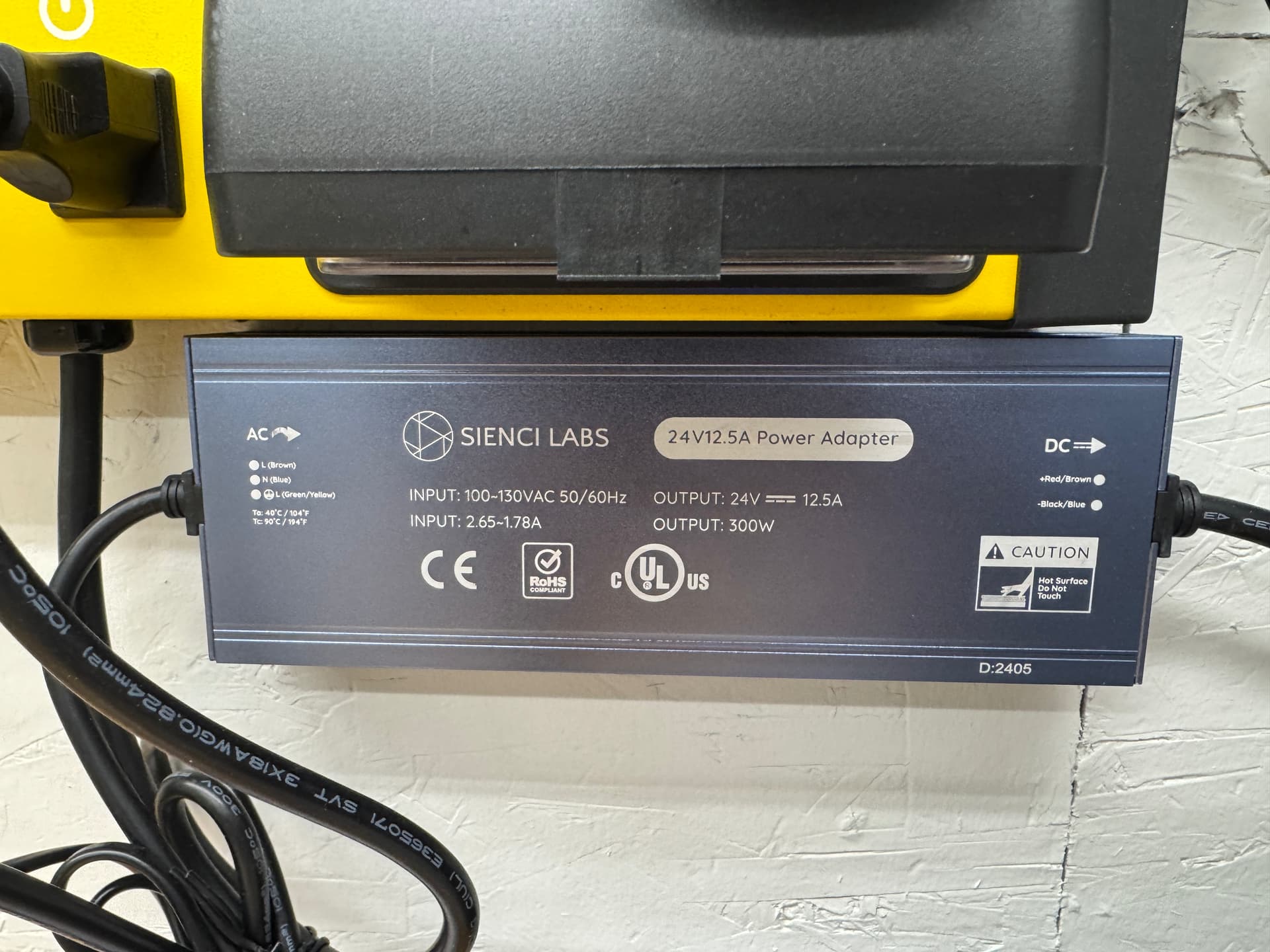

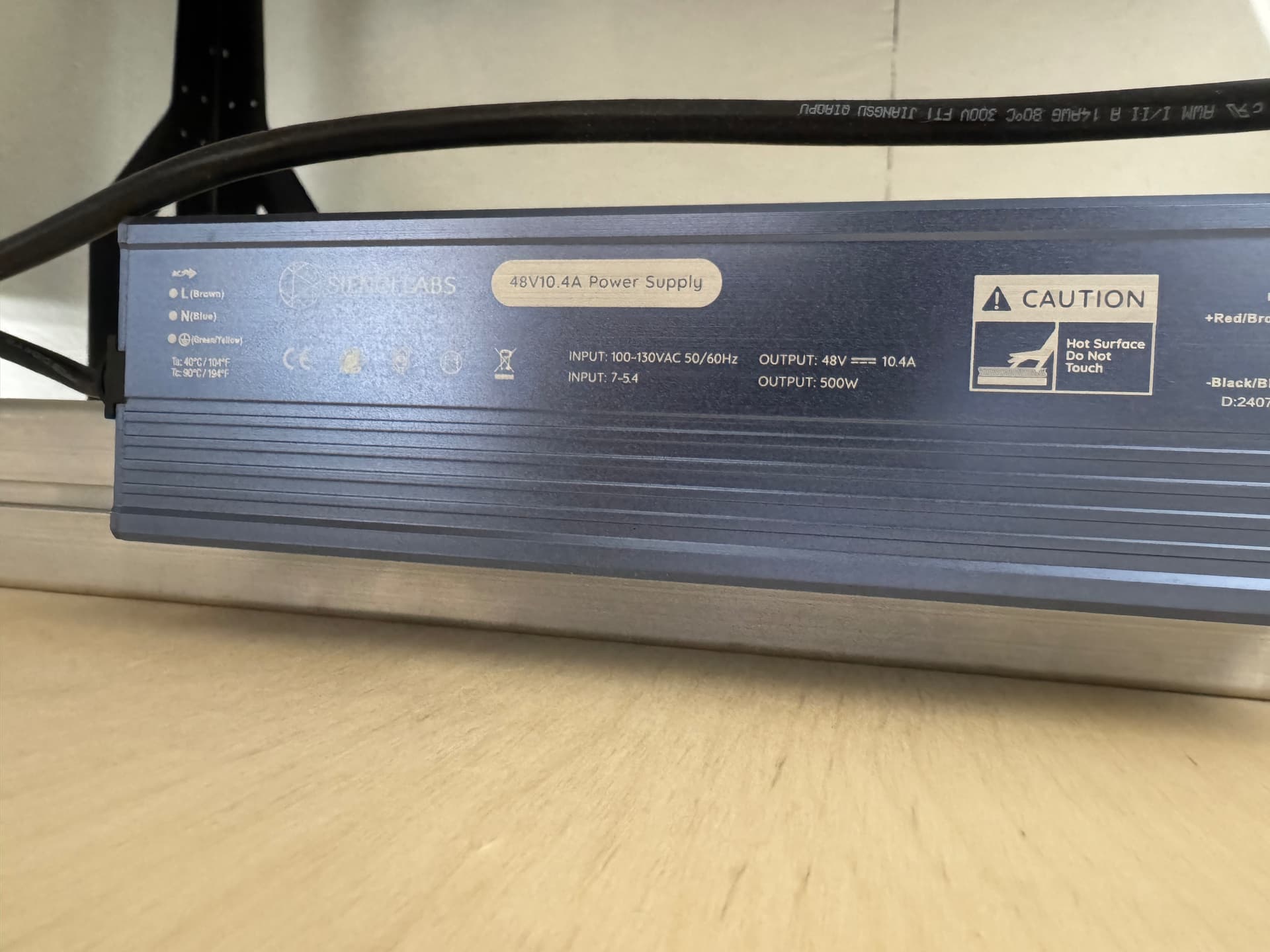

The SLB ext is a 48v board. The standard SLB is 24v. I have both. Here are the respective power supplies for them.
