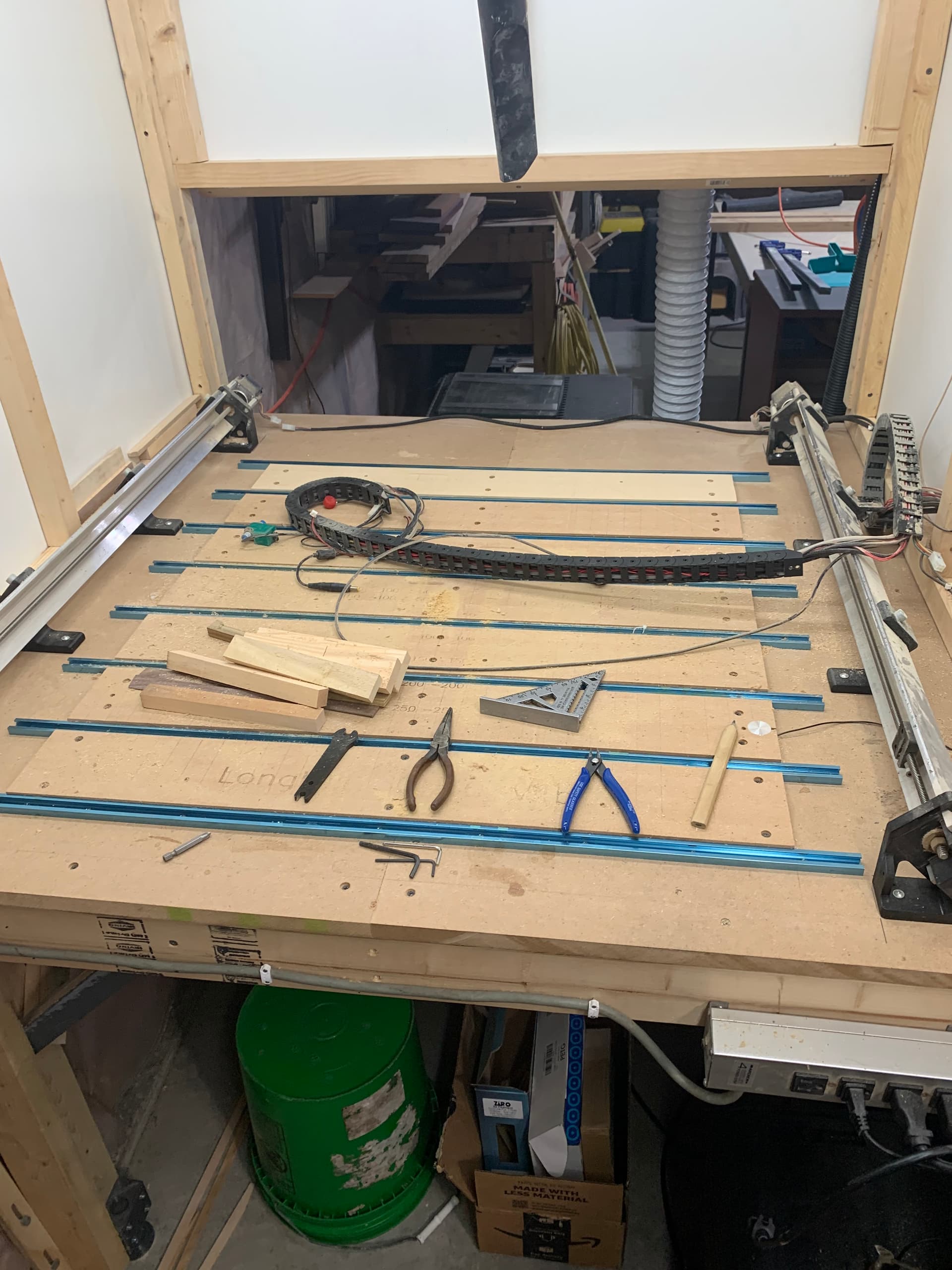

Disassembly
I decided the easiest way to break the mill down was to unplug or dismount the electronics, remove the bolts to the two anti-backlash nuts for the Y axis as well as the lower V-wheels. I set the eccentric bolts to their loosest position before removing the lower wheels. I was then able to carry away the X axis.
After that I just needed to disconnect the drag chain and remove the Y axes but first I marked my table with the locations of the corner feet.
Lift Kit
In the four years I’ve owned my LongMill I’ve learned a trick or two, mostly from the folks on this forum, thank you very much! Since the first time I saw it done I thought that mounting the mill on MDF strips with slots and then bolting it to the table was the way to go. Of course this was shortly after mounting my mill and it seemed like a lot of work when I was already under a millimeter according to gSender and my measuring skill.
I figured that if raising the mill by one strip of MDF was good, then raising by two would be even better! I had my router mount in the top position and if I moved it down it would compensate for the added thickness. But maybe the people that do this method already use the lower position? Oh well, full speed ahead! I glued up some MDF and mounted the rails using some clamps to line up the feet on the inside edge. Oh, yeah, I had cut the strips and milled the slots before taking the LongMill apart. Whew! That was a close one. I also remembered to drill the holes for the bolts in my table before the rails were in the way. Dang! I’m good!

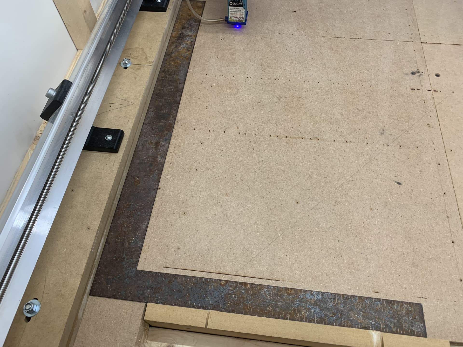

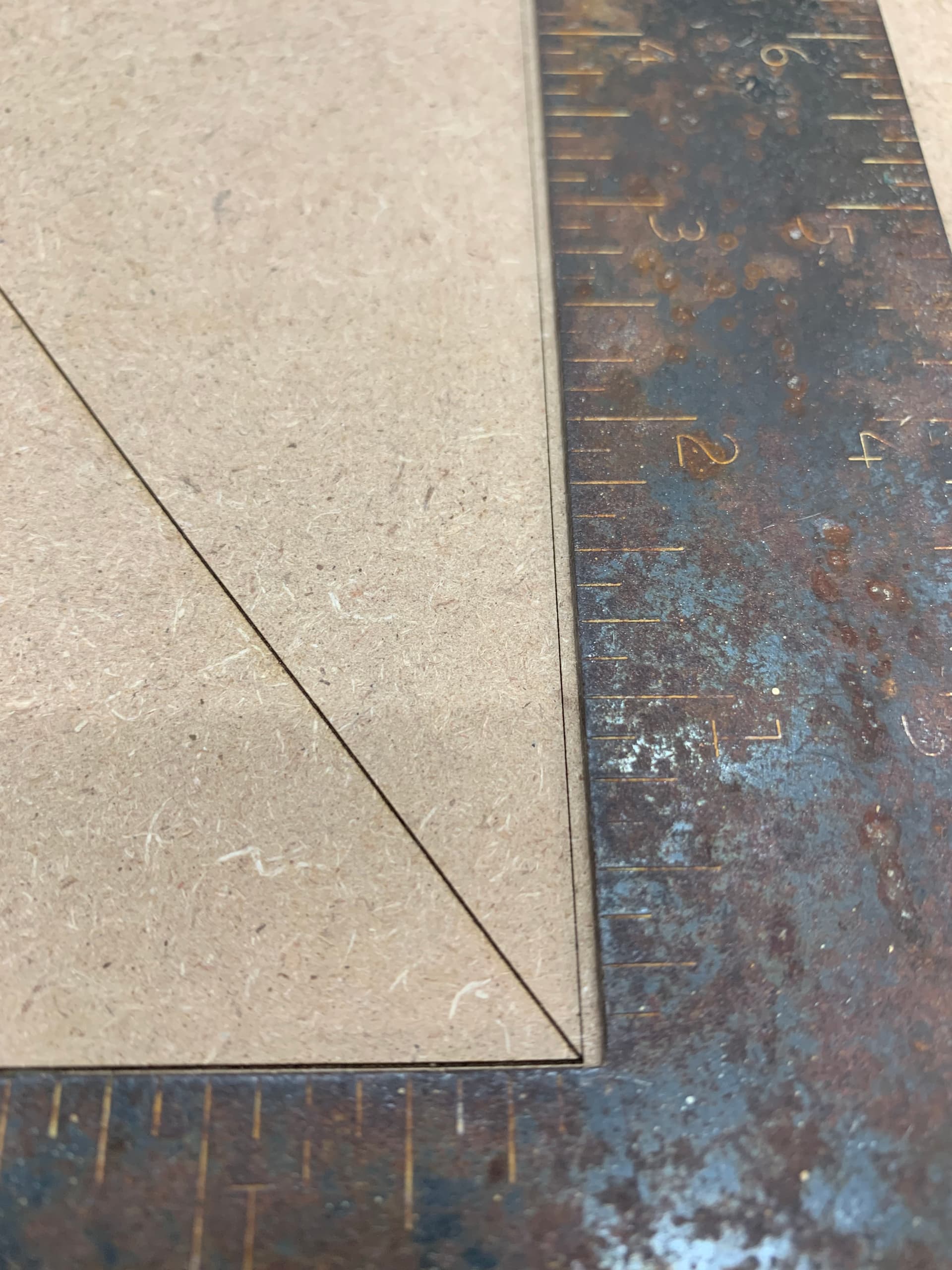

Squaring

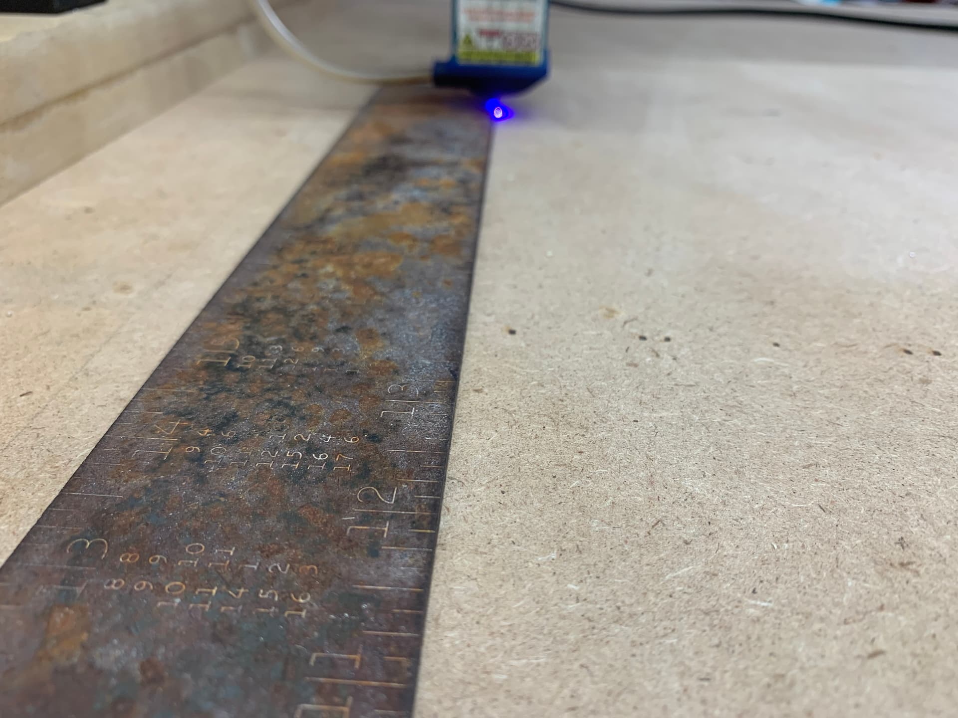

With an existing hole that I need to line up with, gSender’s squaring tool wasn’t going to be of much use. If it said to move one rail 2mm, would I need to move one by 1.5 and the other by 0.5 to end up square to the slot? I guess I’ll do it like a caveman spaceman hybrid, with a square and a laser!
Using the square I assembled the mill and left the bolts loose. I clamped a piece of MDF in the vertical mount to square against.
I then kept running the laser up and down the Y axis making numerous small adjustments to the left rail. When I was satisfied I tightened up the bolts on the left and then fired up the laser to double check. By the way, I always wear my laser glasses and I have opaque ā€˜curtains’ that I pull to protect anyone passing by from eye damage.
After that I repeated the procedure for the X axis moving the right rail back or forward as needed. I then lightly fastened the front bolt, jogged to the rear and tightened that one and so on to get the width right.
Then I burned a square with the laser to check. It’s square enough for me!

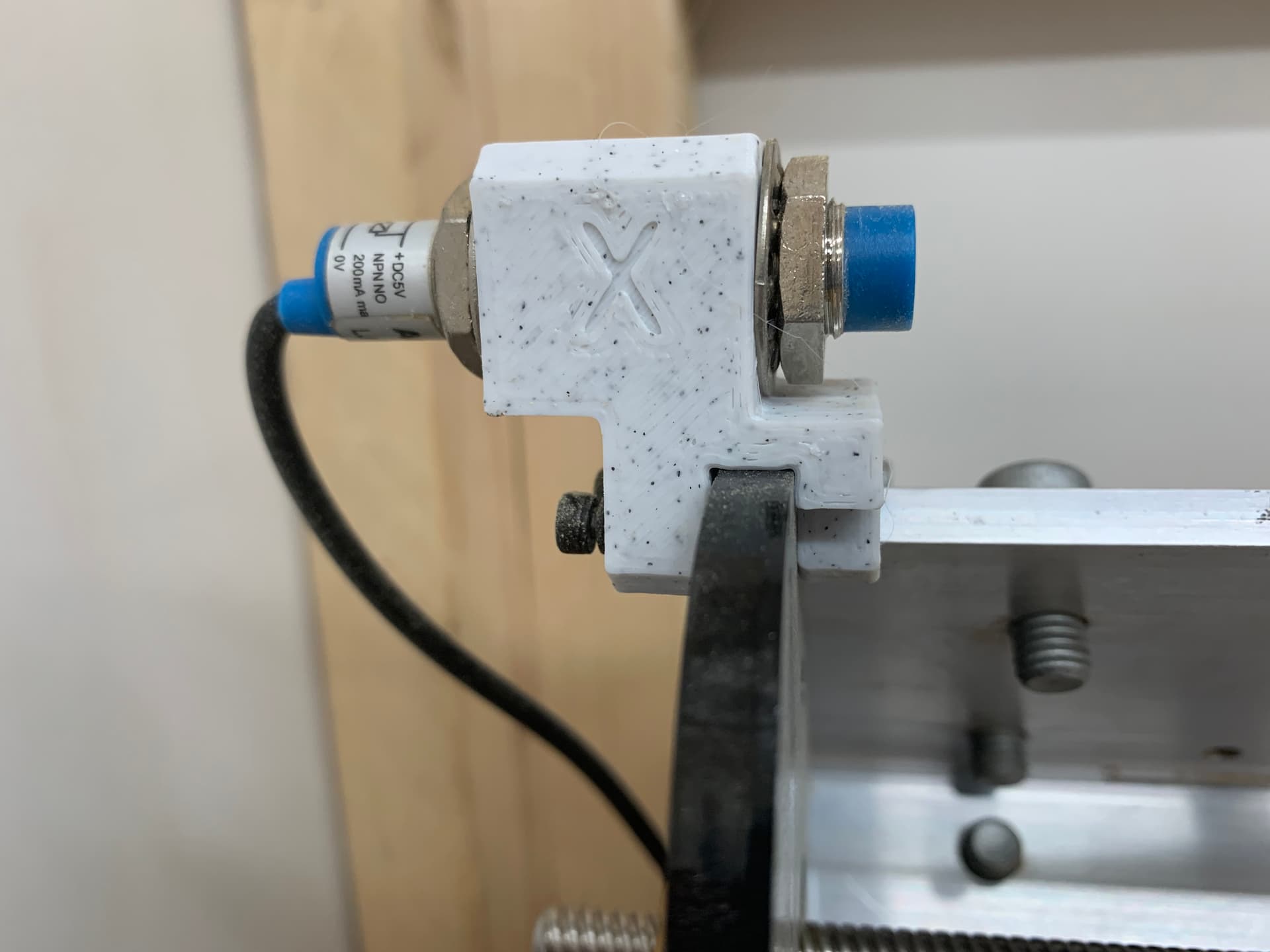

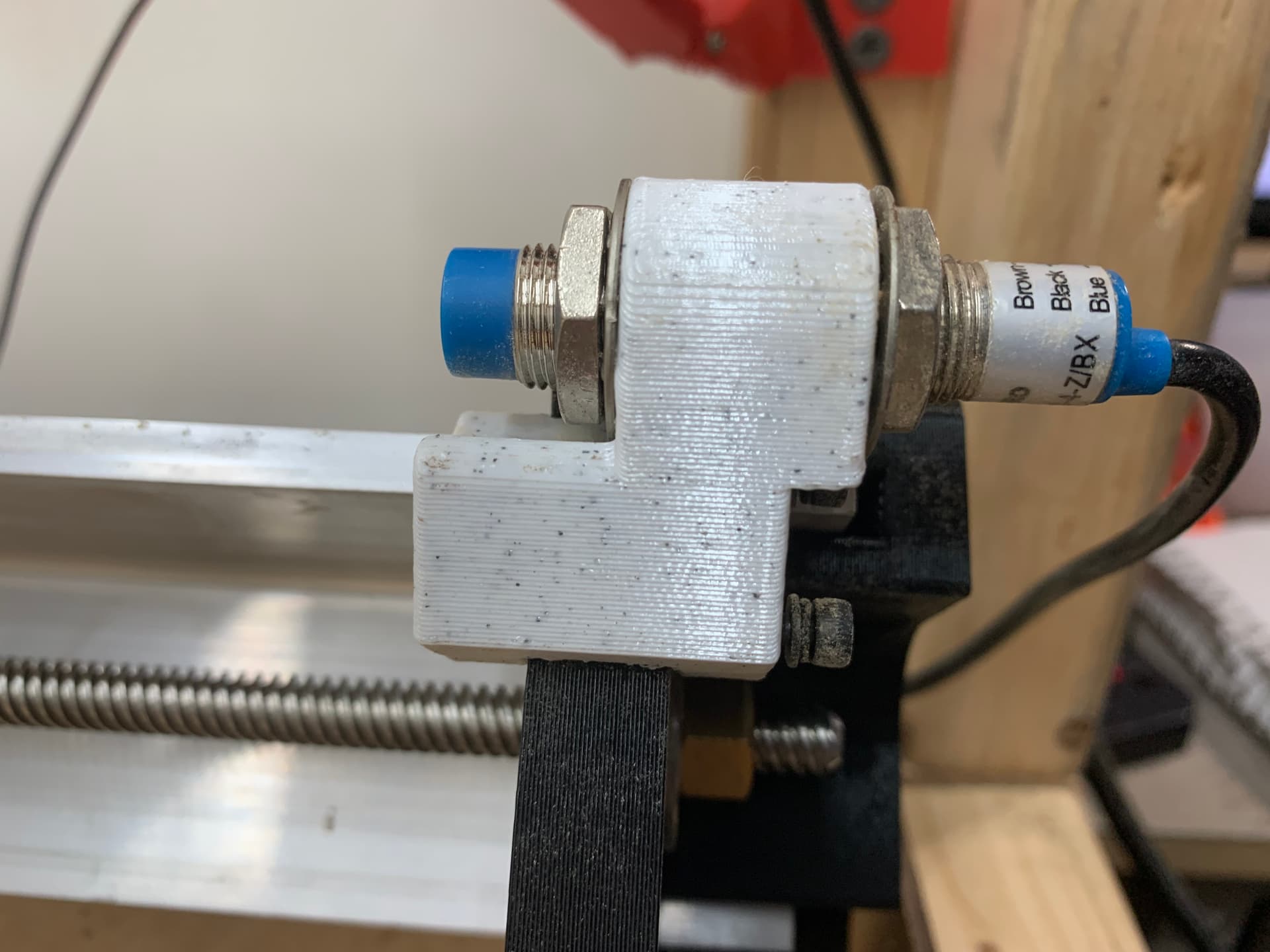

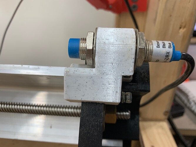

Inductive Sensor Mounts
I think I lost 10-15mm of width with Sienci’s mounts for the Mk1. A little less on the Y. With my largest project so far not coming anywhere near close to the maximum dimensions of my mill it’s imperative that I regain as much of that space as possible!
The Z mount was fine and there wasn’t any travel to be gained there. I ended up with [793, 838, 104] for my travel limits.

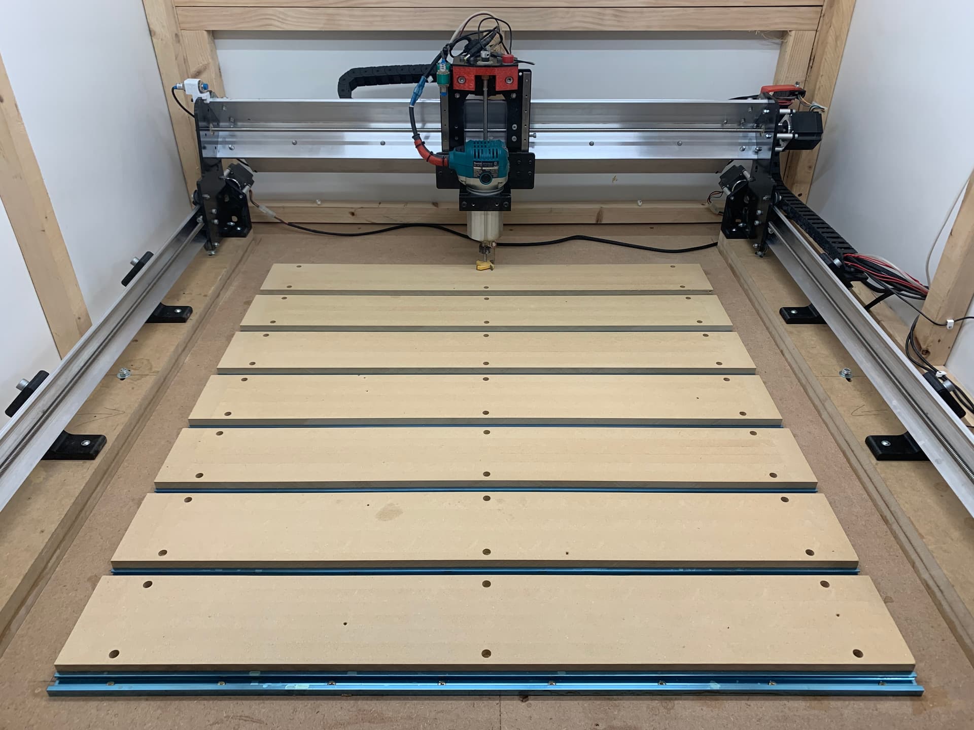

Spoil Board
My spoil board lasted almost four years but was getting a bit on the thin side for my taste. Watch the same video that I did if you want to learn how to make your spoil board last.

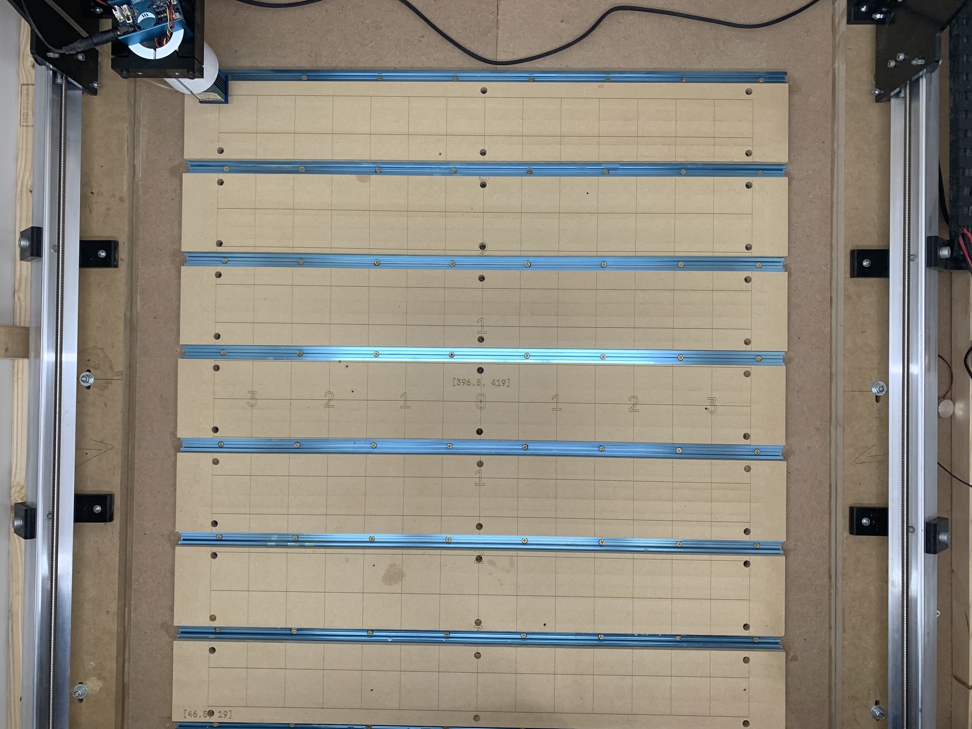

I ended up going with the same T-track design that I had for my spoil board. I couldn’t come up with a reason to change it.
OMG! What have I done? I can barely reach my spoil board! Is this my demise? Okay, I settled down after awhile, that was the whole point wasn’t it? It’s much easier to raise my work than the mill if needed. It’s not a problem until it’s a problem.

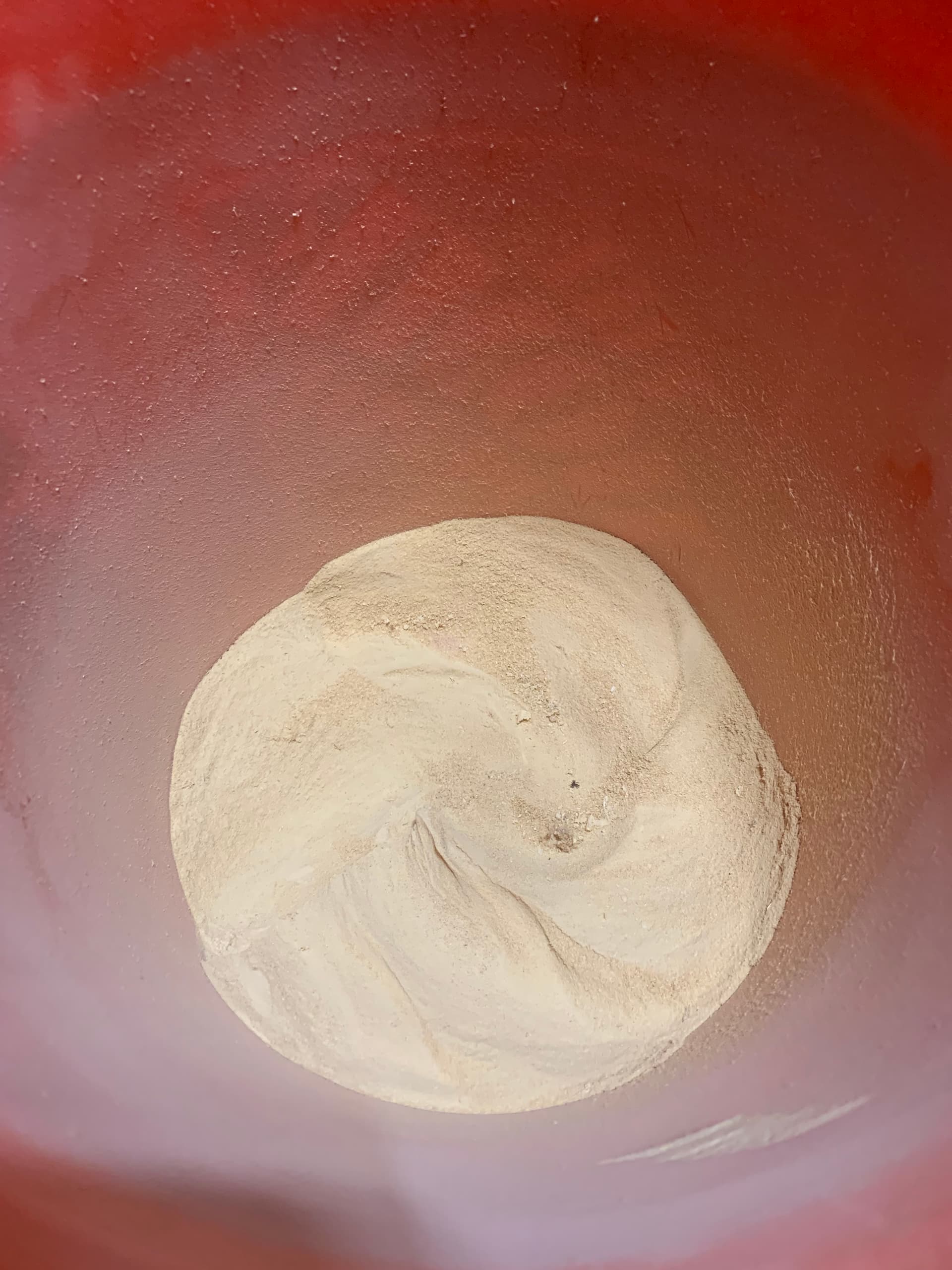

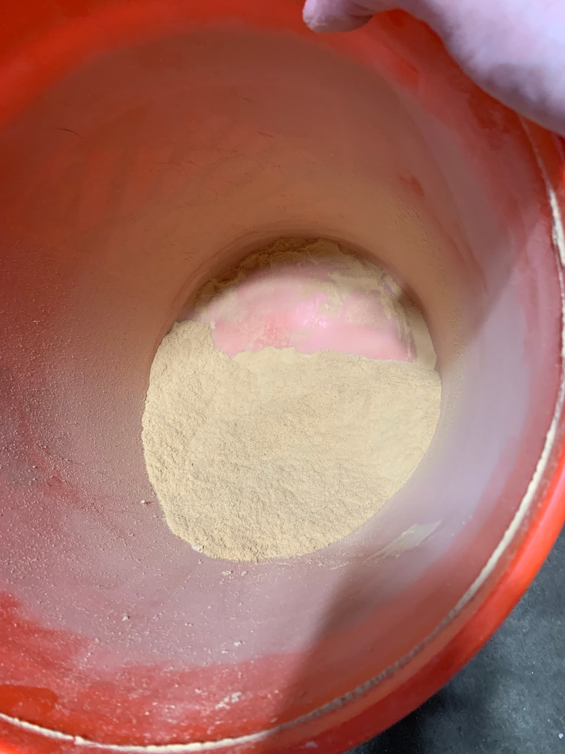

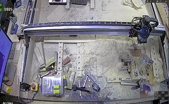

I have a DIY cyclone thingy on my vacuum that I reviewed here. Okay it’s more like a link to a video than a review. Before I surfaced I cleaned out the bucket to show how well it does on fine MDF dust.
Looks like a tornado hit a sand dune in there!
Seems like it catches quite a bit. I should have emptied the vacuum bag so I had some sort of percentage. Dang! I’m not THAT good!

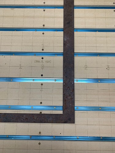

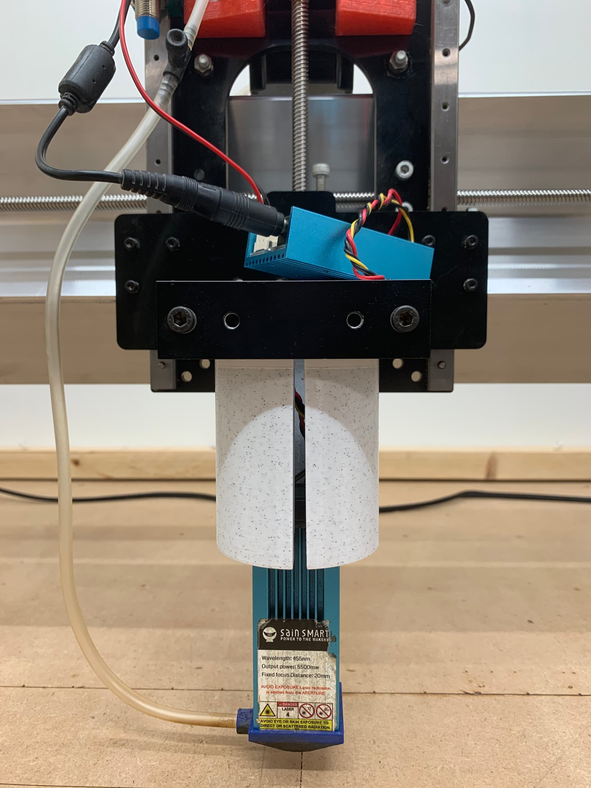

Laser Grid
I like a nice grid on my spoil board so that I can quickly get things aligned. I had to make a new mount to reach from way up here. I had made a small dot with a V bit in the center of the board so I had a mark to align the laser.
It sure is nice to have that router out of the way for this bit.
It’s good enough for the work I do! The bracketed numbers are the machine coordinates for getting to the lower left or center of the grid.

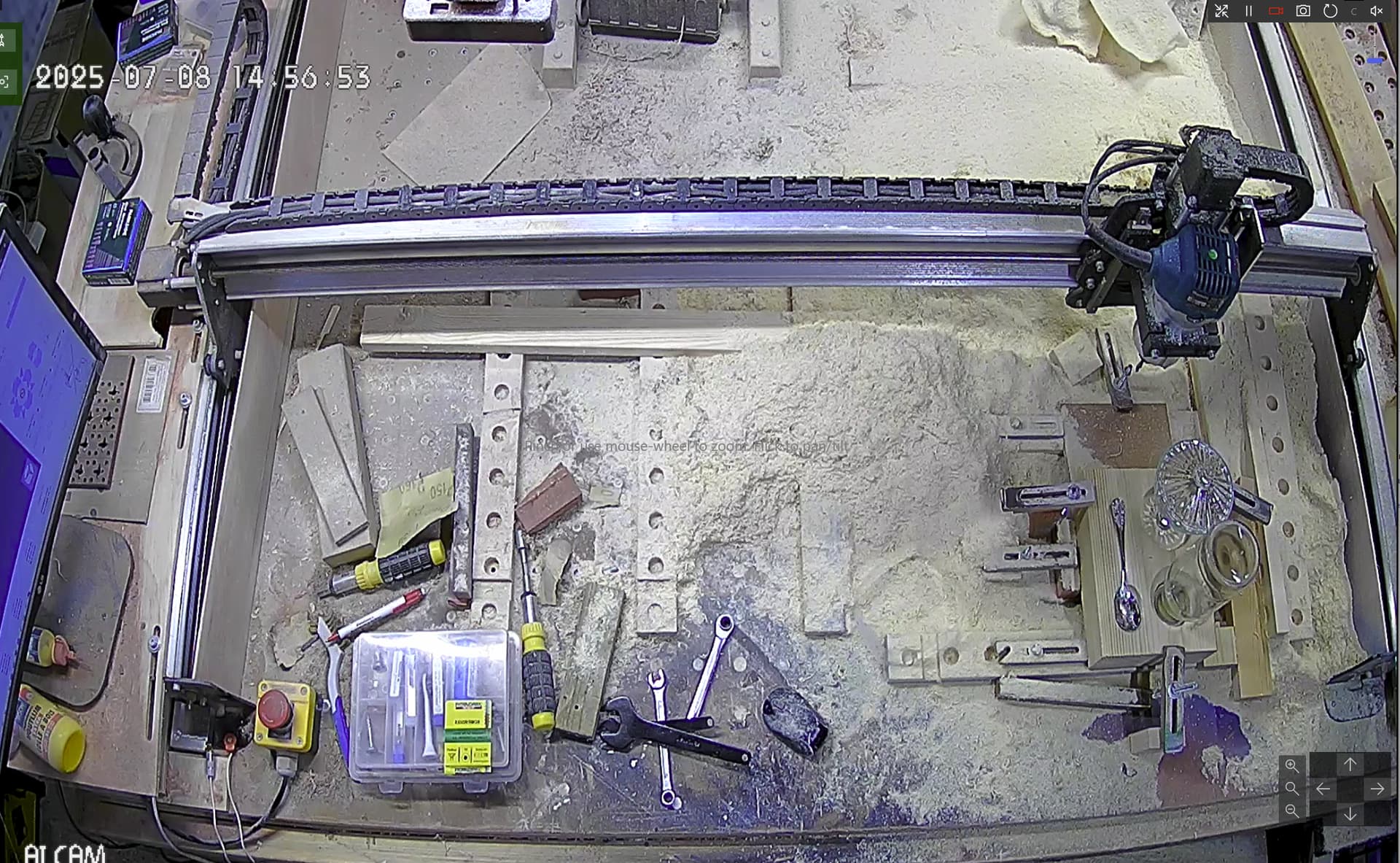

I love your setup. It’s so clean, smooth, neatly gridded. If I’d take a snap of the millcam right now you’ll see a rather different picture. Ah what the heck, lets have a laugh.
Verry Christmassy ey?

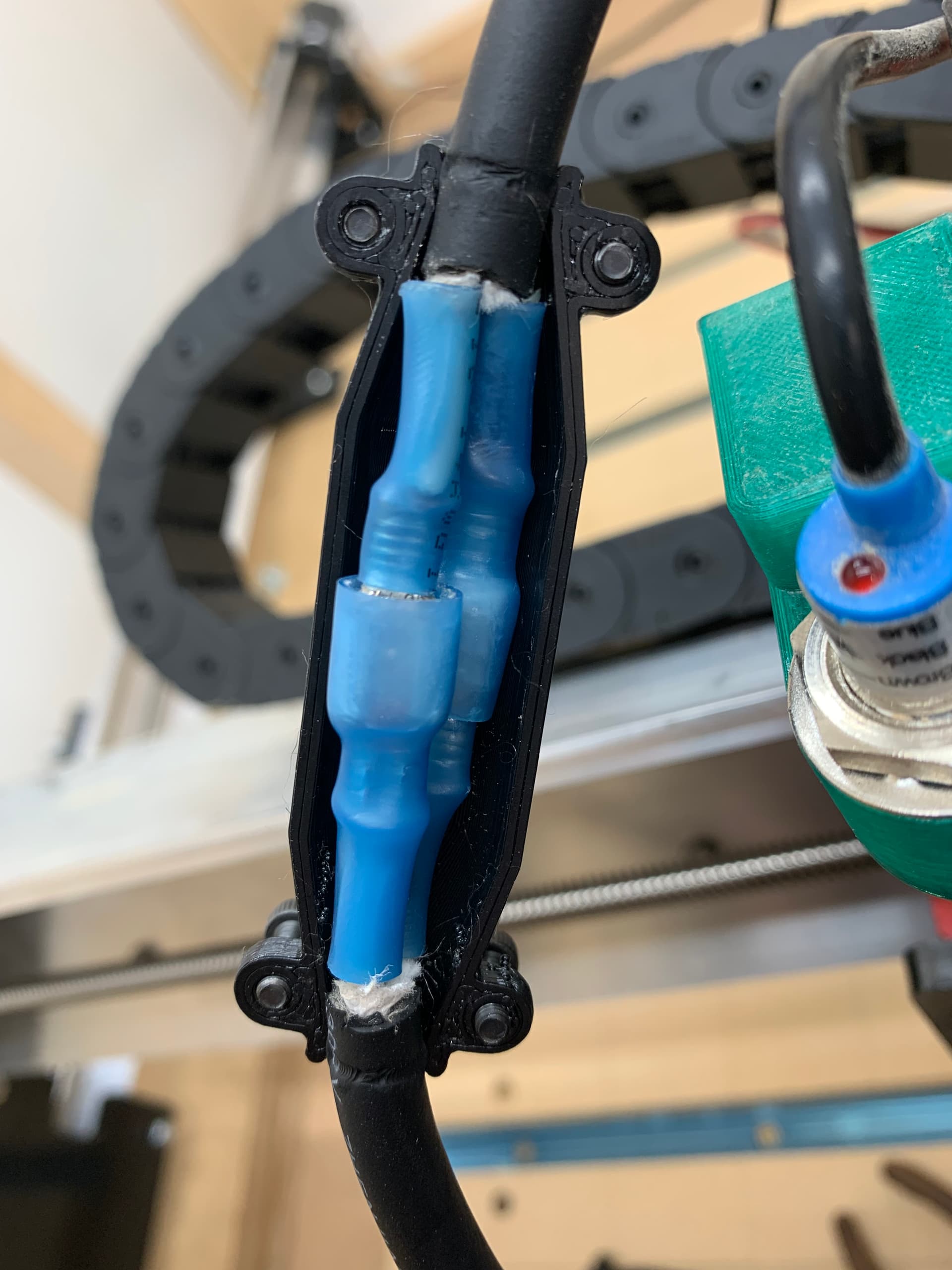

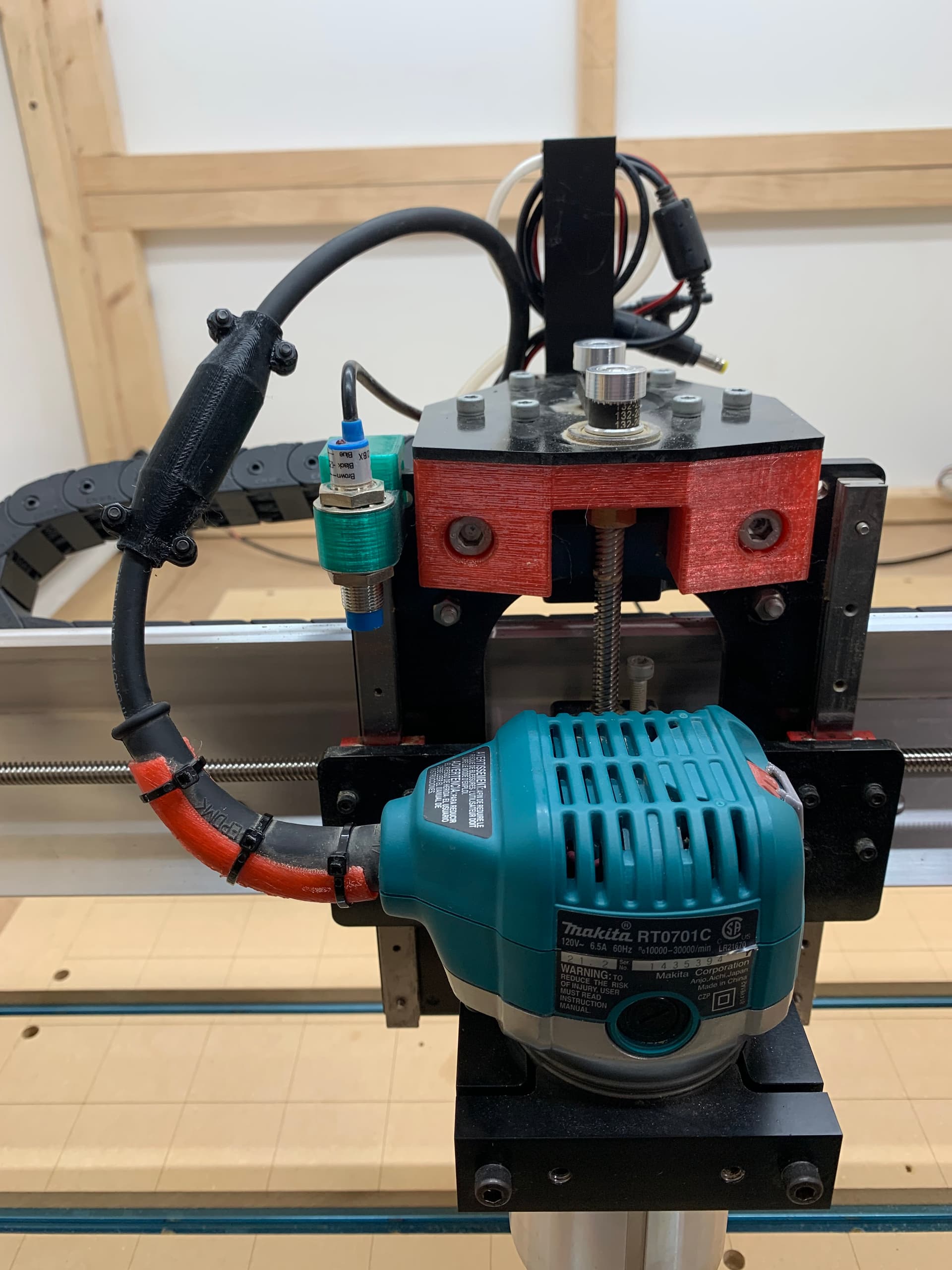

I hate to rain down on your parade, but I have to drip.. or lets call it a drizzle.. a bit on your makita setup. I know You lot have only 120V kiddy power, but even that isn’t without its dangers. I am no saint, by a long shot, and have my own -secrets that should not be installed like that- around my home, but one thing you will never see me do is making an appliance partly disconnectable.
You see, a half connected router is essential no more than a well conducting bridge. And no matter how allergic I normaly am towards whatifs, when I see AMPs used in high power circuits, my brain produces a bunch of them and most have serious answers to them.
Let me do one: What if one of the amp connectors shakes loose during operation. You have either a unprotected conductor hanging on the cable side or one on the router side. A router that can be seen as a conductor when switched on.
I assume you have the life wire on the cable side as the protected female one, but that is only when you assume the outlet is wired correctly, the connector is wired correctly and there are no other appliances active on that line.
When there are so many assumptions needed to make something safe, better assume it is never safe and when you assume something is never safe, that AMP you see there is to be seen as an unprotected life wire hanging on a aluminum framed machine that is still running and about to shake rather violantly because the bit has just stopped milling mid program.
What are the odds?
I strongly believe that there are mondays out there that would love to have this opperunity.
At least install a 30ma differential circuit breaker on the circuit this router is on, but even better would be to have/3Dprint a wee more secure way to have this router disconnectable.
[/drizzle]

No worries about the rain! I’m glad you mentioned that and I actually had half a thought along those lines. I was thinking more about if I was using it off the machine and stepped on the cord or whathaveya.
I could have done it with a replacement plug but they are so big and bulky so I chose this way in my ignorance. I’ll take your advice and make it safer even with kiddie power. In my experience it’s not too bad when it just goes up one finger and down the other but across the ticker is another story!
The last thing I would want is for someone to copy something I’ve done and get hurt. I’ll go edit in a warning above or remove it until I have a safer solution to post.
I don’t mind if it’s somewhat harder but safer to take apart. I just don’t want to deal with routing through the drag chains on a regular basis.

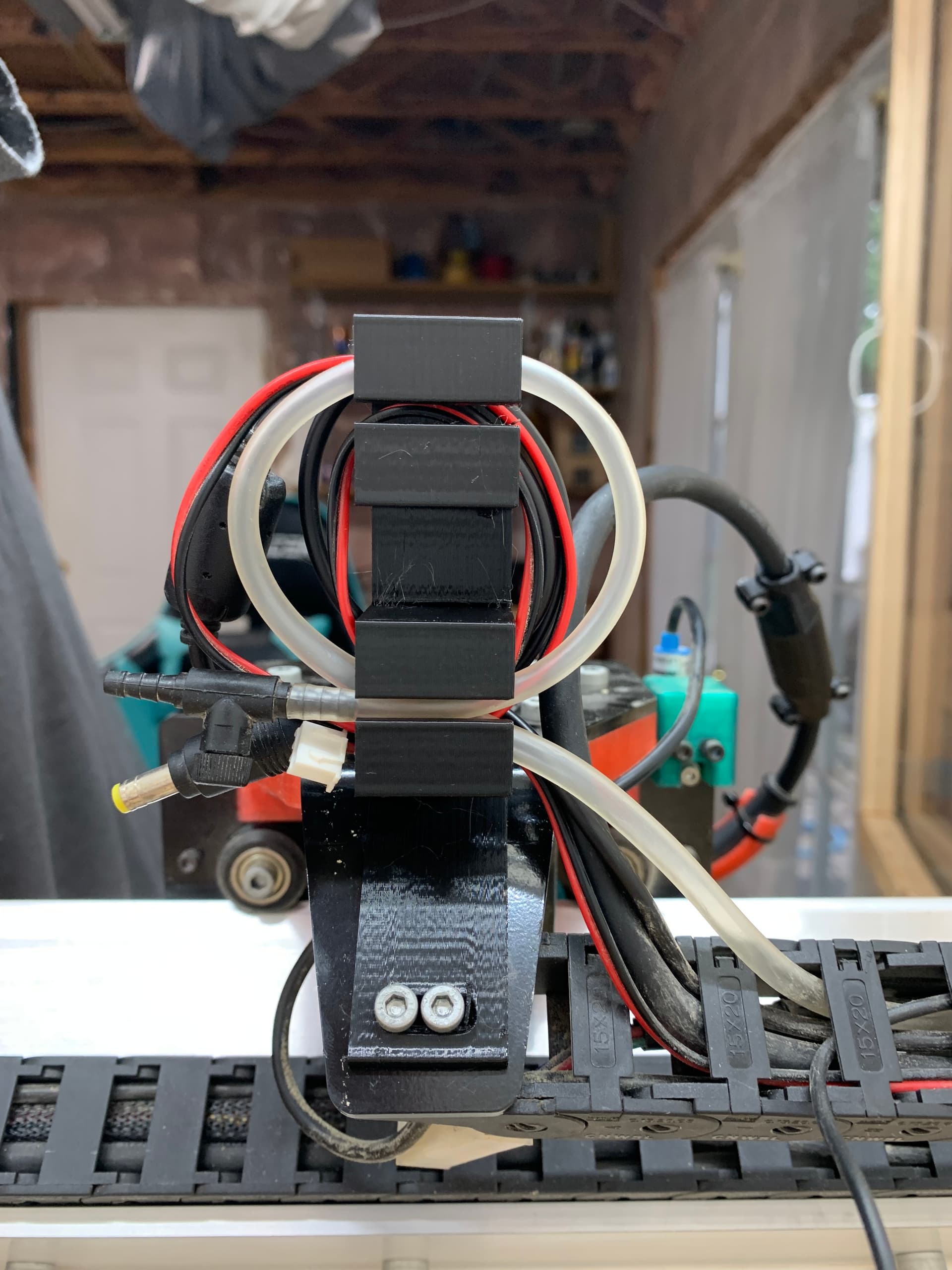

Here’s what I came up with to make the wiring safer for my removable router.
I put it together and then took it apart after it had sat overnight to check the compression fit on the cord. It looks like it has a good grip to me.
I don’t think it’s likely to snag on anything the way it’s routed. I think having the connectors in a box is good because I wouldn’t open an electrical box with checking for power first.

Thanks again for bringing this to my attention. I hope my improvements are up to snuff.
That is an awesome solution, if you don’t mind missing out on a quick disconnect. No room for shaking lose and the cables themself are now jank proof.
Kuddoes Michael.
