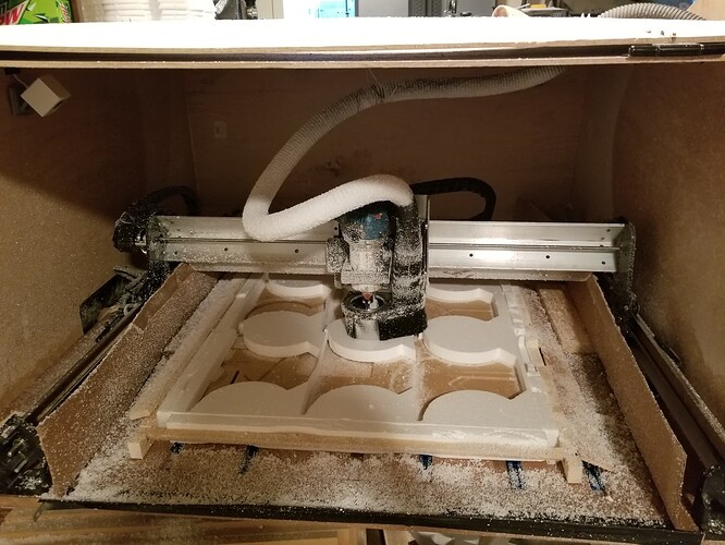

One other project from that space was some ceiling tiles. These are actually the reason my wife let me get a CNC router, as plaster tiles were going to run ~$30k for this space. Did the same pattern out of foam boards for under $150 (and only 700 hours of machine time :sweat_smile:)

Thank you for the comment, and the only issues I encountered with the foam board was the fine dust getting in the screws and causing the Y axis to bind up during the long runs (fun sounds heard by all, and the reason I now have a wifi camera watching the router with a remote stop feature). The super high tech fix was the cardboard panels between the router and the screws you can see in one of the pictures. After those went it, everything ran well.
The original router has about 1,000 hours on it and is still going strong without any replacement parts needed. Not a bad return on a $100ish tool👍 That being said am pretty religous about fully vacuuming it off after every run, or even mid-run on the larger tiles which go for 6.5 hours.
