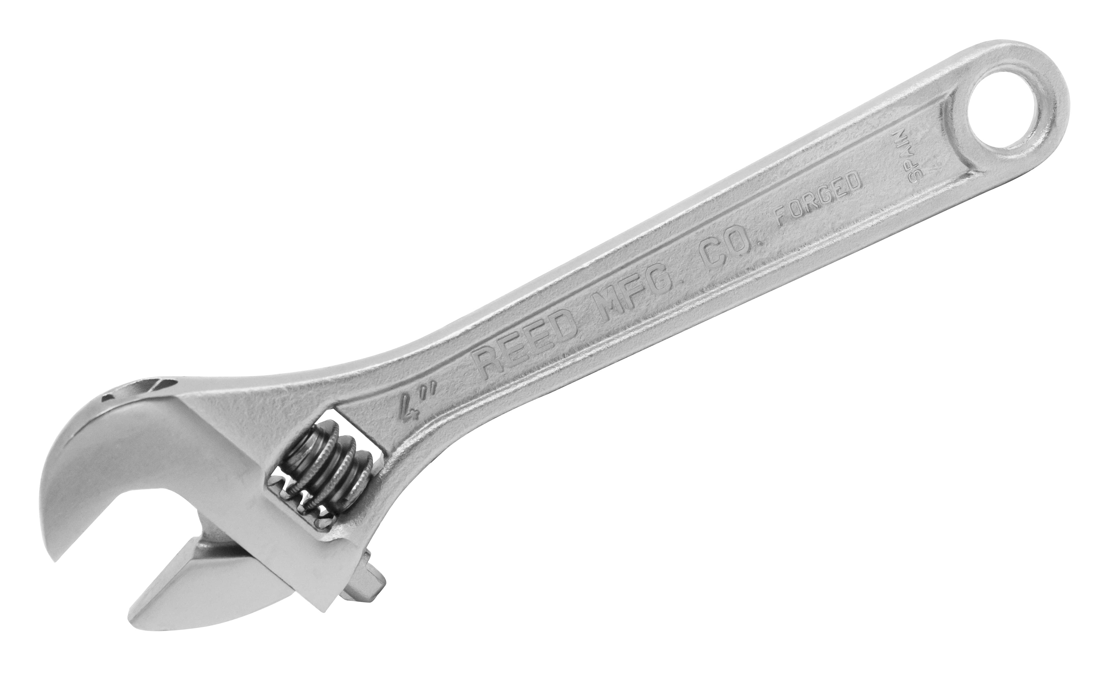

If you have two of these you might be able to work things out for the time being. Measuring the beaks when they fit best will give you a good indicator on what wrenches you need.
Maybe I should have gotten wrenches, but I didn’t. All I have is that multi-wrench tool that came for assembly of the machine.
I can use adjustable wrenches and I am right now. I just wanted to buy a little bit better tools for that operation.

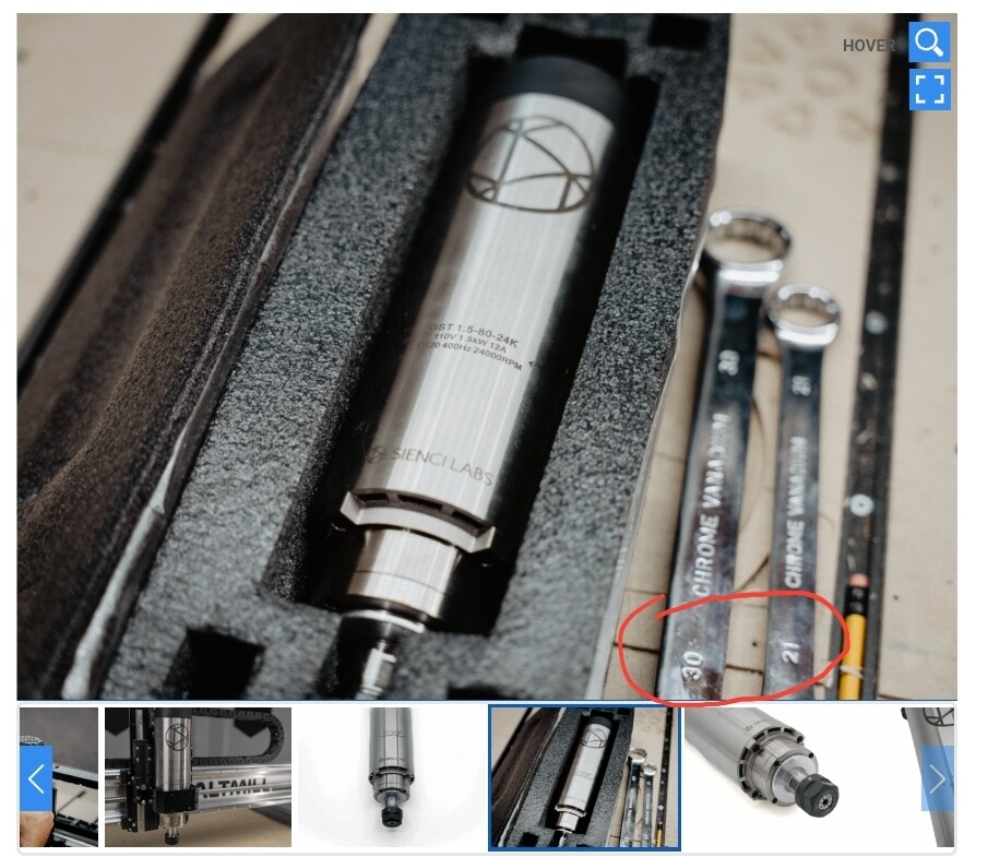

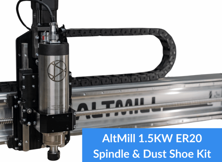

Once you diled in the adjustables, you can measure the width of the clamps and know what wrenches to get. If I look at tne pictures of the 1.5kw spindle unit with an er20 collet I find this picture.
Found here:
And with a bit ‘o’ luck someone with an altmill chimes in and might give some more useful information on their wrench set.
If you didn’t get wrenches in the spindle box (not the Altmill packaging) then contact Sienci. The spindle comes with two wrenches, three collets and a collet nut.

Just to clear things up, After pouring though everything I did manage to find two flat wrenches marked 22 and 16 on them. These fit the spindle. Sorry for the confusion.
I’m assuming these are 16mm and 22mm respectively. I’ll measure them for a double check before I buy some nicer wrenches.
