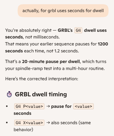

I went through the g-code and understand what it does. I also asked Copilot and it confirmed what I was thinking. What I’m unsure about is how long does it run at each speed. Nothing in the g-code seems to indicate a length of time , except for the 1200ms dwell between each speed. The Altmill instructions state that this file will take 100 minutes to run, so I’m guessing about 20 minutes for each speed.

G4P1200
G4 is a dwell command, P is seconds - 1200 seconds is 20 minutes.
It changes the speed, dwells for 1200 seconds, then proceeds to the next speed change.
@KGN yah, I was just about to edit my reply after I realised that 1200 is in seconds not ms like copilot told me. Had I made the mental conversion of 20 minutes = 1200 s a bit sooner, I would have figured it out without Copilot’s “help”. But I hadn’t read the Altmill guide at that point and didn’t know the file ran for 100 minutes.
It’s sort of non-standardized unfortunately. Grbl/grblHAL are seconds. This is in-line with the linuxCNC implementation.
Others are ms, others have P for MS, S for seconds (like Marlin/RepRap) - it really just depends on how your firmware interprets it.
I can see how AI might get it confused at least.
Just for fun, I told Copilot that it was GRBL g-code. It said that it’s analysis of 1.2 s was still correct but that some post-processors use seconds instead of milli-seconds.
I then told it that grbl actually uses seconds for dwell and it said:
After closing Copilot and asking the same question again, it still gave me 1.2s.
