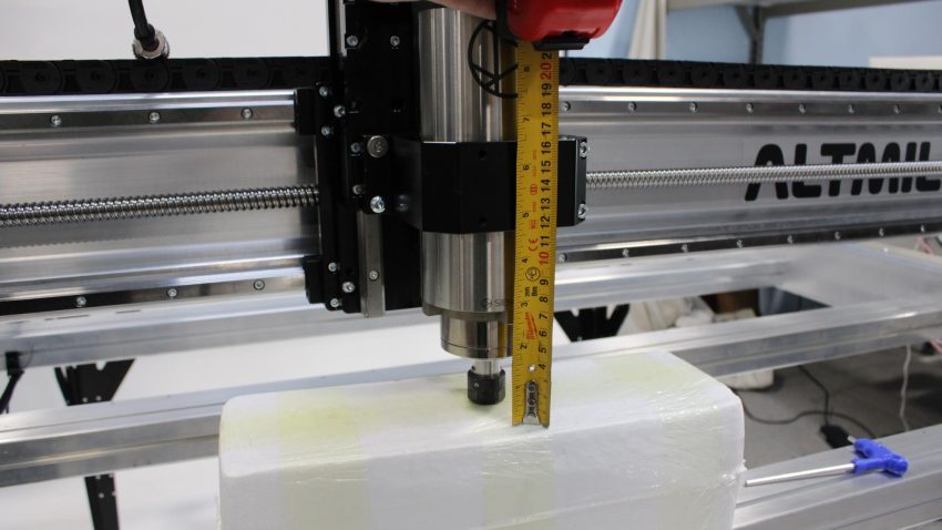

I have the AltMill 2.2KW ER20 Spindle & Clear Cut Dust Shoe Kit and have installed it per the instructions-7. Wiring and Spindle - AltMill CNC

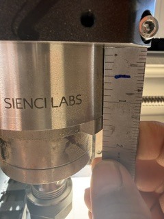

However, I have noticed that mine appears to be mounted higher than what I see in the instructions. Unfortunately, I have discarded the packaging so I have no way to check the method outlined in the instructions. It would be nice to know the dimension from the mounting collar to the bottom of the housing. I measured mine and it is 1.250". Can someone confirm for me what the correct dimension should be, please?
The reason this has come up is because I am concerned that when I mount the dust boot and try to machine a 48" wide board, I will suffer a crash of the dust boot into the side of the machine. The Altmill 4x4 has a cutting area of 1265 x 1251 x 174 mm (49.8 x 49.25 x 6.8″) but I am unable to find a reference if that is with or without the dust boot attached.

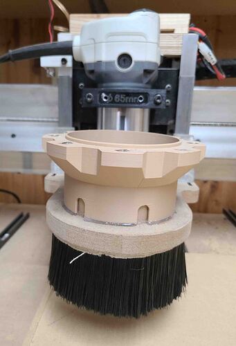

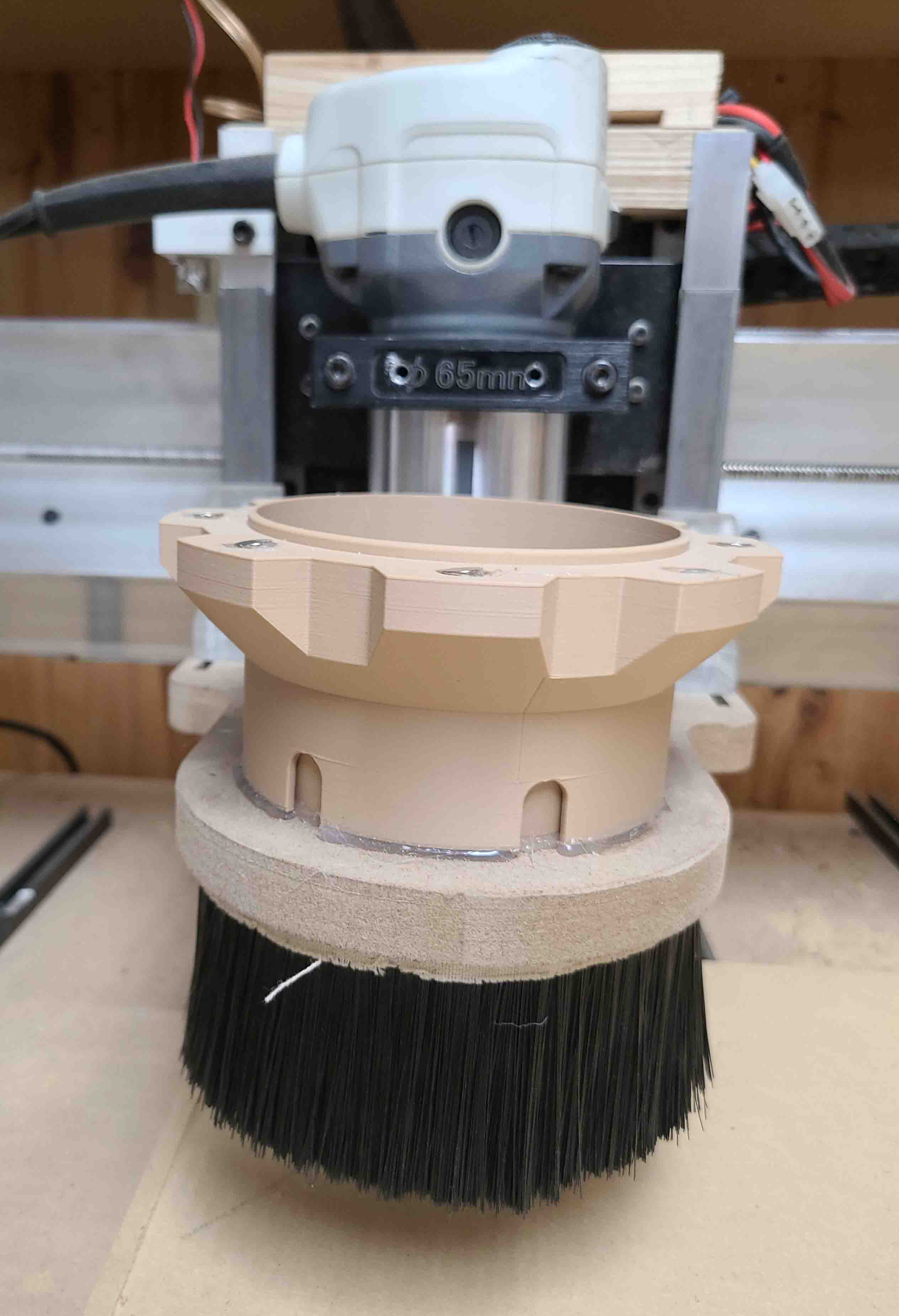

@Chucky_ott As you know CO, I have a long mill, not an altmill. I gave up some time ago on the Sienci offering for dust shoes. I’m on version 4 of my home-made ones and I think this one is a keeper. It takes way 1/4" of each side of the X travel, uses a 4" dust collection hose, is uglier than sin, and sucks up darn near everything.
Pictures or it didn’t happen …
@Chucky_ott well if you come up with a design, let me know and I’ll print one up and send it to you :grimacing:

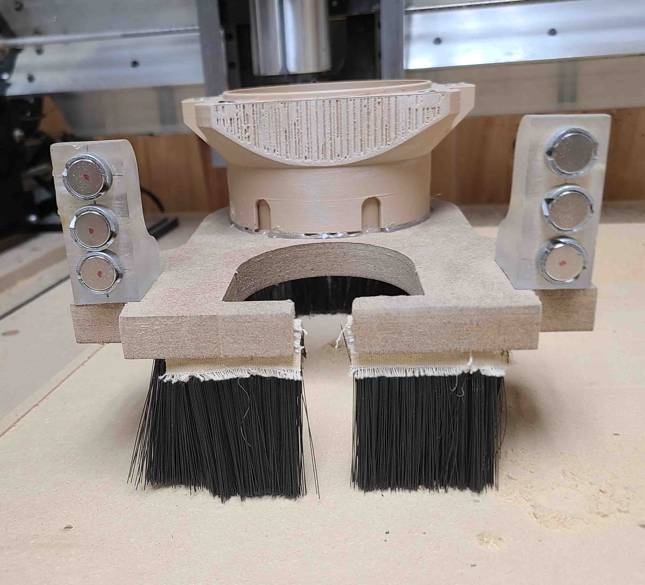

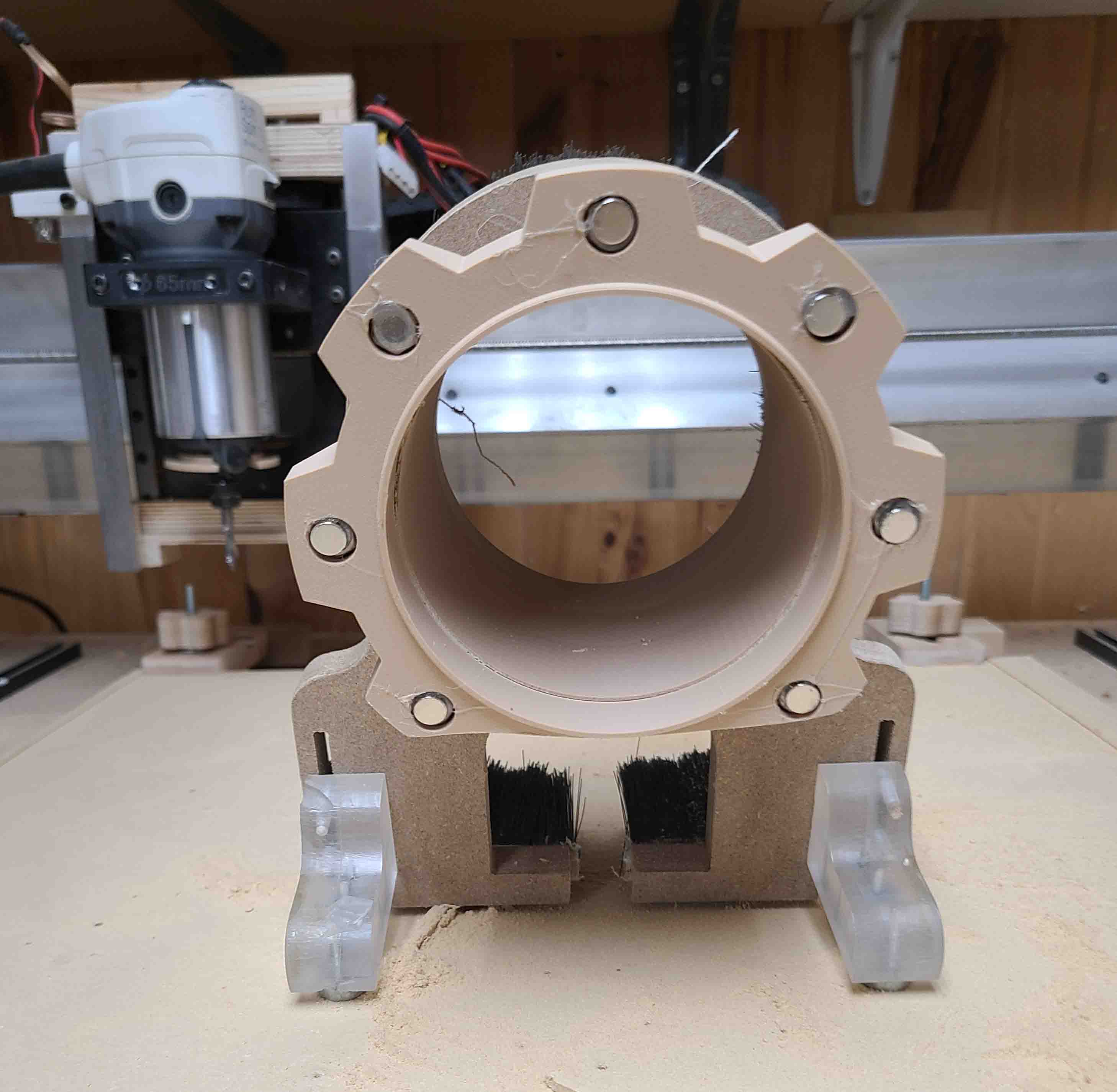

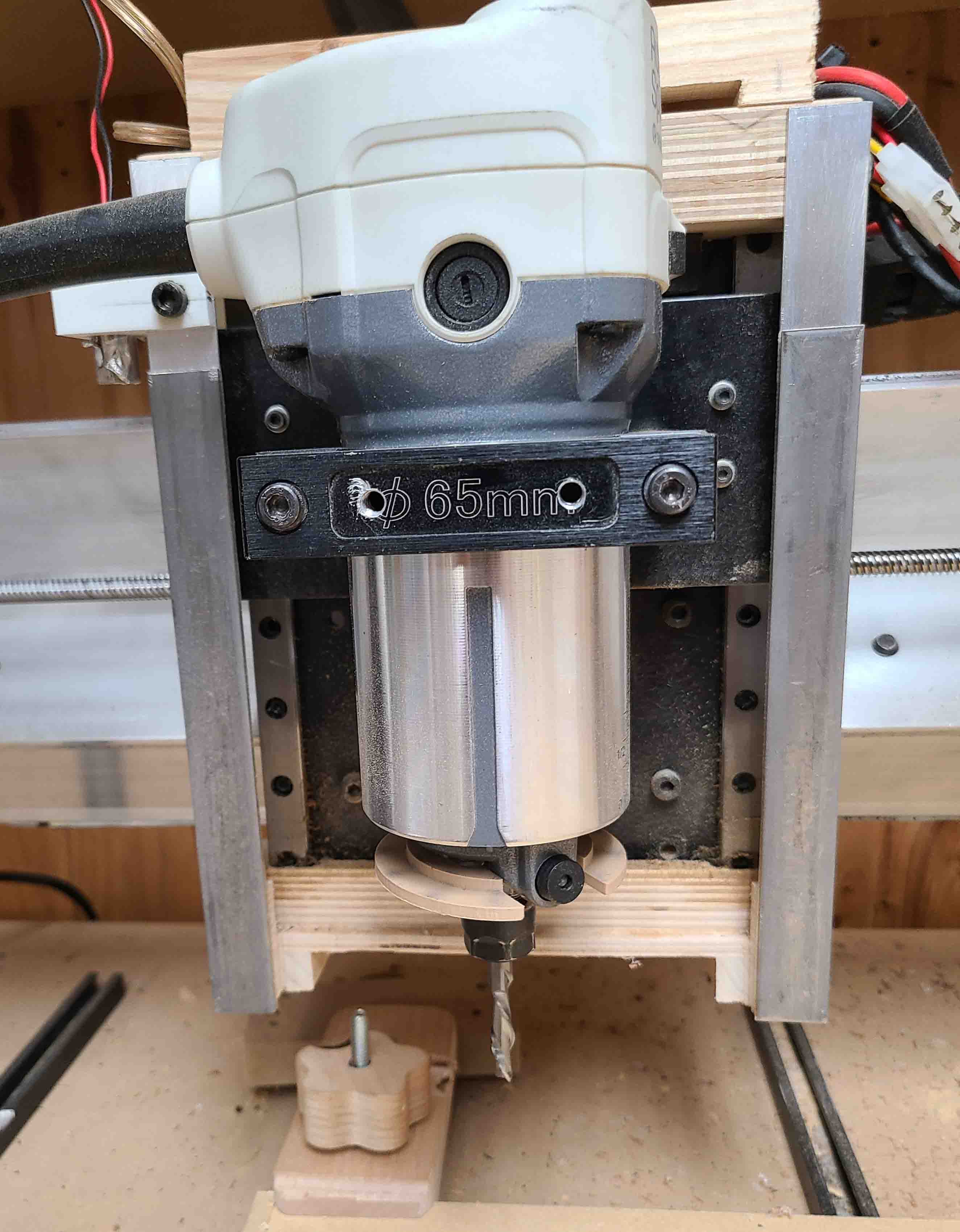

I want the record to show that @Jens asked for this. :grinning_face: As I told @Chucky_ott, this is ugly and eminently functional. I tend to favour function over form.
This is a Z independant dust shoe. The AutoSpin moves up and down within it. It does not move.
The horizontal bracket members are baltic birch plywood cut on the LM. The vertical rails are thin aluminum angle, attached to which are thin pieces of steel flat bar. It is these aluminum angles that hold the wooden members in place and vice-versa.

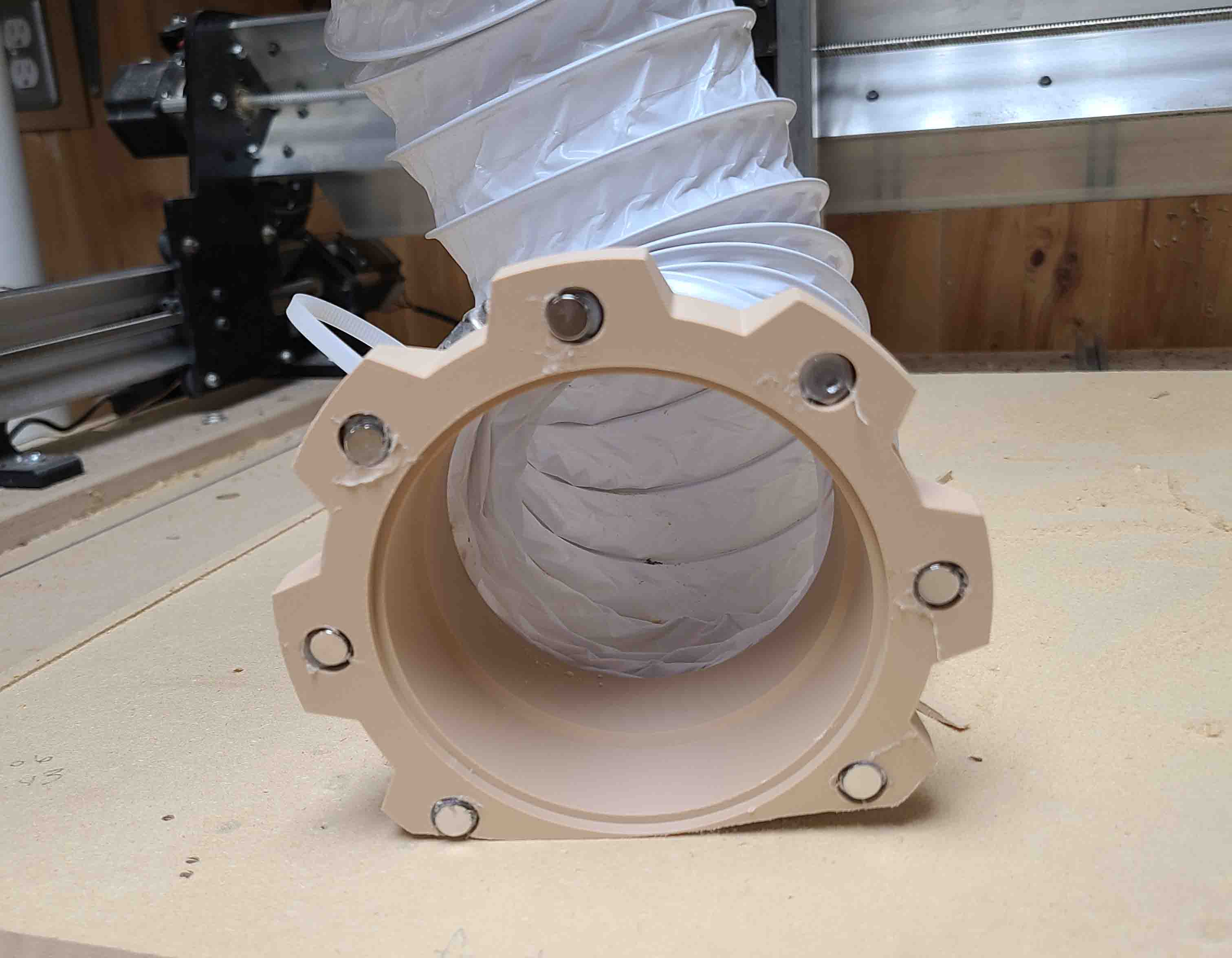

The shoe is a mix of acrylic, MDF and a 3D printed magnetic hose connector. The magnets on the brackets shtick to the steel flat bars on the bracket.
The 4" hose end has magnets that shtick to those ont the shoe. This makes removing the hose very easy.
That’s it. Remember, I did warn you all.
3 pics in this post. 2 more in the next post.

I tried several different versions of home-made dust shoes. I also tried 2 different ones from Sienci. I didn’t like losing so much X travel with the Sienci one. Also, it would not take the 4" hose. My previous versions didn’t take the 4" hose either. This one takes the 4" hose and I only lose 1/4" of X travel.
I’ve only been using this one for a couple of months now, but so far, I’m happy with its effectiveness and setting it works well. Like you, though, I always like to see what is available to see how I can improve.
