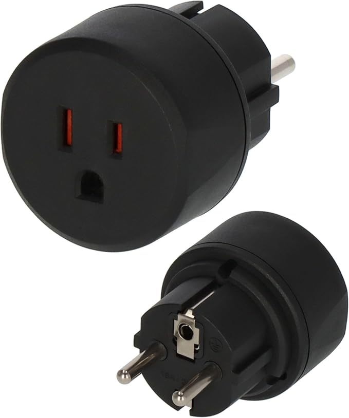

If I go for the Altmill route, I’d like to combine it with a plug and play spindle. So Sienci has the AltMill 2.2KW ER20 Spindle, that requires 220V input. When I connect this spindle here, using a travel adapter like this one:
is it going to work?

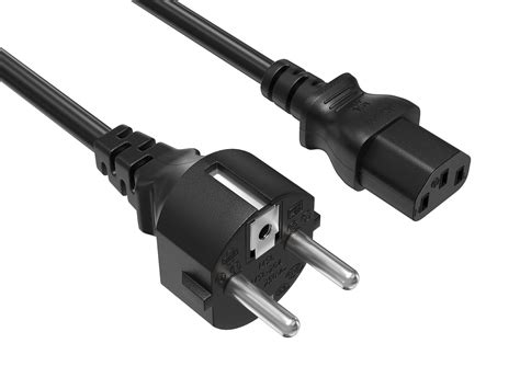

The 2.2kW spindle uses a power cable with a C13 connector on one end and a NEMA 6-15P connector on the other end. The 15 refers to the amperage required (15A). Instead of using an adapter, I’d probably replace the cable with one that has C13 on one end and whatever you need on the other.
If I were Sienci, I’d start designing my electronics so that they work outside of North America.

I wouldn’t go for an andapter using powertools. You are introducing a critical point of failure where there is no need for one. Sure it will work and maybe it will work for a good while but you are a wee tickeling your lucky charm with this one. 2200Watt isn’t your run of a mill toothbrush allthough I bet someone of whom we are not gonna tell my name has thought of it. It just isn’t, trust me bro. It’s a fire hazard waiting to bare fruit smack in the middle of a woodshop.
But, you are in luck.. any North American kiddypower cable can be replaced by a grownup one.. like tha chuckster allready pointed out. Just make sure the appliace is grown-up power rated.
https://www.allekabels.nl/230_volt/apparaatsnoer/c13.html
Allekabels.nl is je vriend.

Good to know the spindle is ok to use without a converter! I’ll for sure buy a cable, not a travel adapter.
