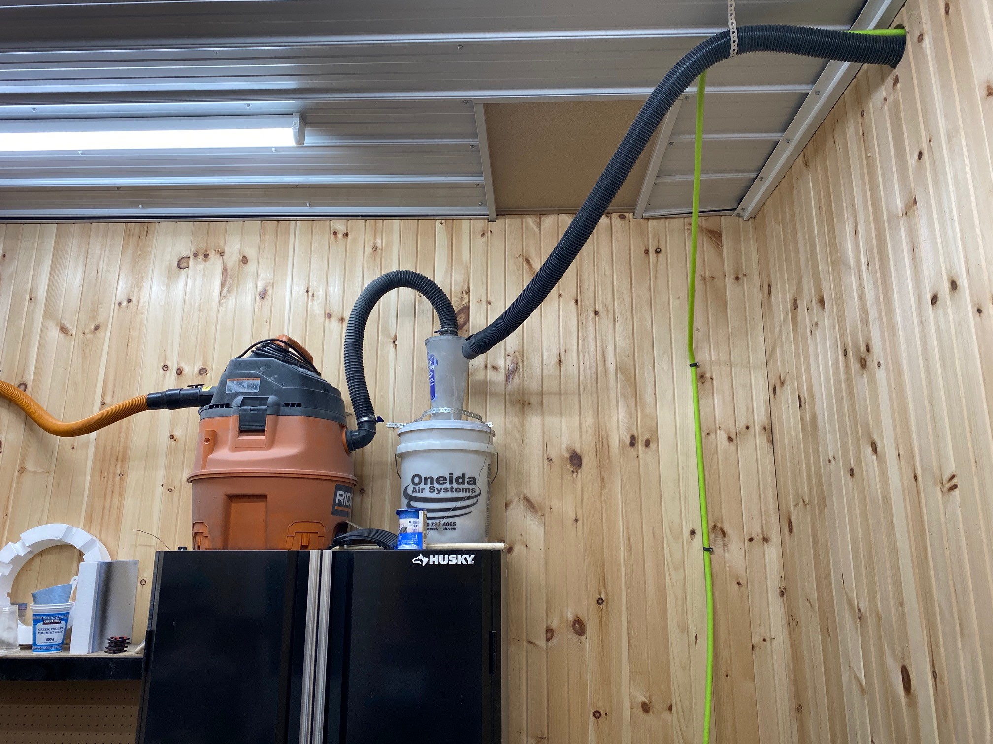

Ok- so I ran the g-code from Intuwiz but this time just an air cut…ran flawless. I’m leveling end grain on beech wood cookies and not MDF, so not sure if that is relevant or not. My dust system is in another room but not specifically grounded. The shop vac is sitting on top of a metal cabinet and piped using small plastic pipe to the Longmill. Seems odd that it took the larger bit to cause this problem but I do wonder if I was on the edge before to having problems even with the smaller bits because there were times in the past that after a longer carve I would get a slight static charge when I shut the router off-maybe should have been a clue! Since this seems to be narrowing in on the problem do you suggest I ground the Longmill or the dust system (or both) and is there a preferred way to do this? Thanks for your help.
@Botanywood You should look to grounding the dust collection. Assuming that your flex hose does not have a metal wire in it, you can simply wind a non-insulated wire around it. Attach the wire to the “router end” of the hose with a screw through the hose. Wind the wire around the hose up to the shop vac. Then attach that end of the wire to the ground How you do that really depends on your set up. In my case, I just attached the wire to a male plug. I cut the two power lugs off the plug so that all that remained was the ground lug. I just plug that into the power bar that all my Mill electrical is plugged into.

@Botanywood That flex hose looks the same as the one that I am using. It has a metal wire running inside it. If I were you, I would bare the end of the wire at your blast gate. Attach a bare wire to it and wind that bare wire around your rigid pipe and the flex black flex hose until you can attach the bare wire to ground.

I thought I would follow up with what seems to be the final fix on this for me. Much the same as what @Bill and @gwilki mentioned. I ran the ground wire inside the first flexible length and then ran outside wrapped around the rest of the run to a ground. Been running a few different jobs since this was installed and no issues with static and more important- no random stopping. Thanks again everyone for the help…and thanks @Bill …Sienci friends are always welcome in my shop! Here are a couple pictures of what it looks like now…
