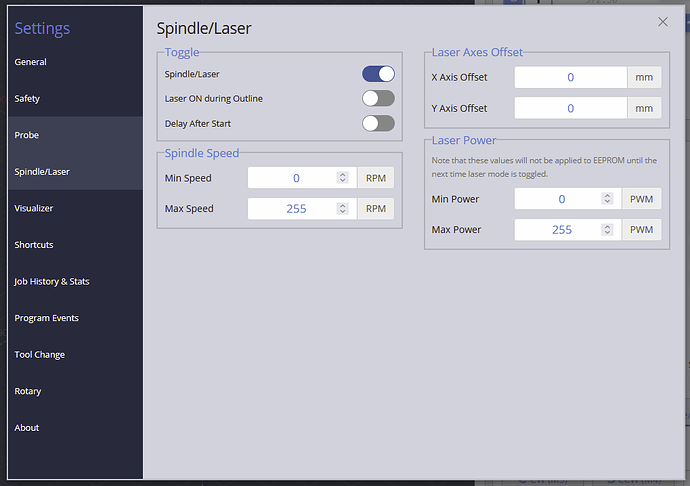

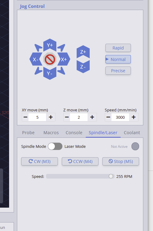

First time poster and CNC nube - Using g sender surfacing tool for first time - I can create file and CNC will move, but canโ€™t get spindle to turn on. Is there a setting I need to adjust in firmware ? Or do I add in some code? I have tried using the touch screen to turn on spindle before starting file, but it turns off as soon as the file starts.

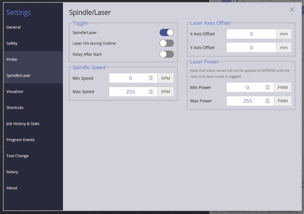

I connot test this for I have no Spindle, but having a spindle in stead of a router require to have spindle/laser mode read as true?
IT will give you an extra buton to select if you are using a spindle or a laser module.
But, I might be wrong here.
Thanks that worked! Was confused thinking it was just for laser operation.
