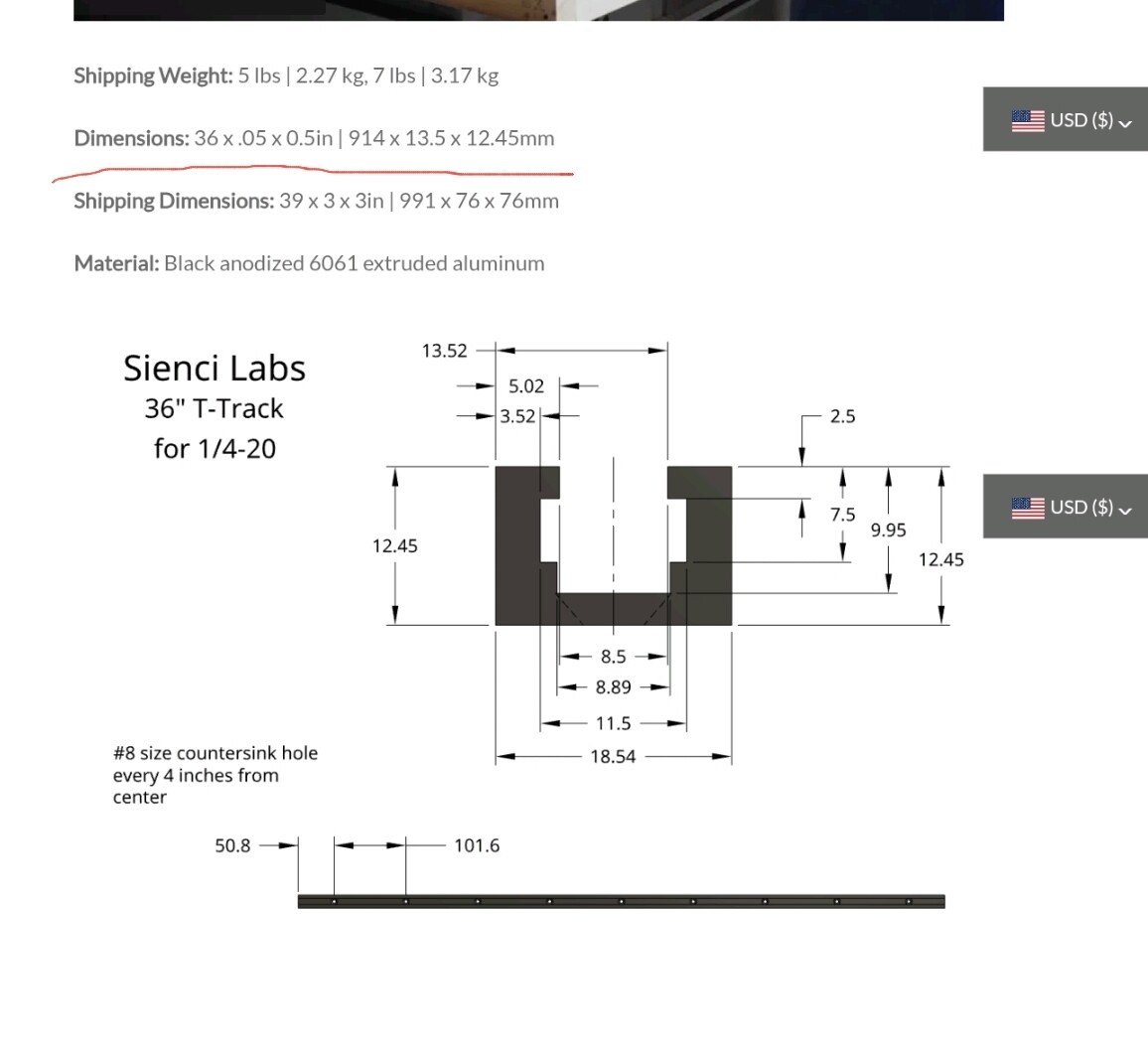

T track dimensions?
Sorry maybe I’m not seeing this correctly but in the store it mentions t track dimensions .500" x .500", but in the drawing its saying 18.54 MM ? roughly between 11/16" and 3/4" ? Which is it ? I’m still waiting on a delivery to confirm my table set up and wanted to verify the dimensions…

Hey Robert,
That looks like there sneaked a few typos into the dimensions text on that shop page.
@chrismakesstuff

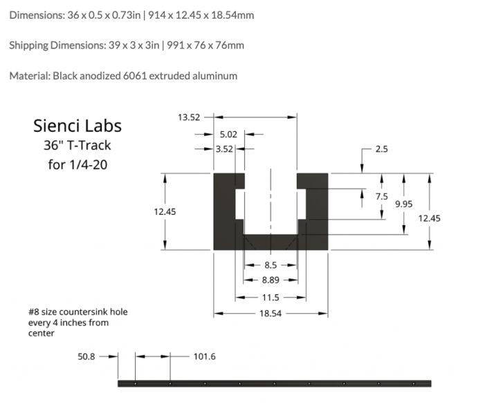

I think it’s safe to assume that the drawing is the lead and can be taken as gospel here. That illustration comes straight out of the cad data. (Found here)
Hey @Rowjr & @Spamming_Eddie,
Great eyes! We’ve corrected the typo on the store page, thanks for the assist!
