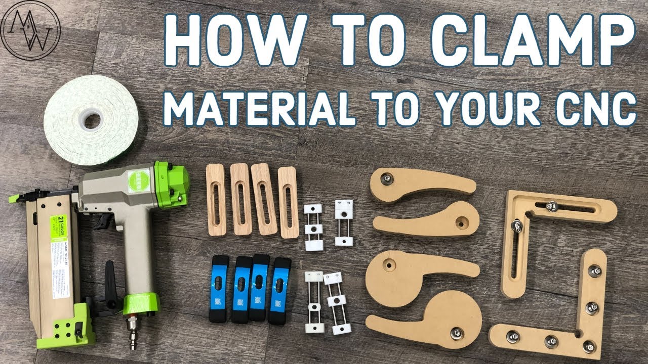

I too don’t use ca glue or tabe with my projects unless it’s realy thin and I need to prevent it to be sucked up bij the draft produced by the bit.
I have made my own clamps that are wood, they don’t leave any marks. You could make your own clamps, specific to your needs, that will not leave any marks. If you are use a lot of square edged material for your projects, you could opt to clamp using wedges.
I use good old hold down clamps for my more irregular jobs that have no straigt edges and need a propper flattening cycle. Can’t have hold down clamps in that situation.
If the project isn’t to large and I can fit it in a few clamps, I might opt to use this clamping methode too.
