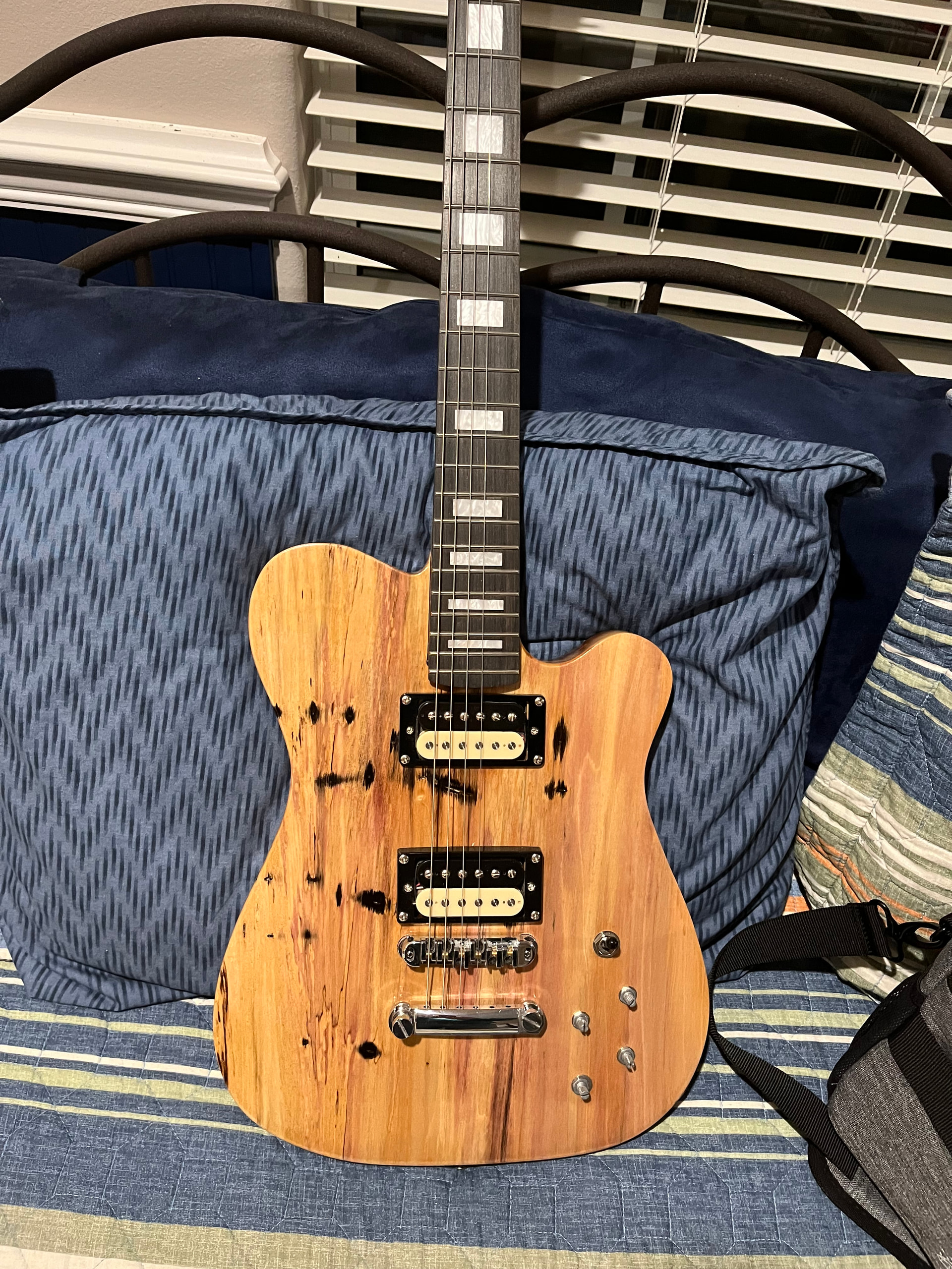

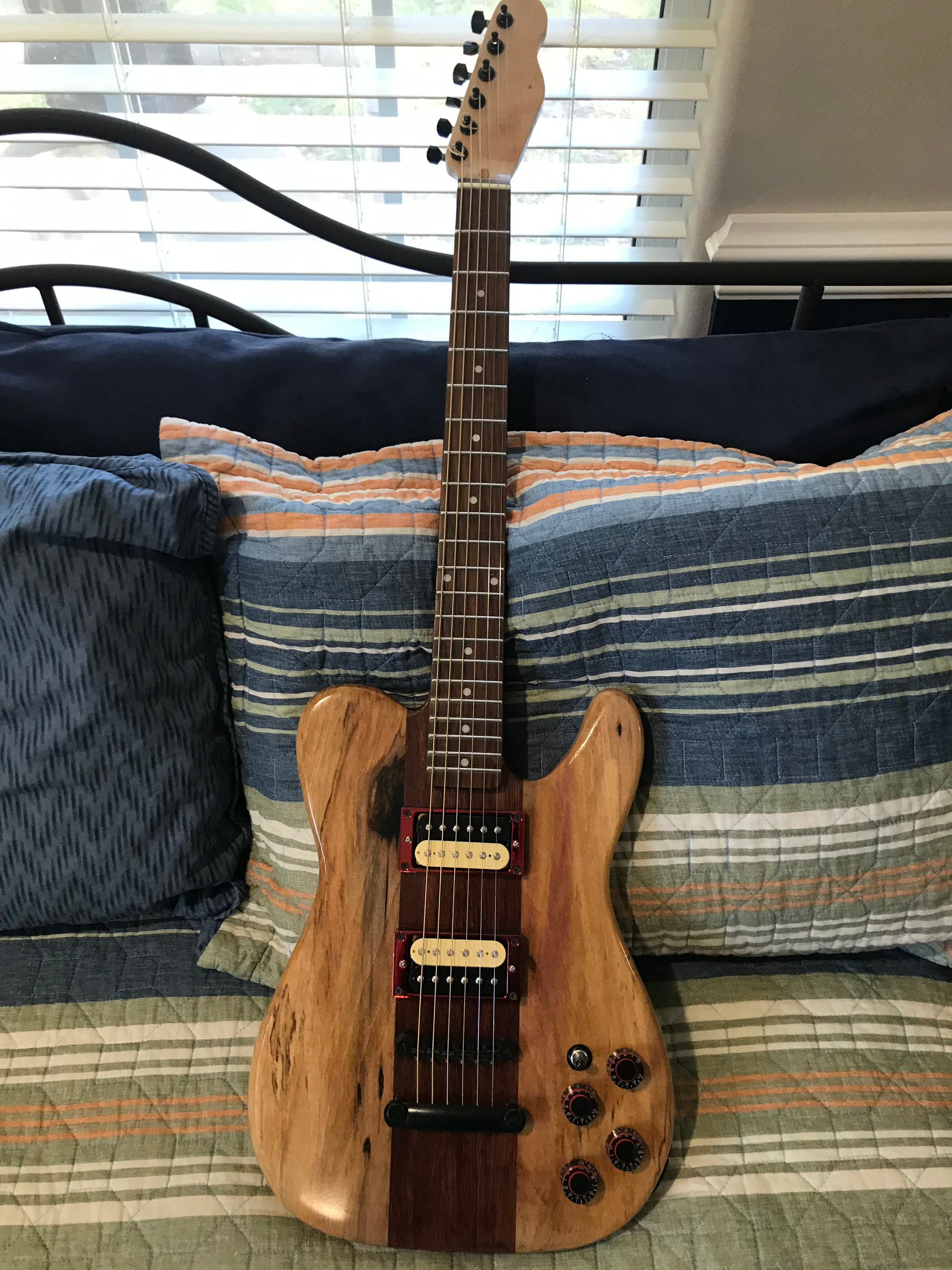

Yup! That is the plan! I’ve got this piece of swamp ash set aside to carve another version of the body depicted above (the purple heart bass).
Nice guitars by the way!!!
