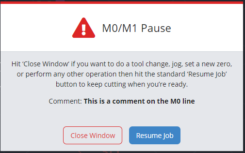

You should be able to do this using Pause strategy + a custom macro. PRB values are available as macro variables thanks to a pull request by @NeilFerreri
G38.2 Z50 F60
%PROBE_Z=params.PRB.z
([PROBE_Z])
([JSON.stringify(params.PRB)])
Ultimately it should be a bit more flexible compared to preset code blocks.
GRBL does not support parameters for M0 commands. This is a firmware issue, not a sender issue.
Line comments should already be appearing in the pause dialog.

Yes you are right, with the pause functionality you are more flexible but i see two drawbacks of this functionality.
  1. If you accidentally press the wrong macro you mess up your job
  2. Because i use the printing of the M6-command comment on the screen for telling me which tool i have to change i have to run a code before the tool change, to move to the tool change position and i need a code after the M6-command to perform the tool probing onto the tool sensor.
So if you do not want to support the pre defined code blocks anymore, would it be possible at least to define two fixed macros, which are run before and after the tool change command instead?

Just following up on this - code blocks will be reappearing in the next Edge release as an option for tool changing with them coming to Main again in the near future alongside the rest of the rotary work.
While the general feedback originally was that they didn’t work well for most tool changing workflows, them disappearing received a bit more of a backlash than expected. While we still think it’s possible to do the same thing with macros, we generally don’t see a reason to remove the option for those who don’t want to change their approach for whatever reason.
We’ll also be adding a pass-through option to not comment out M6 if people are using firmwares that are GRBL-adjacent and do support actual tool changes.
