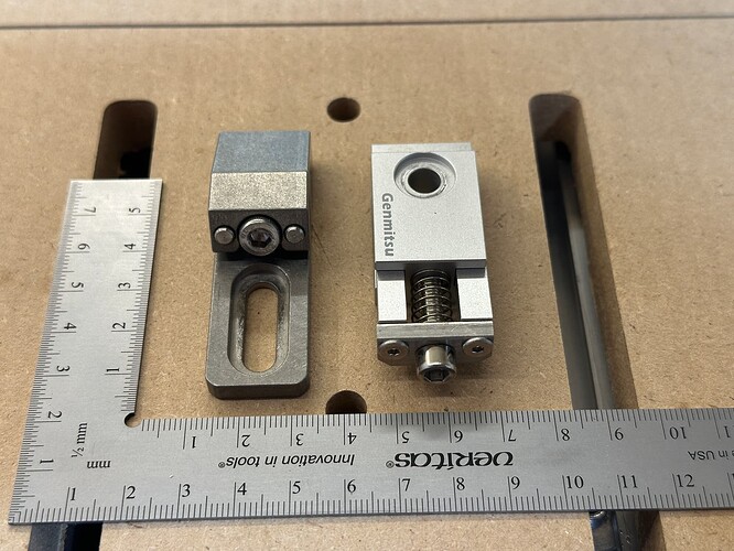

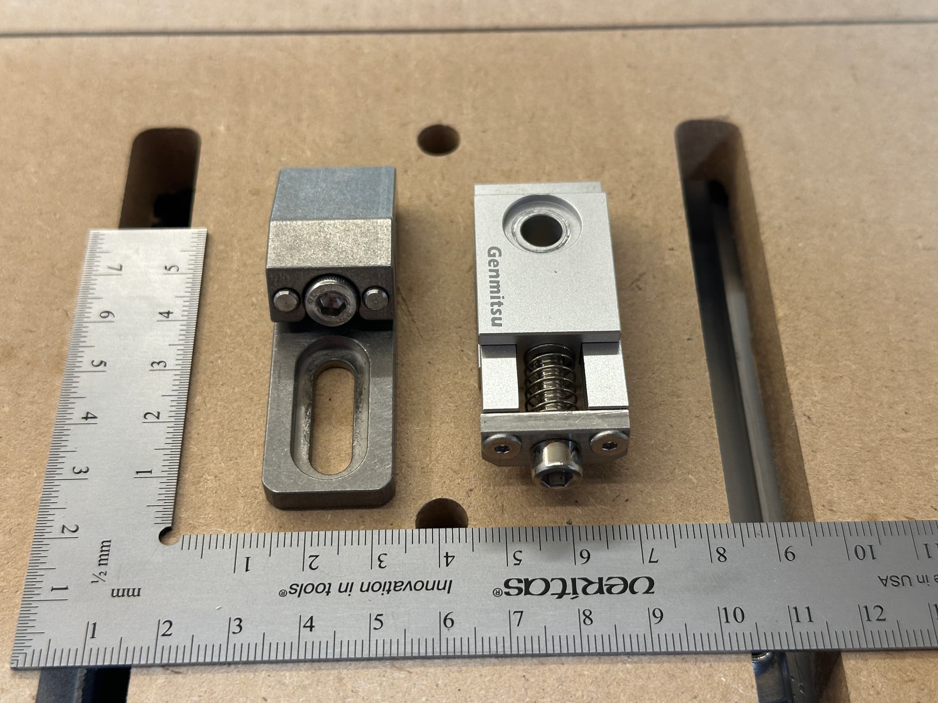

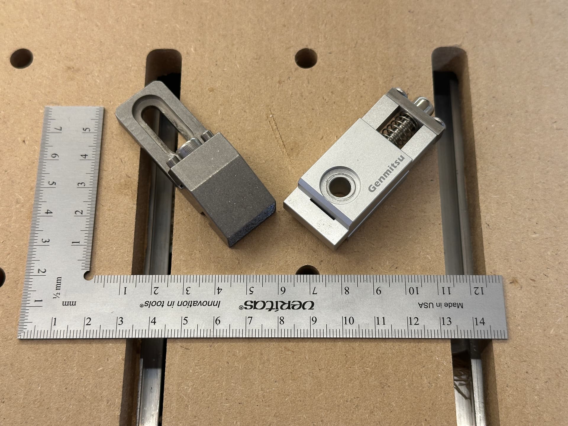

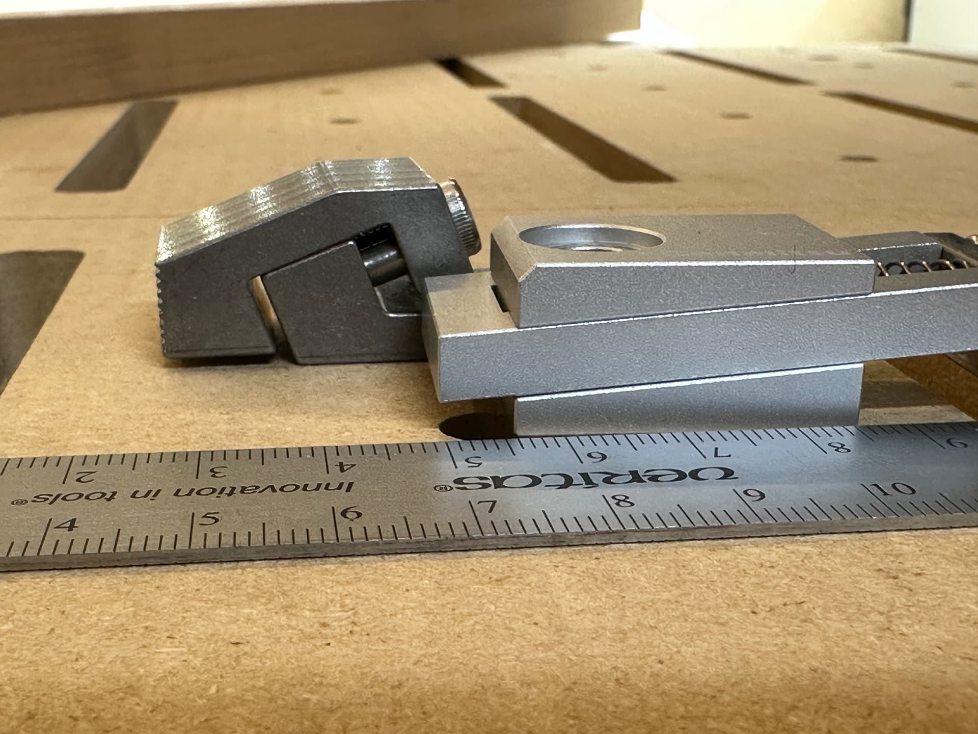

Photos for reference l.
strong text
Folks. I very much appreciate you sharing your expertise and wisdom (I have less than one year hobby experience). Seems to me that a possible solution would be to remove the wasteboards and make them a few mm narrower to be able to mount the toe-clamps directly onto the T-track, as designed . Will create a dust trap against the T-track, but that is what shop vac’s are for
