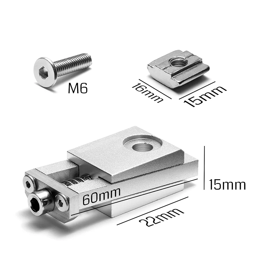

Sienci T-track width to hold bolt ā€œheadā€ is 11.3 mm. On Amazon: Genmitsu Upgrade Aluminum Mini Vise Toe Clamp 4PCs, High-Precision CNC Router Clamp for Woodworking & Metalworking Milling Project, Size 56 x 22 x 21mm, Low Profile. The ā€œheadā€ is 16mmx15mm, which is too large.

Update. Bought the Genmitsu toe clamps. They do not fit! In process of returning (thank you Amazon).
The T-track nut was the obvious issue, and happy to do some grinding, nut replacement, etc., however, the body of the clamp (no width dimensions published) does not fit onto the Sienci T-track - it is a bit too wide. Love the concept, but, need something which FITS! Advice welcome.
@Retiree Why does it matter if it’s wider than the track if it sits on top of it? Or is it because you don’t have enough space in between the spoilboard slots?
Precisely. I put my spoilboard slats tight up against the T-track. The Genmitsu clamps are about 2mm or so too wide to fit between the gap in the spoilboard slats and sit directly on top of the T-track as designed. If I try to raise the clamp onto the spoilboard surface and angle it a bit, the screw is too short and the ā€œtoeā€ contact is at an angle, of course. I could potentially grind the width down along the full length of the clamp, but decided too much hassle. To their credit, Genmitsu indicate compatibility with ā€œmostā€ CNC installations. I like the approach of using toe clamps. Anyone have suggestions for make/model, etc. which fit?

As I see the pic’s, and when I examined them, the clamps are designed for metal/metal contact. Makes sense to me.

I use the genmitsu clamps that are ahown above on my shapeoko pro table and they work for my use without resting on the aluminum track but rather on the spoilboard.

Like @spcnc says, the Genmitsu clamps would probably have been ok sitting on top of the spoil board. All you needed to do was use a longer machine screw.
Sienci T-track is .728 and therein lies the problem. As I see the pic’s, both Genmitsu and Carbide clamps are designed to sit fully on the T-track to provide maximum holding power. Yes, one can use longer fasteners and place the clamps on the spoilboard, but the holding power is then compromised. In my case, if on spoilboard, the Genmitsu clamps would have about 1mm of contact along each edge, and prone to slipping if not perfectly aligned. Not a high confidence level for me. Btw, Carbide indicated non-compatibility due to the t-nut being too large - just like the Genmitsu ones. I have asked Carbide to confirm exact width of their clamp. If it fits onto the .728 width of the Sienci T-track, I will buy a set and modify the fastening. They use M6 fasteners.
BTW, and for the record, a lot of people seem to cut their spoil board slats with the edges overlapping the T track. This would leave a slot about the same width of the T track opening which would help keep the T track down and fix your issue with your 1 mm of contact.
