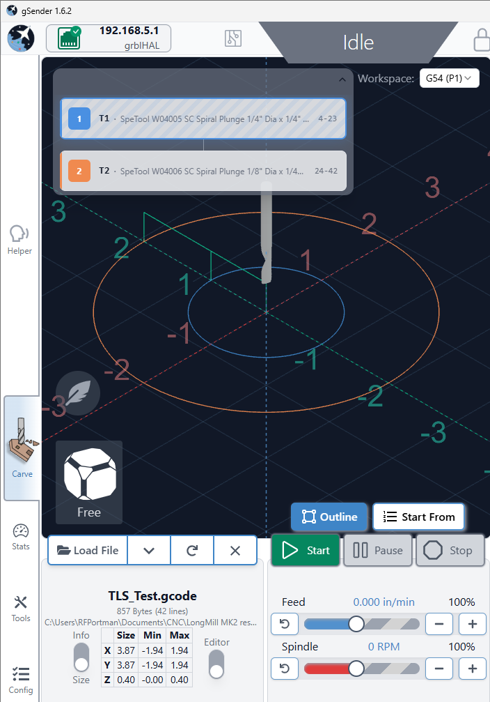

  4. Load File: toolpath.gcode. Pop-ups will appear showing you the tools used in this job.
  1. Press Start
  2. I select (Only Probe Tool Length).
  3. Press Run. The spindle will raise to the highest Z position (machine Z zero) and move over the TLS, then very slowly lower the bit to the touchplate.
  4. Press Next. Press Run (resume). Spindle will move to the XY Zero of the workpiece and begin the cut for T1. When done it will raise the spindle to the highest Z position.

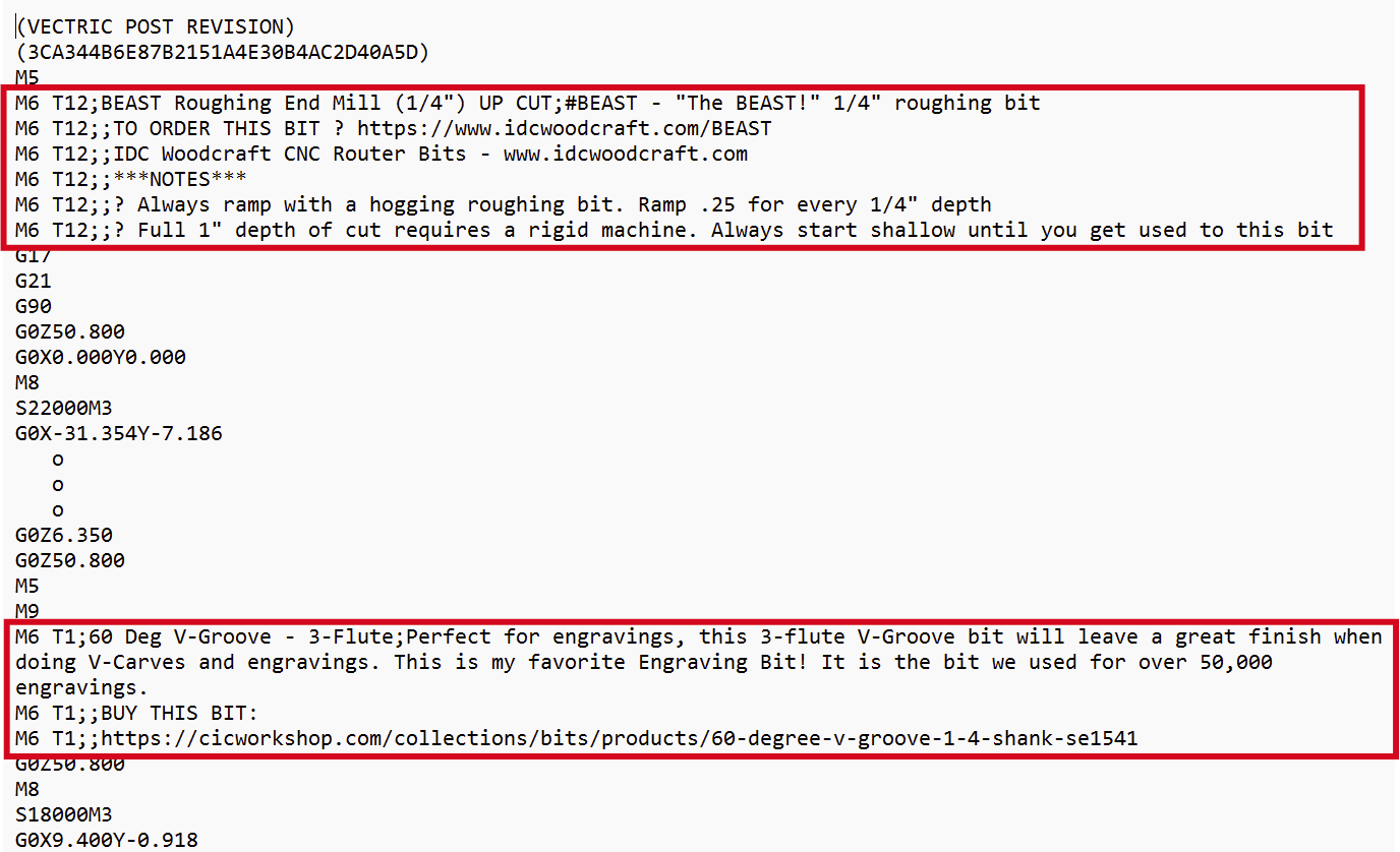

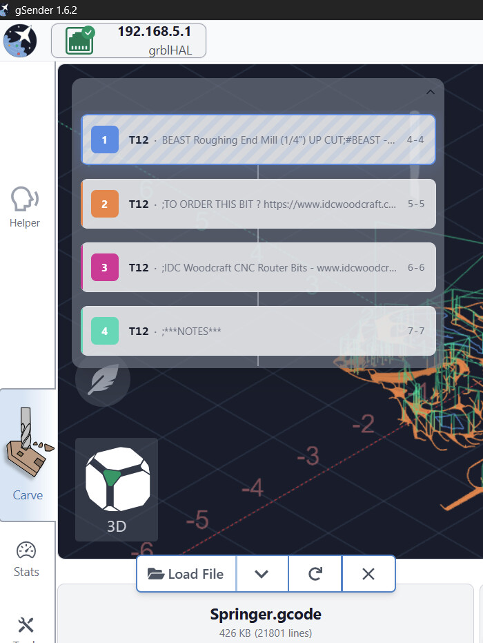

Thanks for the thorough response, Roland! I have completed these steps and after manually editing lines out of the .gcode file everything worked. Here is what I see in gSender and I can scroll down and see even more T12’s :

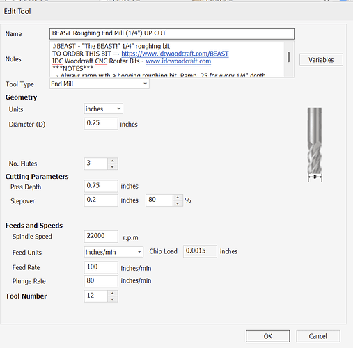

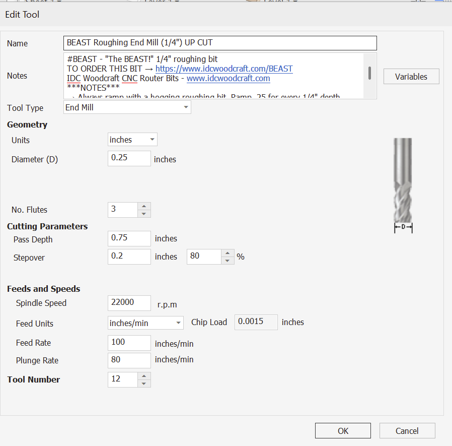

Duplicates of the same tool with the differences being what is in the Notes field of the tool in the Vectric tool database. Here is a screenshot of the tool database card, notice the Notes field.
Now here is a screenshot of snippets of the .gcode file generated by Vcarve.
The Sienci Labs ATC file seems to generate a separate tool for each line of the of the Notes field in the tool database. I can edit the .gcode file to take out the duplicate tools but shouldn’t have to do that.

Hey, this is a postprocessor bug. It’s been fixed on our internal version - we’re waiting on Vectric to update their side so the issue doesn’t happen
In the meantime, you can download and install the following version and I’m told it fixes the multiple toolchange commands by removing TOOL_NOTE output and just leaving TOOL_NAME - Vectric is looking into making it not insert multiple M6 in the meantime.
