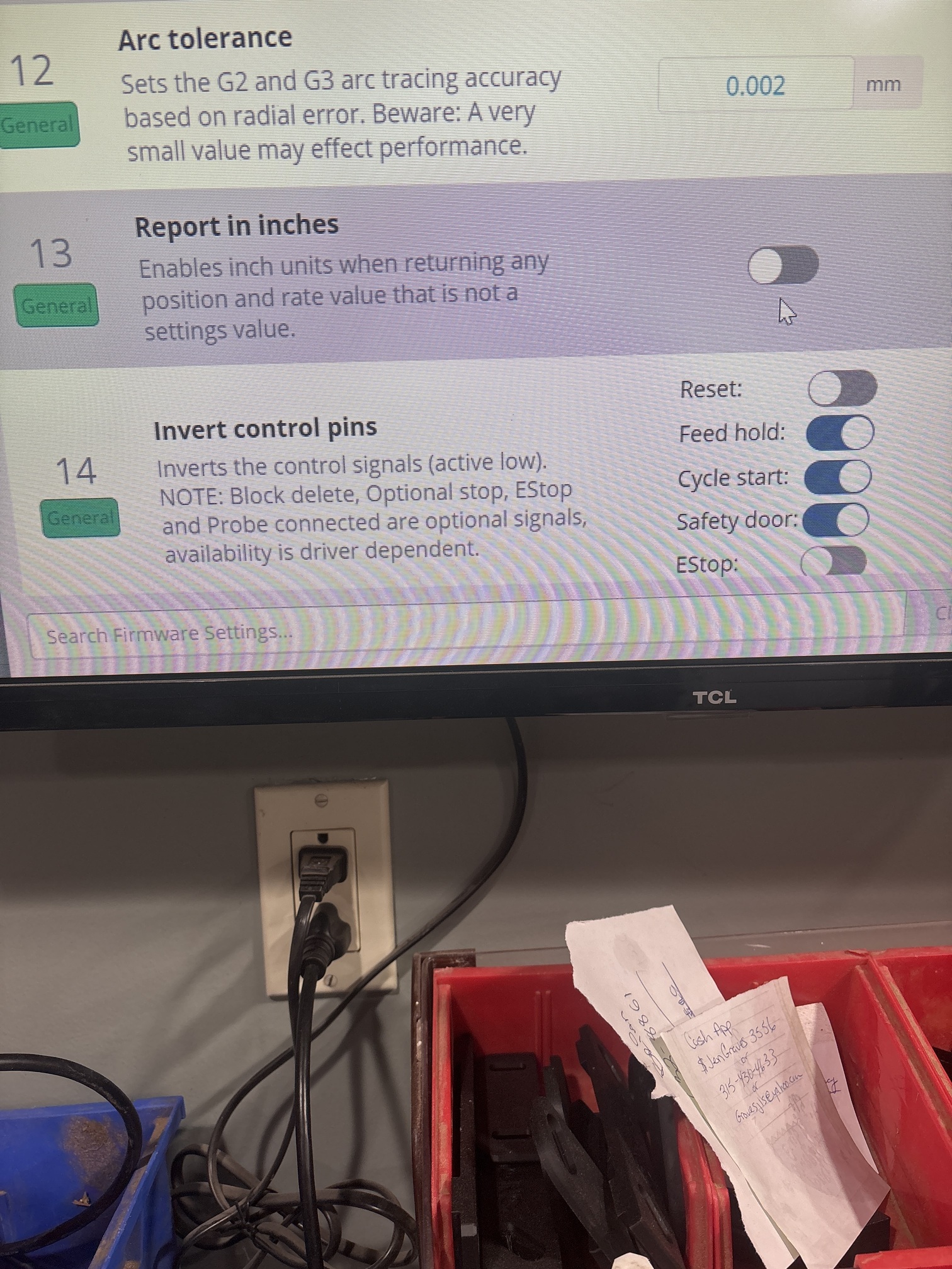

Not sure why I’m getting this alarm during Tls probing . It probes the initial tool after its first job then it calls for tool change , I change the tool and just as it finishes the probe sequence the z raises up , triggers hard limit alarm .
Fwiw I have soft limits turned off. [EDIT] fixed , 3rd pic shows $13 needs to be disabled .

Ok , so let me just give a brief idea of how the TLS is setup and that may make better sense .
I got Tls properly wired up and set in position on my wasteboard . In gsender , I select the “fixed tool probe option . Jog over it , selecting “ grab current location “
Now I home machine , load new file that calls for 3 bit changes . I have x0y0 already set , so I go to . Using the probe block as a first probing , set the magnet , probe for z0 per wizard . All set .
Start file runs perfectly . As it finishes the spindle goes over pause over the TLS , per wizard , I touch off the tool before changing to the 2nd bit , it proves then I change the bit , proves that bit on the Tls , then I press resume .
And this is where the z triggers a soft alarm . Soft alarm disabled it will then just trigger hard stop, and if I disable hard stops as well , it will raise as high as it can triggering the estop .
What I think is happening is grbl is trying to raise the z height using inches instead of mm . I do have inches set in the firmware , but that doesnt seem to matter ,
A work around I found is with $13 in the firmware disabled the tls works perfectly . The results are repeatable going back and forth over and over .

So does it seem then like your machine is moving up by 1 inch at the end of the tls routine and that’s causing the issue? If so then we can probably account for that
Chris,
Honestly I think it’s atleast an inch before triggering an alarm .
Not only that but if I were to press “ go to” z0 after the Tls probing , the bit would plunge past what should be z0 .I can visually see the value in z coordinate box by manually lowering to the wasteboard ( zero to stock bottom ) that it will go past the waste board .
