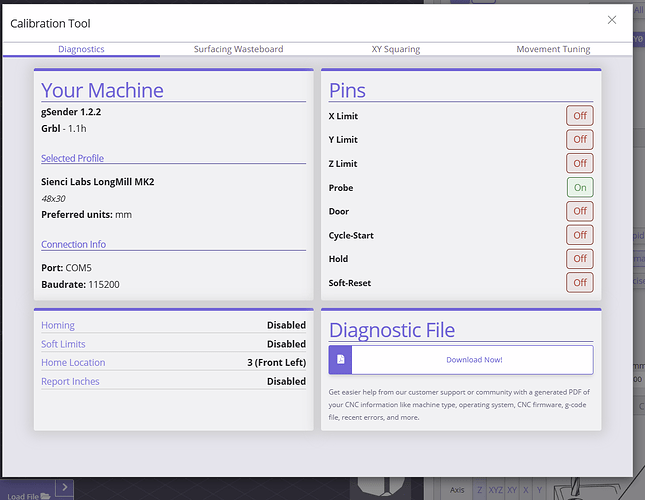

If you go to calibrate tab you have a list of probe and switch trigger display. You have a metal enclosure (auto touch probe) with known dimensions. If you jog the bit to one side untill probe gets triggered in calibration window. Zero the axis you use as measuring scale and jog untill you trigger the other side. Subtract the measured distance from the known dimension and you have your tool diameter.

I’m not quite clear what are you referring to with ‘If you go to calibrate tab you have a list of probe and switch trigger display.’
I understand your idea, but I don’t see any means to do it - calibration has surfacing, xy squaring and movement tuning, and I don’t see a way there to jog and see when touch plate was triggered

For me the pin list is directly in the diagnostics tab of the calibration tool.

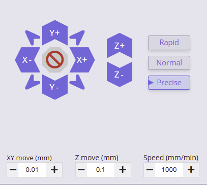

You can either jog via keyboard shortcuts set at the machine, use a joysticksomethinsomethin, or use a remote device, like a phone, tablet, or even a seperate pc in a remote location (like mine).
To start the tool measurement by hand, jog the tool towards one of the inner walls, have it lowered as deep as you can without it touching the slopes and jog untill you get a green light on the probe pin. retract one jog, reposition the block (it got moved oh so slightly) and decrease the xy jogging distance.
Creep up to the wall again untill you hit the green light again and zero your xy at that point.
Jog to the other side (prolly best to increase your step distance to speed up the process.) untill you are close. Decrease the xy step again and creep up untill you hit a green light again.
Subract the vallue you measure on the machine from 45mm (inner square) and you have a good indicator on how much your tool deviates from its specs.
