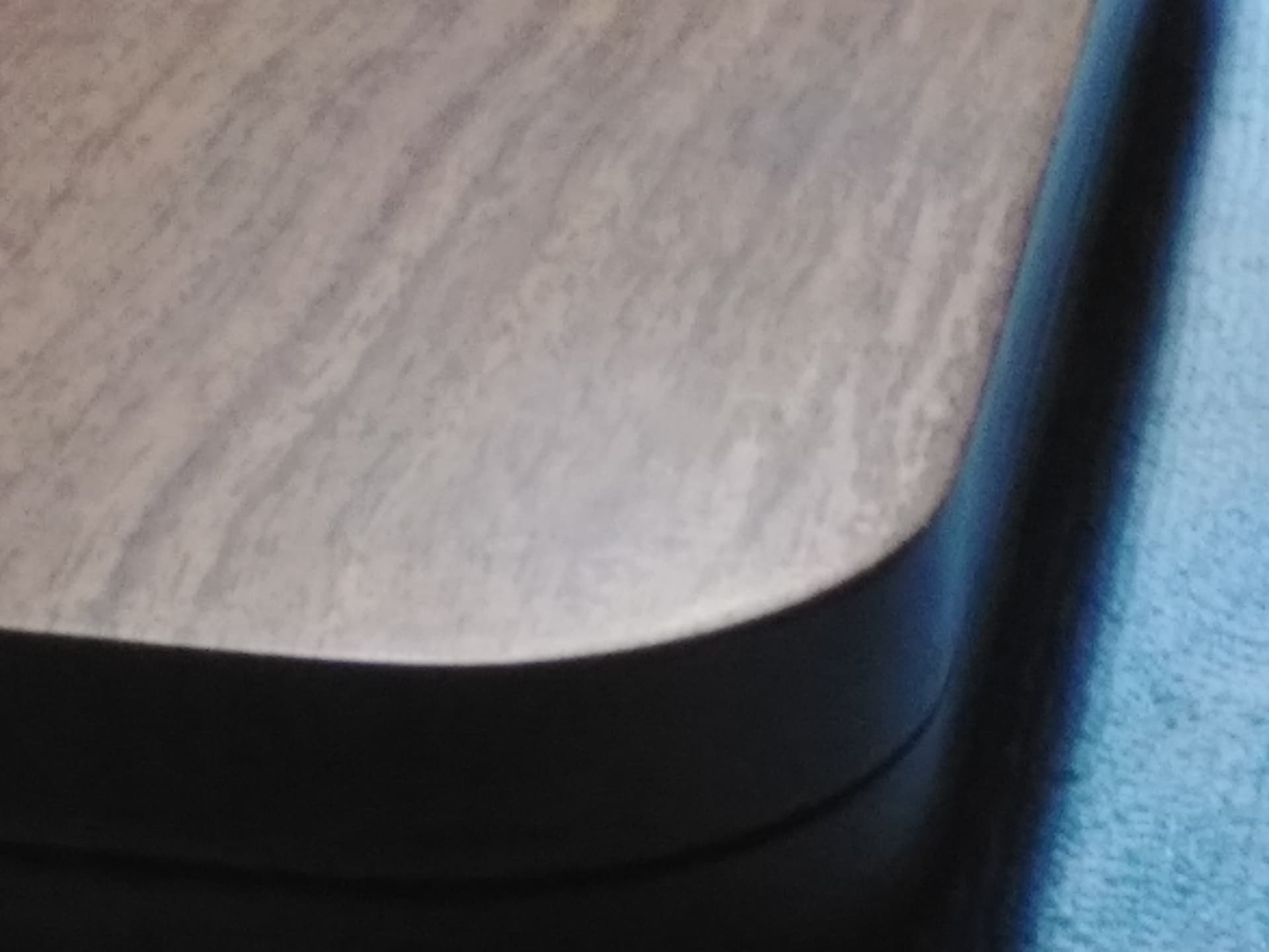

Itās hard to capture in a photo but there is some streaking visible in the finish at certain angles. I donāt think I was trying to be deceptive in the photoās but then again I am trying to sell it.
Man is it hard to capture but I think you can see it in this photo a bit on the right side just above the corner. It hasnāt sold yet and Iām not opposed to working on the finish some more if you have any pointers. It feels as smooth as a babies butt but I can still see itās not perfect.
I havenāt got much experience with trying to do a finish like this. I followed some instructions from YouTube. I am using a mix of 75% poly and 25% mineral spirits and wiping it on with a clean cloth. Then I sand lightly between coats and finish with sanding up to 3000 grit. Iāve also tried car wax and buffing but I canāt get rid of those streaks so far.
I am really satisfied with the laser work lining up and the inlay. I just think the finish is 90% there. I would appreciate any advice you have. I really do want my customers to be very satisfied with any purchase they make.
Ah, I see it. So, hereās my processā¦ I use this for guitar finishing and itās sublime. I havenāt done a cribbage board yet so Iām not completely sure how it will impact the holes, though, I suspect that splitting the process might be the needed.
Sand through probably 600. Anything more isnāt needed. I spray 3 coats of grain sealer. I like Solarez because it UV cures in 5 minutes. Then level sand. Now, if i were finding the holes being filled up, i would probably change my CAM strategy to stop and drill my holes now i stead of before starting the finishā¦ thatās the split process I referenced earlier.
Anyway, after level sanding, 3 coats of Solarez UV lacquer and level sand through 3000 and then I hit the buffing wheel with cutting compound and then finishing compound.
Should look like glass.

The biggest key to a super glassy finish is the grain filler coats and that first level sanding. A really cheap $16, 16" Amazon fret leveller is dead flat and will accept any self adhesive roll paper. Great for long, flat areas. Use a big pink pencil eraser for the sides. BARELY touch the corners because the sand through fast.
Watch a little bit of YouTube regarding guitar finishing. Itāll really give you the idea. Donāt wet sandā¦ not beneficial if you use good paper.
