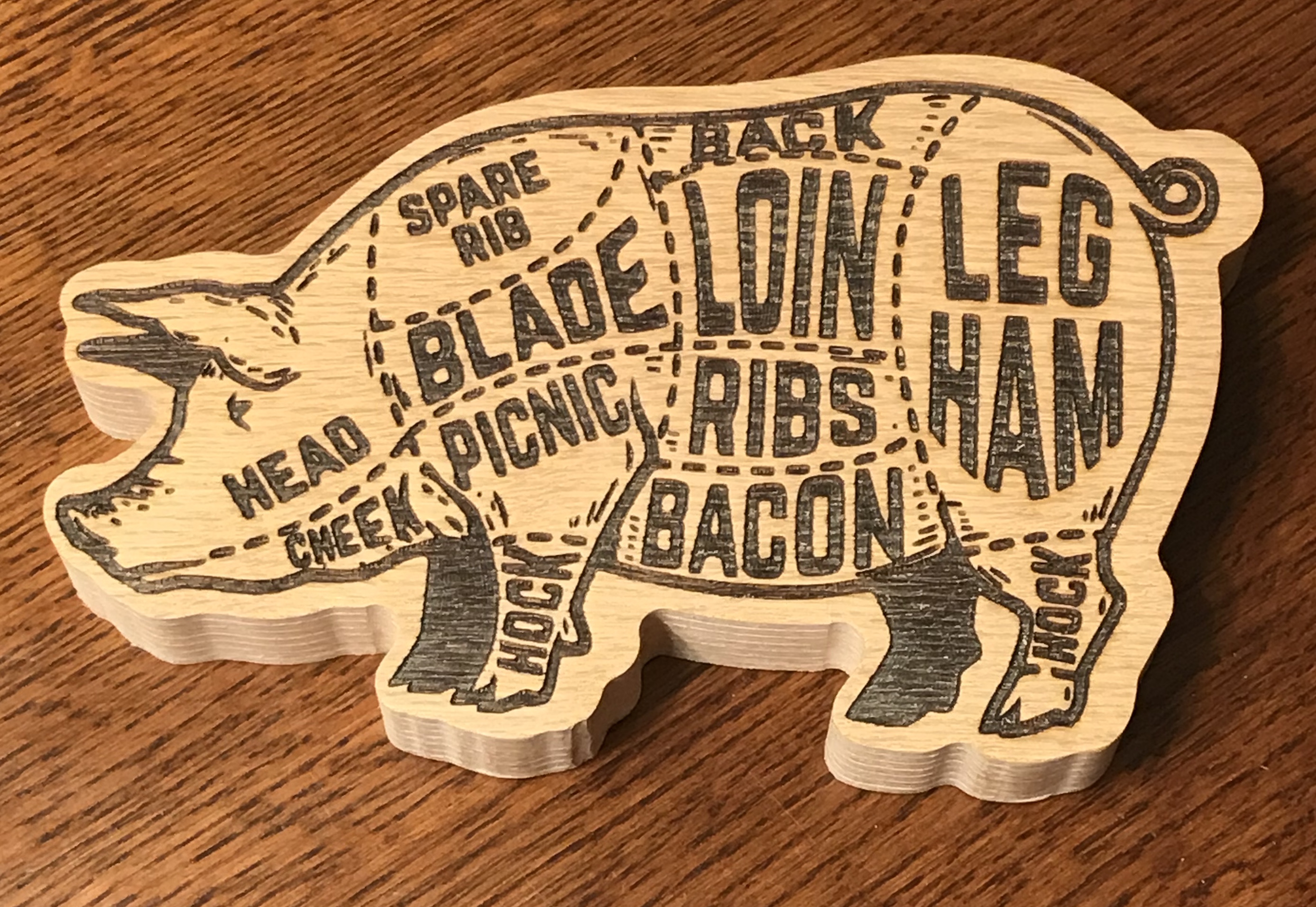

@Heyward43, @gwilki, I checked out the Jtech post processor (newest No Z version - GRBL mm) and it actually works pretty well. There have some things in Vcarve that you have to set differently between routing and lasering so that complicates things a bit. I ended up saving a separate .crv file of the project for the Laser portion and the CRC portion to keep things straight. They are basically the same except for those settings that are different. You probably don’t have to, but it helps me keep things straight.
Here’s my first effort, a very small cutting board. It’s only about 6 1/2" long and still needs some finish. I used the laser first and then cut it out. The whole thing was done with Vectric Desktop.
@paullarson I love it, Paul. Well done!
Paullarson - that is really cool. Somehow I just knew you would check it out before anyone else. I really like that. If I can just get my laser hooked up maybe I’ll get to try something like that. Thanks for posting that.
