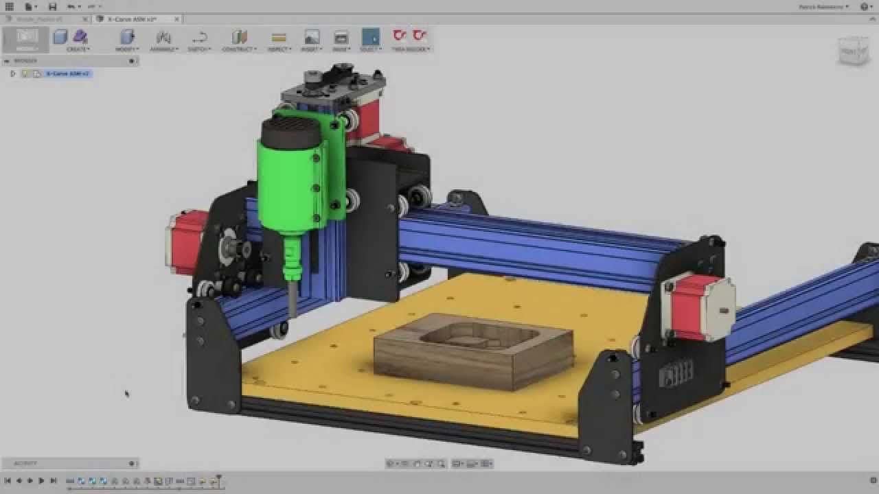

I am seeing an unexpected movement when I start a NC program. I’m generating my G-code using Fusion. When I start a program, the machines moves to some “new position” and then prompts me whether I want to continue. I think it’s prompting me to do a tool change, if I need to. The issue is, I can’ predict where the machine will move to. Most of the time it goes up, and away, which is OK, but sometimes it plunges into my stock or my wasteboard, which is not OK.
When this starts happening, I pretty much have to power cycle my LongBoard. It’s like the place it’s going to move to is selected at startup, because if I don’t power cycle, it goes to the same bad place as the previous try.
What am I doing wrong?

**To avoid potential issues with Fusion 360, we also recommend you make the following checks to your post-processor:
  • G28 Safe Retracts set as “Clearance Height”
  • Output M6 set as “No”
  • Output Tool Number set as “No”

I suspect that is why Sienci suggests to use “Clearance Height” instead of G28 with fusion’s grbl post.
I wonder if my issue was about Safe Retracts … I have set it to clearance height and will see if my issue re-occurs. Thanks for your advice.
My issue definitely was needing Safe Retracts. It’s annoying to do so because a warning comes up in Fusion when you do so. The nicest answer is to use limit switches, and then G28 works as expected.
Thanks to all who advised.
