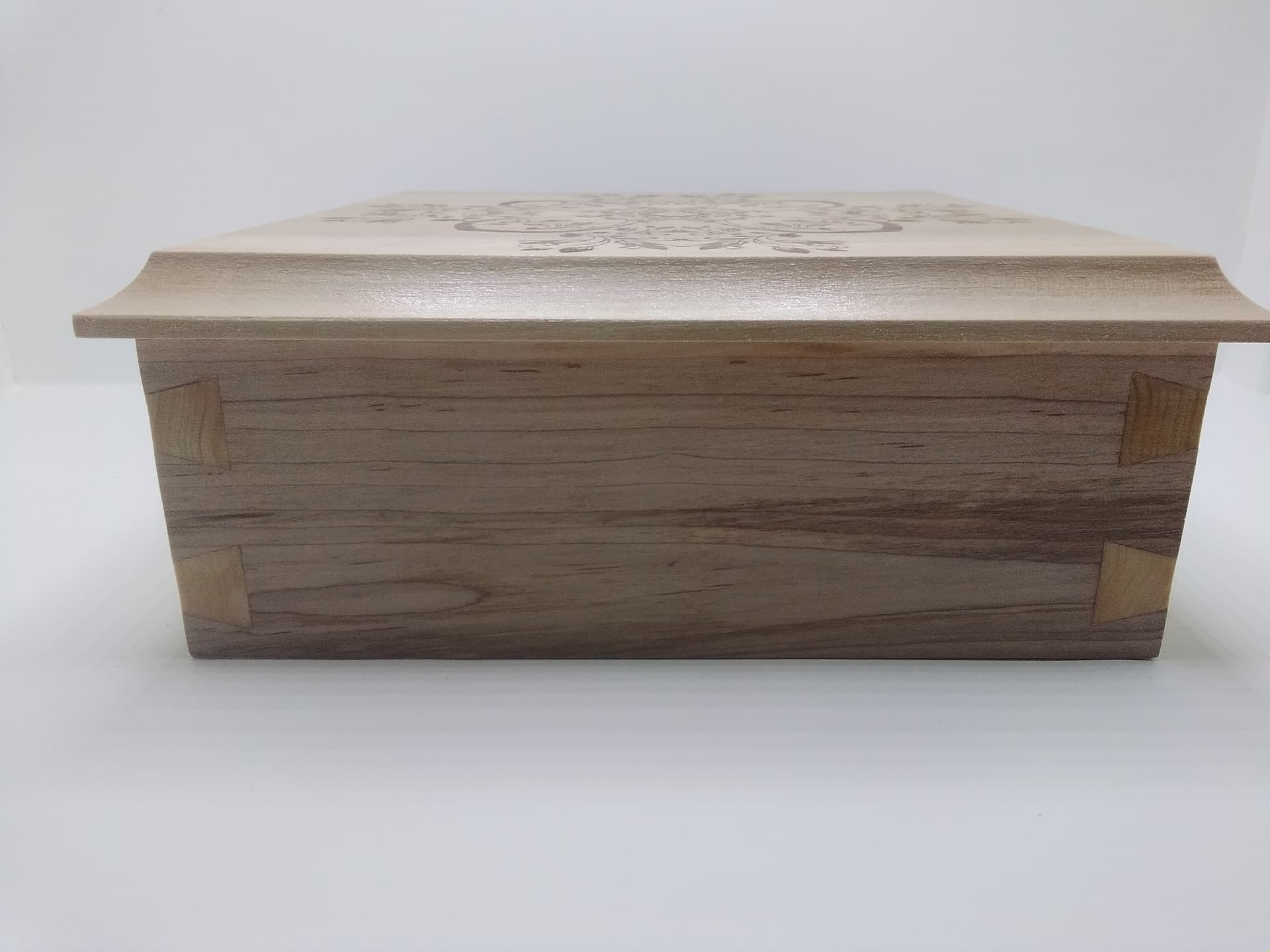

Not sure what software you have but I have some experience doing dovetails on my LongMill with VCarve Desktop (no dovetail support) with my vertical clamping system.
Front of the box
Side of the box
Not sure what kind of machine setup or software you use but I’m willing to share how I do them if wanted/needed.
