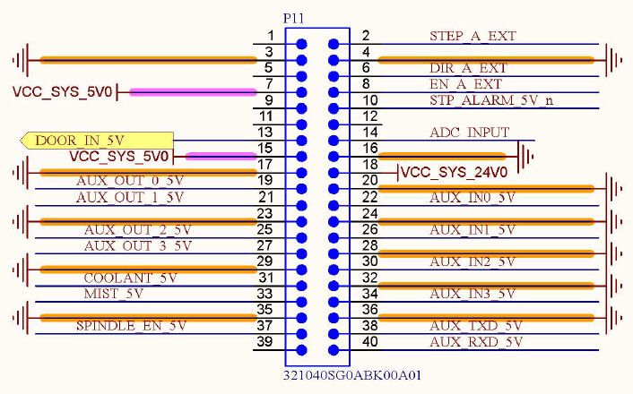

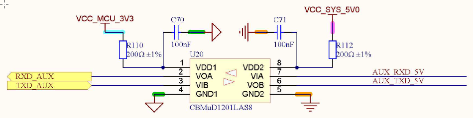

Hey. I am looking into possibilities for connecting a Pibot pendant to the SLB using pins 38 and 40 on the GPIO header. Has anyone looked into this to use with gSender? It has WiFi capability, but I’m not sure if it will connect to gSender. Still waiting for pendant to arrive, then I can start doing some tests.

So, just as an update, I received my Pibot pendant and have been trying to get it to work. Unfortunately, the ncSender pendant firmware does not seem to work. It doesn’t recognize when the pendant is connected via USB, so I can’t activate the pendant. I have reached out to Francis, but his Pibot was having issues and so there is no solution to the issue yet. Not sure if there will be
