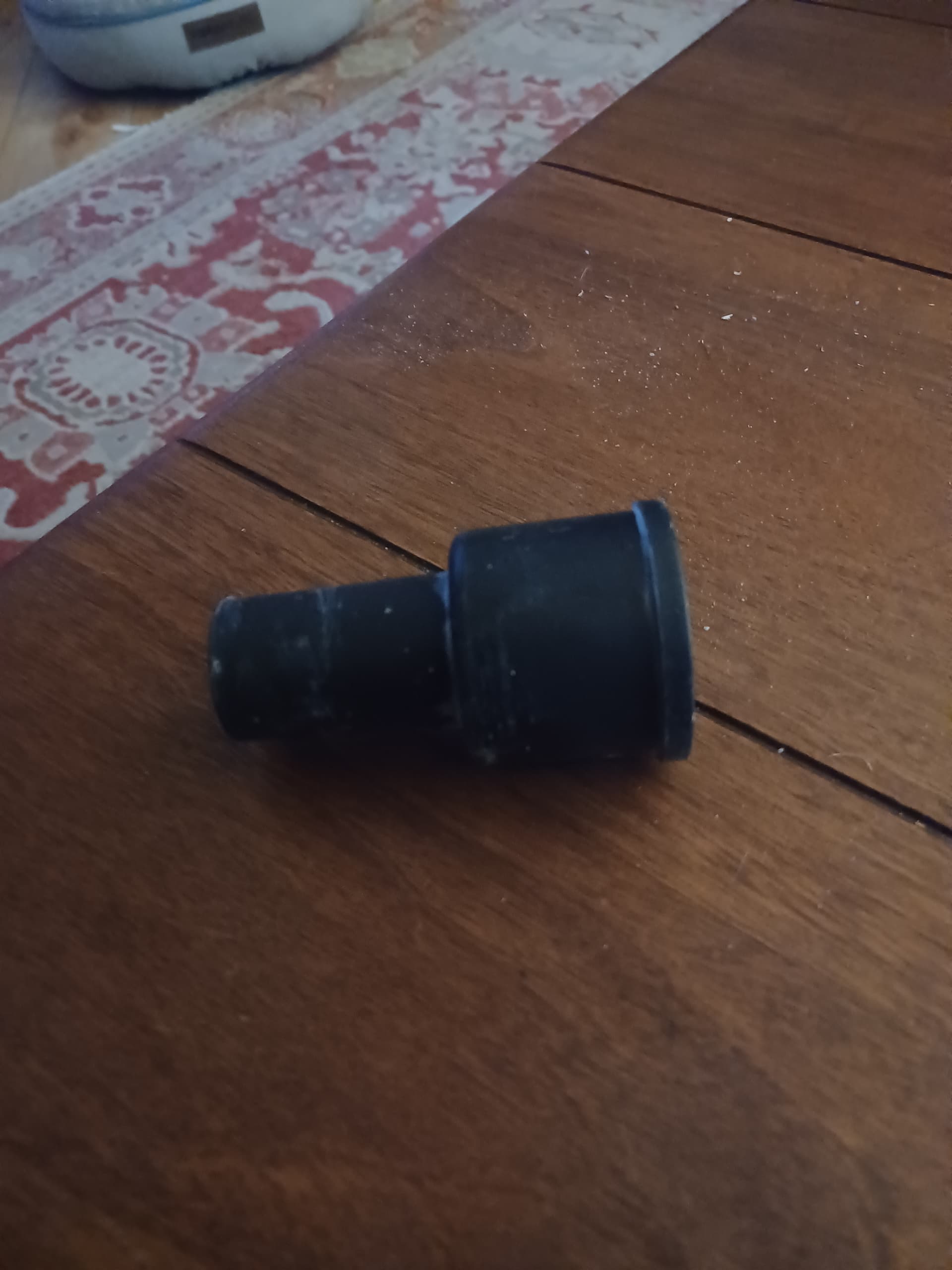

I have a question for you sir,
What size hose did you use for your Sienci dust port? I can’t seem to find one that fits.

I had a reducer to go from the 2" main hose down to 1 1/8" or even 1" to fit into the brush bracket. I know it’s not perfect but neither are the expensive alternatives. Once i removed some of the internal ridges, that improved the vertical adjustment. So when I put in a bit I look at the task, I adjust the height accordingly. If i’m doing a profile cut through the material I start out with the brush a half the material thickness above the bit. A V Carve i set the brush about even with the bit tip. The brush doesn’t touch at the start of the carve but the suction is so strong it srill works well
Thank you, I’ll try that and hope for the best.
@Parkey I bought a bag full adapters like the one pictured just happened, maybe harbor frieght.
