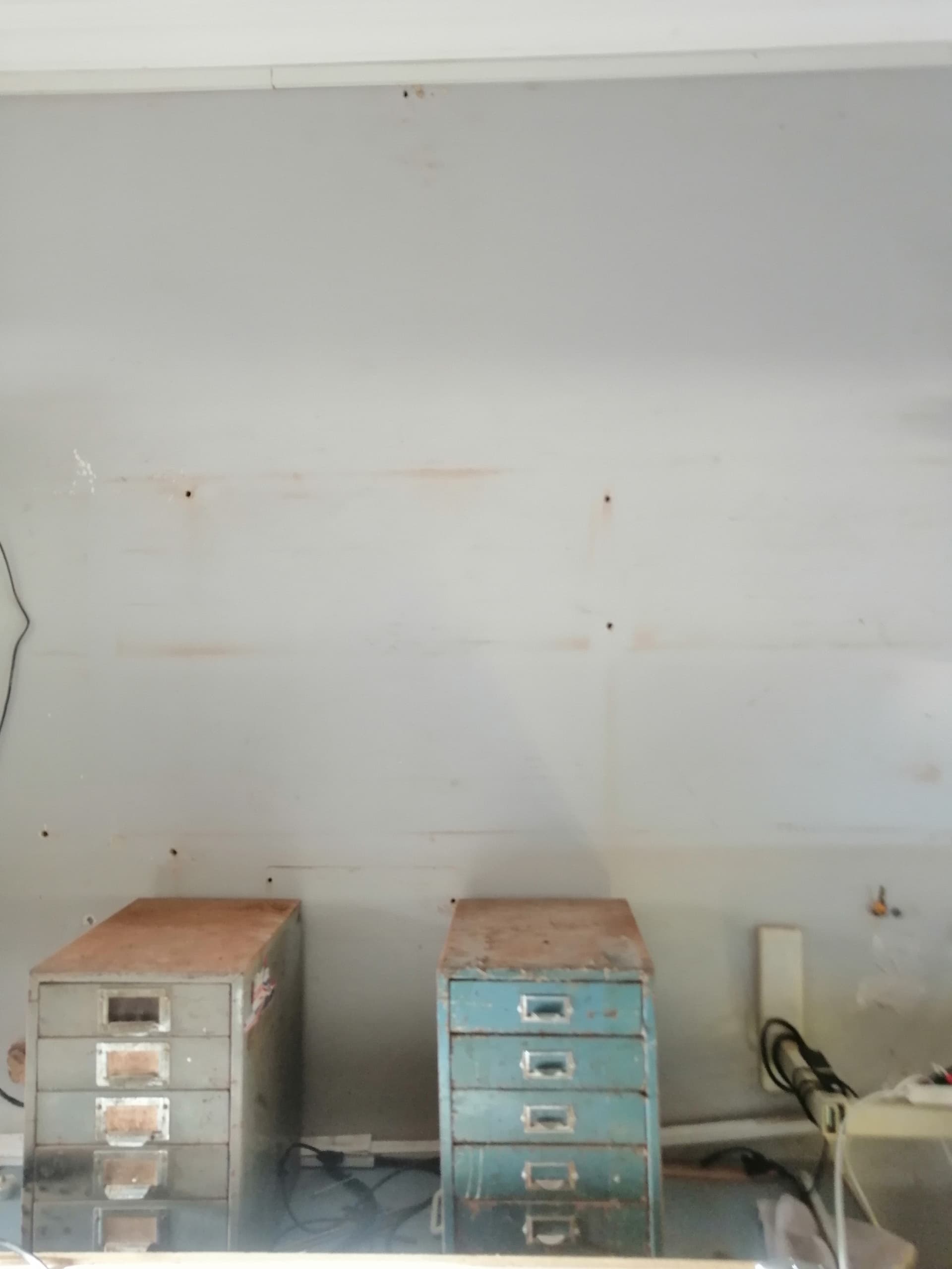

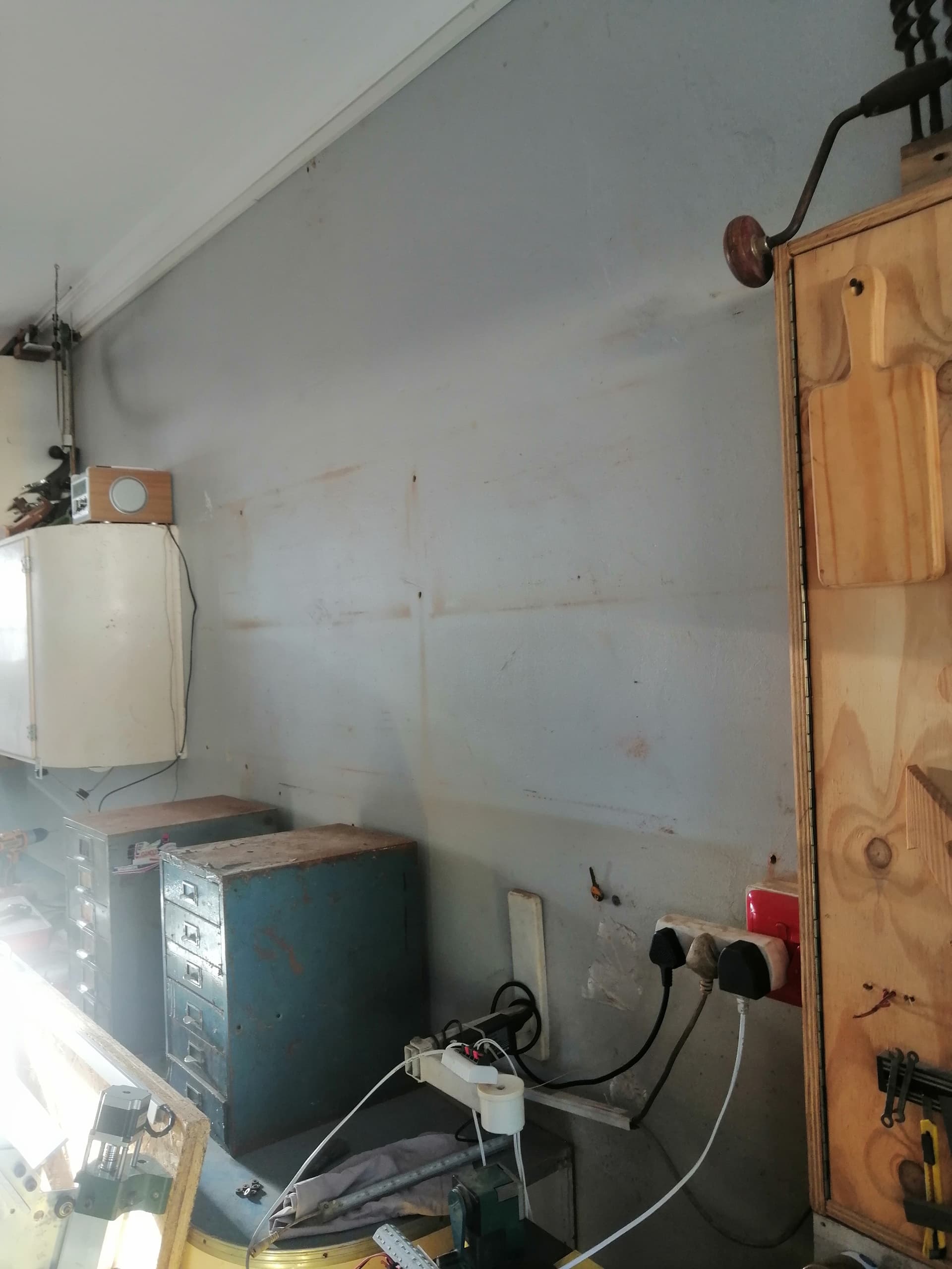

What would happen if you made the machine vertical instead of horizontally the chips would then fall to the bottom of the mc and could be sucked away It is what I have been thinking of doing as my shop is the size of a one-car garage and already to little space
If you can set up your CNC and have it work well I don’t know why it would not work.
Definitely going to try it,
this is the space I have

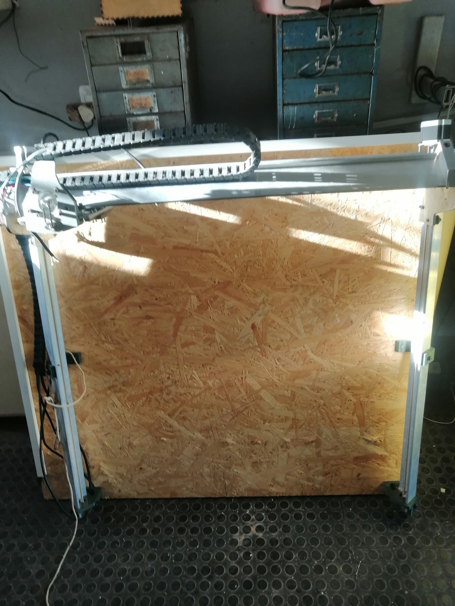

My Longmill build so far
Going to use the small cabinets as extra hands
The only thing I can think of is that the y-axis in the upward movement is slower due to the weight of the support arm with the router.
@GeorgeV You can search on this forum and on the Sienci Youtube page and read about LM users who have done this. Some have added springs, some have added counterweights. Pretty much all of them have set $1=255 so that the motors stayed energized all the time to prevent the X gantry from slowly falling.
I now believe that almost anything is possible. :grin:
Thank you I will definitely set the $1= 255 in the firmware
@Neville You’re welcome. Be sure to keep on eye on the motor temperature. They will run warmer since you are keeping them powered up all the time.
It has been done and works. I’ve seen YTs with vertical mounted Longmills. They claimed they could detect no change in accuracy. {Don’t have any links to share though}
