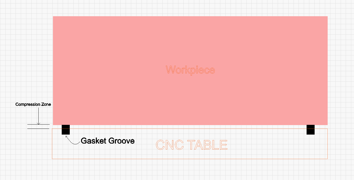

For vacuum workholding you typically have a surface that is flat that lies below the full compression of the vacuum gasket that is your reference surface. You use Z0=bottom in your CAM.
Thank you for your reply
. but I don’t understand what you are trying to say.
In your example above, I would zero to the top of the CNC table under the assumption that the gasket compresses enough to allow the work piece to sit flat/directly on the CNC table. I have no issue with that.
Have a look at the link I provided. The gasket in question is not a gasket strip around the perimeter but rather it is a ‘sheet’ gasket that covers the entire CNC table. My thinking is that I can’t zero to the top of that gasket nor can I zero to the top of the CNC table (under the gasket).

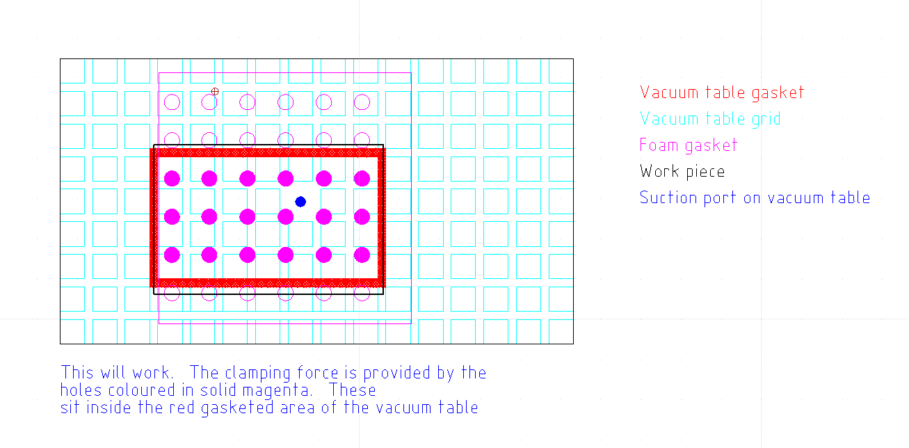

The foam gasket allows you to cut through your material without losing suction. But you would need to cut outside of the vacuum table gaskets (in red) for that to be possible.
I’m guessing you could replicate the foam gasket with a thin gasket materiel glued to 1/8" or 1/4" hardboard. on which you punch a bunch of holes. You can probably do that with the CNC. Maybe a sheet of EPDM rubber would work?

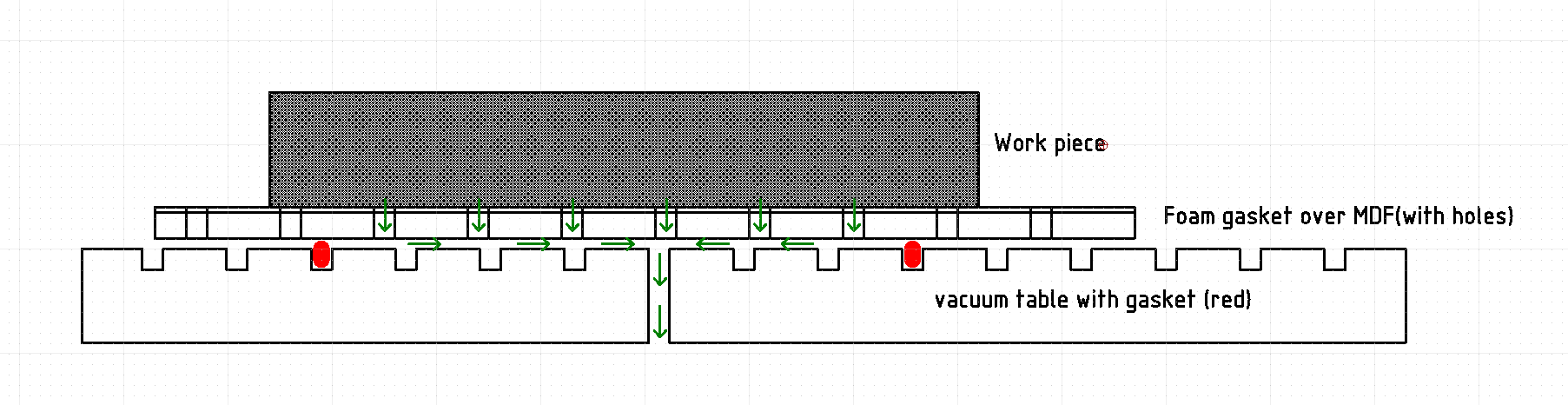

This is incorrect. All vacuum hold down systems work by creating a vacuum, not by moving a lot of air. If there’s a leak, the system won’t work. Whatever workpiece you put on, it has to cover all the gaskets to make a seal. And once the seal is made and you have a good vacuum, there will be no more air movement, except perhaps to compensate for vary small leaks.
In the drawing above, if you remove the “foam gasket”, your work piece still covers the vacuum table’s gaskets on all four sides. There should not be any any leak.

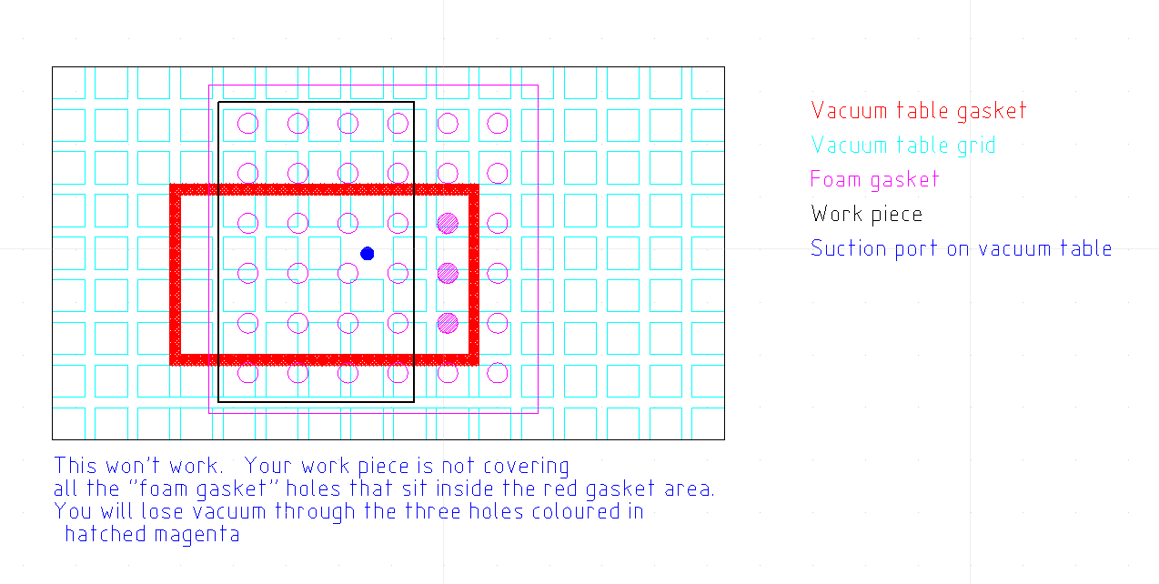

If you add the “foam gasket” (which is just a 1/16" piece of foam rubber glued to 1/4" hardboard or similar, with a bunch of 1/4" holes), you just need to make sure your work piece covers all the 1/4" holes that sit inside the red gasket area.
The advantage of using the “foam gasket” is that if you cut through your work piece outside of the red gasket area, you will still get a clamping force AND you will not damage your vacuum table. You may damage your foam gasket though.
The disadvantage of the “foam gasket”, is that the clamping force will be dictated by the area of those 1/4" holes inside the red gasket . Without the foam gasket, the clamping force is the entire area inside the red gasket.

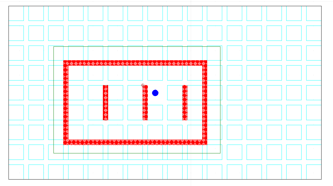

You could put little pieces of gasket in the grooves on the inside. Just little pieces that don’t form a closed area.

Doing this would prevent the vacuum from sucking down the center of the workpiece if there weren’t already islands there to prevent exactly that from happening. The pieces will do nothing to prevent the AirWeight pods from lifting up rather than the sheet goods getting pulled down and straightened out.
Maybe we are talking about different products. I was assuming you were referring to the “tile gaskets” from AirWeights . These are not a permeable MDF but rather a 1/16" thick impervious foam gasket glued to a 1/4" MDF substrate. The whole thing is then perforated like a peg board.
