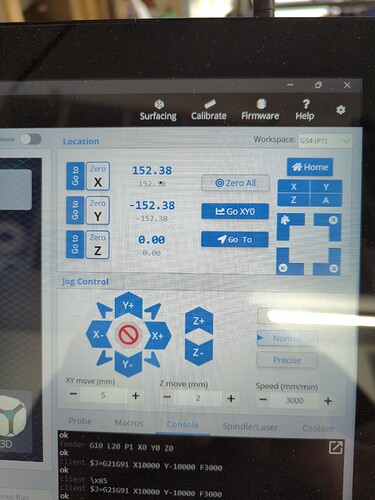

I’m getting negative numbers on the y axis as it moves away from the home location. When I jog x away from home it’s positive numbers. I can’t surface with negative numbers. Any thoughts on how to fix this?

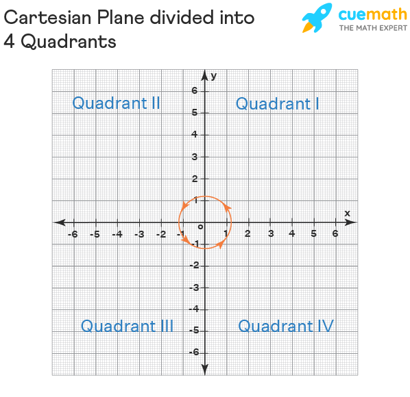

I’m no expert but I believe you can alter this in a couple of ways but the first one is where you Home/Zero it to begin with since it works in quadrants.
If you move it to the front left corner and Zero out your X and &, then all movements will be in the positive direction (Quadrant I). Otherwise you run into other Quadrants which are represented with respective negative numbers.
