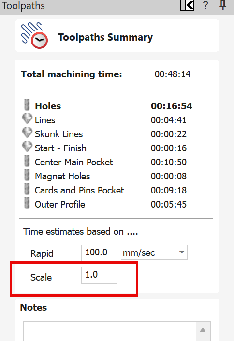

@Retiree You can set a factor in VCarve to account for the discrepancy. It’s not great, either, but, depending on the project, it will get you close.
Interested in learning more. What factor? how to set? Many thanks
It’s called ā€˜Scale’ in VCarve Pro and it’s located on the Toolpaths Summary screen:

@Retiree Be sure to set your rapid rate to the rate you have set in your firmware settings. Otherwise, the estimate will be off.

@Retiree You say that you set the scale ā€œas indicatedā€. What did you set it to? Leaving aside gSender, if Vectric estimated 2:18 and the actual was 3:15, you need to adjust the scaling factor.
Or, you can adjust the rapid rate figure to match what you have it set to in your firmware.
In Vectric, Toolpath Summ, I set speed at 120 ipm and it estimated 2:18. I note that the clock in gS as the job runs is definitely not standard time. The relative time in gS (% complete vs estimated time) is fine, however, it is not actual time. I have no problem with adjusting the scaling factor, but, based on what? and why should not the clocks be pretty close?
@Retiree You set the scaling factor based on the difference between what Vectric estimates and the actual run time. The issue with this is that it will not be the same for all types of toolpaths. Vectric does not know your rapid movement rate or your acceleration. So, for pocketing and profile cuts, you may set one factor. For 3D modelling toolpaths, which generally include a lot of Z moves and speed ups and slow downs, the factor will be much different. Only experience will allow you to set values that may come close to the actual run times.
The speed that you set in your toolpath includes two values, XY and plunge Z. Vectric knows those values. It does not know your rapid rate. If you choose to use that in the time estimate, the max XY rapid rate for a LM 2.5 is 4000 mm/min or 157 inches/min. These are the defaults. If you have changed them, you would enter the value that you set.

Thanks for info. You are correct in that the time discrepancy was for a 3D Finish toolpath (how do you know this stuff? - amazing!). So, I played around with the S/W, and if I change the Scale factor to 1.45 for my particular job, the estimated time is within 5% of the actual for that toolpath. If I understand your comment, the complexity of the model (as defined by Z-travel) seems to be the defining factor for setting Scaling Factor.
